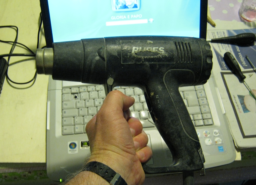

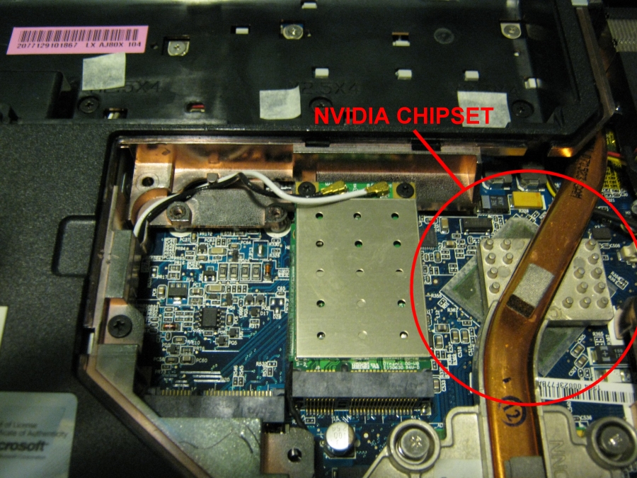

    After a long time I had nothing interesting to repair, four days ago a neighbour brought me an Acer Aspire 5520 completely dead, nothing happened pushing the power button.
    So I have disassembled completely the notebook and with an hot air gun, I have warmed up the board slowly, than I have heat only the Nvidia chipset at around 220°C for about 30 seconds and than I left the board to cool down.
    The result is that the PC is repaired.
    Here two pics, one with the chipset highlighted and one with the hot air gun I have used and in the background the working notebook.
    Ciao
    Gianni

      Unfortunately, it won't last. This is a common problem and if you want long term results you need to remove the chip and exchange the solder spheres.

        If it was completely dead and showed no life before disassembly, what lead you to heating up the Nvidia chipset?

          @ ablacon64: I know this is not a professional way to solve the problem... but the choice was between spending more than 300Euro for a new MOBO and to sell it on Ebay.
          As my neighbour didn't want to spend 300Euro, I told him that I could try to fix it and if didn't succeed he could sell the notebook on Ebay.
          Well now let's see how long the notebook works.
          @ artois7: I'm not a genius or a clairvoyant, before doing anything on this notebook I searched on internet and I found an Italian forum about acer + nvidia problem. Also on badcaps there are a lot of post about re-flowing or re-balling faulty chipset.
          To be honest I read the almost all notebook try to boot in and endless loop while this one was completely dead, not even a short led blink.
          I read discussion about the "oven method" and "hot air gun method", these are the methods used by people like me that have not professional tools to rework chipset.
          I have used the hot air gun because I had no the possibility to measure the temperature in the oven, while using the hot air gun I have checked the temperature with a Fluke infrared probe I have in my office.
          Moreover I was afraid about the connectors, I didn't want to melt them and with the air gun you can heat only the chipset.
