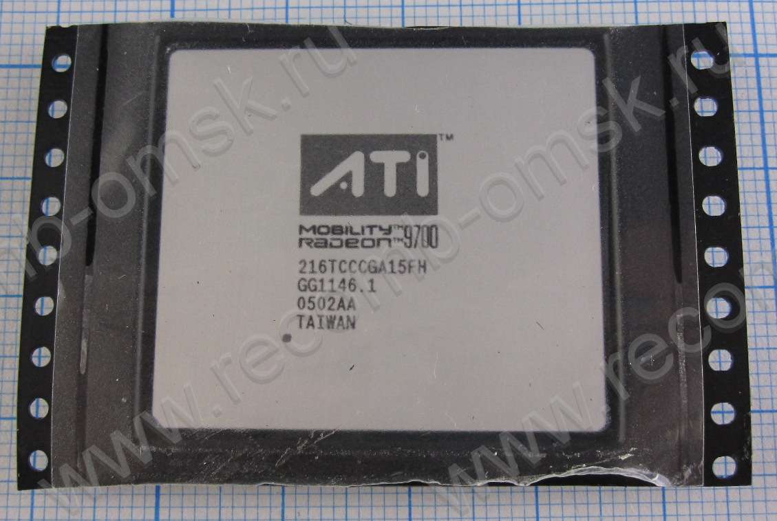

          Re: How to fix ATI 9700 GPU
          hello bro,
          any idea to how remove this? can it be done by use hot air gun?
            Yes it can be done with just a hot air gun, but you will likely need to reball it afterwards, don't expect for the solder to sit nicely in its place when you remove it.
                  Looks like the ATI Mobility 9700 has about 700 lands which is way too many for a hot air gun. You need to pull a similarly sized BGA chip off a junk motherboard with a hot air gun to get an idea of what you're up against. Attempting SMD work without some practice on junk will surely lead to disaster.
                    hi bro,
                    so you're saying that there's no way to cure the GPU using hot air gun? from what i see from the chip the GPU memory(64 RAM) is just sitting on top the GPU then follow by a Aluminum cover...

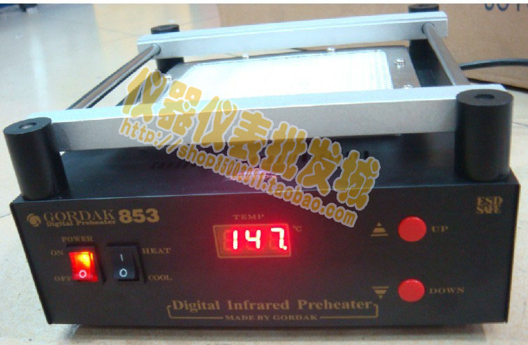

                      TO all guru,
                      can you tell me what's this?i guess is a preheater for PCD board, am i right?
                        Yes, you can use it with a hot air station to remove the ATI chip.
                          The old GPU will come off with the hot air gun at 350*C or more but presumably lhock98 intends to put the one in the package back on and that won't be happening with any hot air gun.

                          • lhock98
                            • Aug 2010
                            • 63
                            hi ablacon64,
                            so with this digital infrared preheater and hot air gun i can remove any chips easily, right? i dont have to buy expensive BGA rework station, am i right to saying so?this digital infrared preheater is selling cheap from china the cost is USD 60 only.

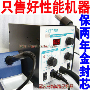

                              This guy used an SMT Hot Air Rework station with adjustable temps you can find a fairly nice one that works without issue on ebay for like 100 bux or so ... I've used them and they seem to work quite well to my amazement but the cost is subject to change from the time of this post I do know that a year ago you couldn't touch them for double that price. Supply and demand I guess.
                              Please note: I am not responsible for any harm caused to you anything discussed is just discussion. Before you try anything discussed be sure that you have the appropriate knowledge and safety gear for the job. Like with anything education and safety are first! Do not try anything @ home without it.
                              • lhock98
                                • Aug 2010
                                • 63
                                are you refering to this type of soldering machine?
