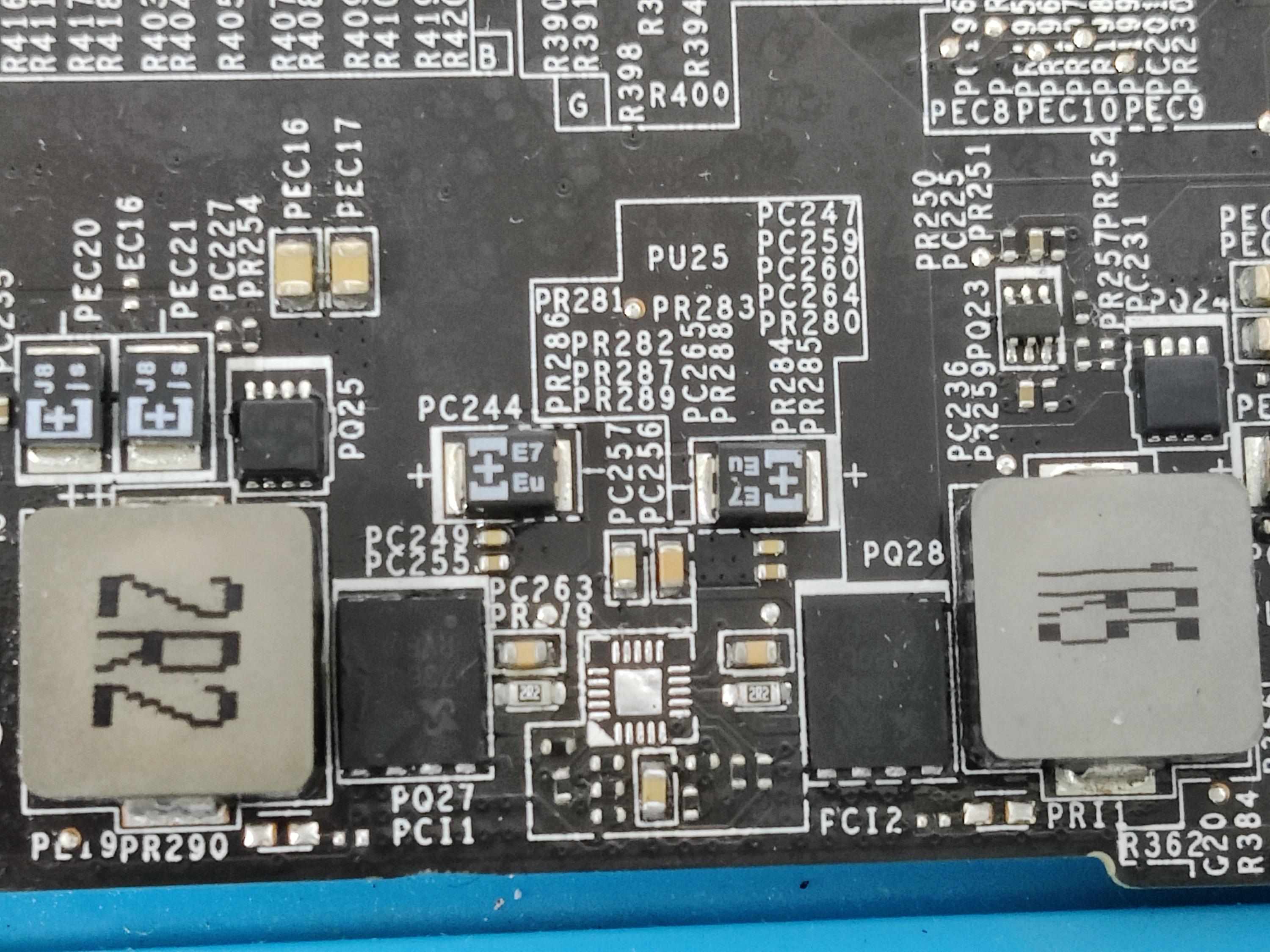

    Hello all,
    I'm trying to fix a msi gs75 stealth 10se, at the beginning ic tps51285b get hot connecting the power supply. I desolder the ic and resolder it and for a while I got 3.3 and 5V on Vreg3 and Vreg5 but now I only have 3.3V on Vreg3 but on Vreg5 0V.
    VO1, SW1 and SW2 looks like are shorted to groung even desoldering the 1285b, mosfet near to the ic are not shorted.
    I would appreciate any help you can provide

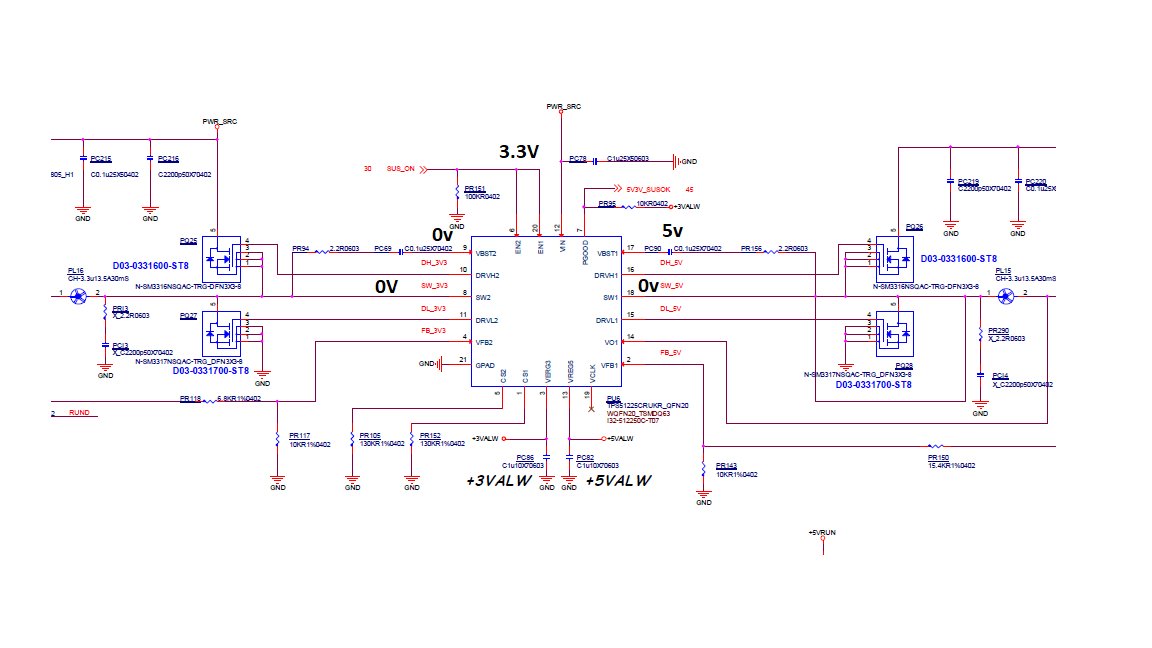

      Thanks for your response.
      The TPS51285B resistance values to ground (without power supply connected) and voltages connecting the power supply
      Pin 1 CS1 6k
      Pin 2 VFB1 12k
      Pin 3 Vreg3 212ohms -> 3,3V
      Pin 4 VFB2 8.5k
      Pin 5 CS2 8k
      Pin 6 EN2 100k
      Pin 7 PGOOD 10k
      Pin 8 SW2 0 ohms. (second reading value 1k)
      Pin 9 VBST2 ol -> 2,2 v
      Pin 10 DRVH2 140k
      Pin 11 DRVL2 140k and increase -> 19V
      Pin 12 VIN 15k and increase
      Pin 13 Vreg5 732 ohms
      Pin 14 VO1 0 ohms
      Pin 15 DRVL1 140k
      Pin 16 DRVH1 145k
      Pin 17 VBST1
      Pin 18 SW1 0 ohms
      Pin 19 VCLK0 ohms
      Pin 20 EN1 100k
      The voltages are 0V for the rest of the pins

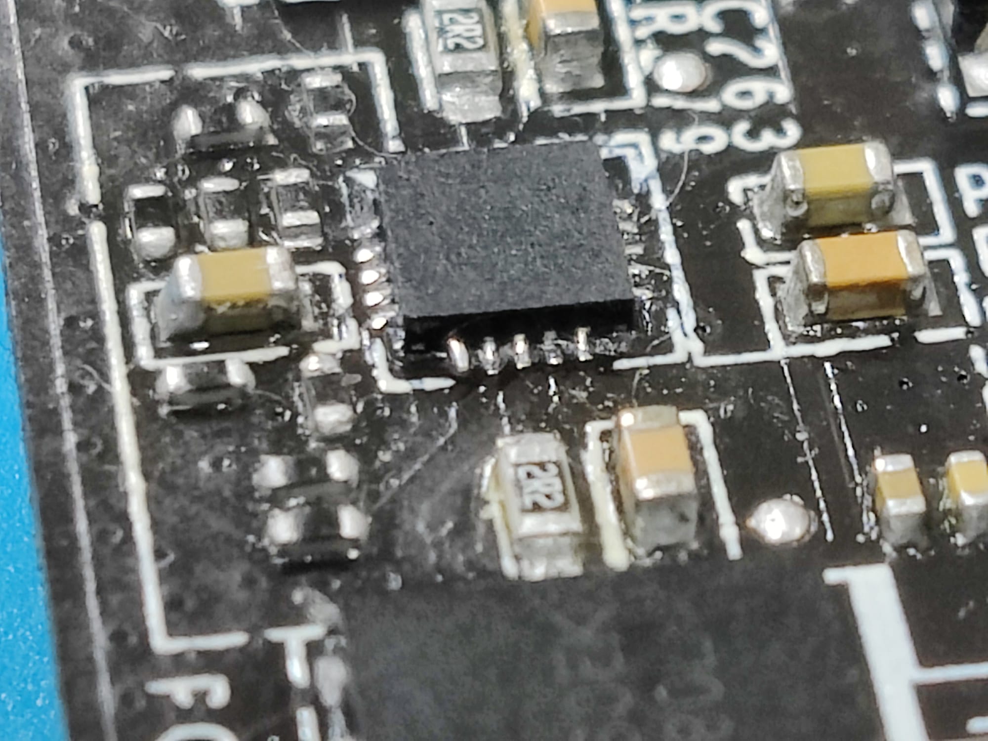

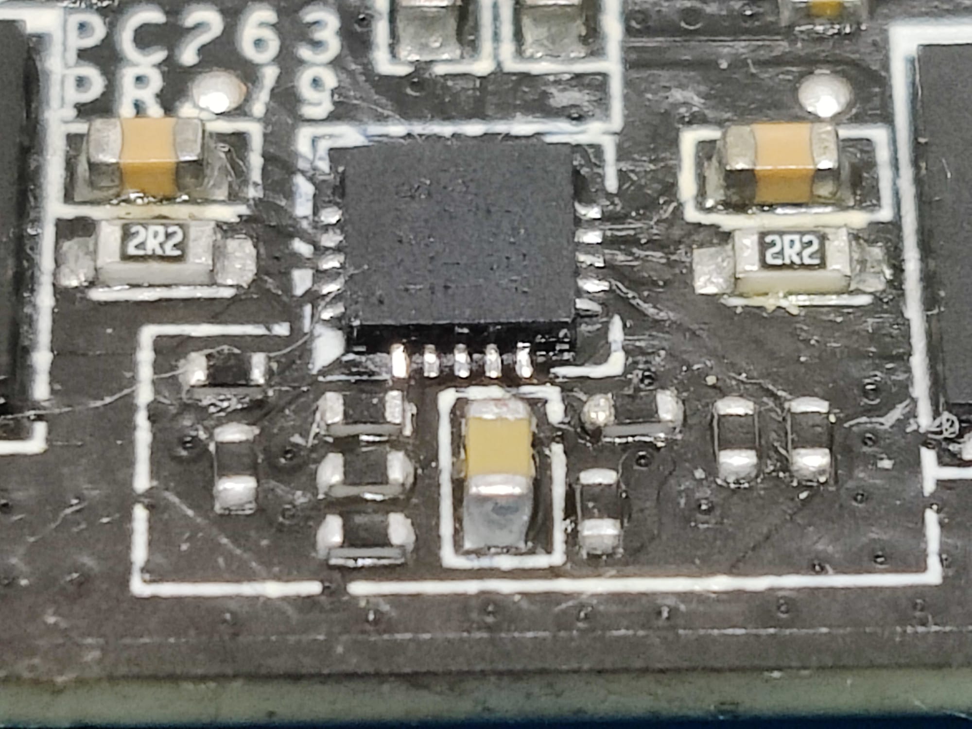

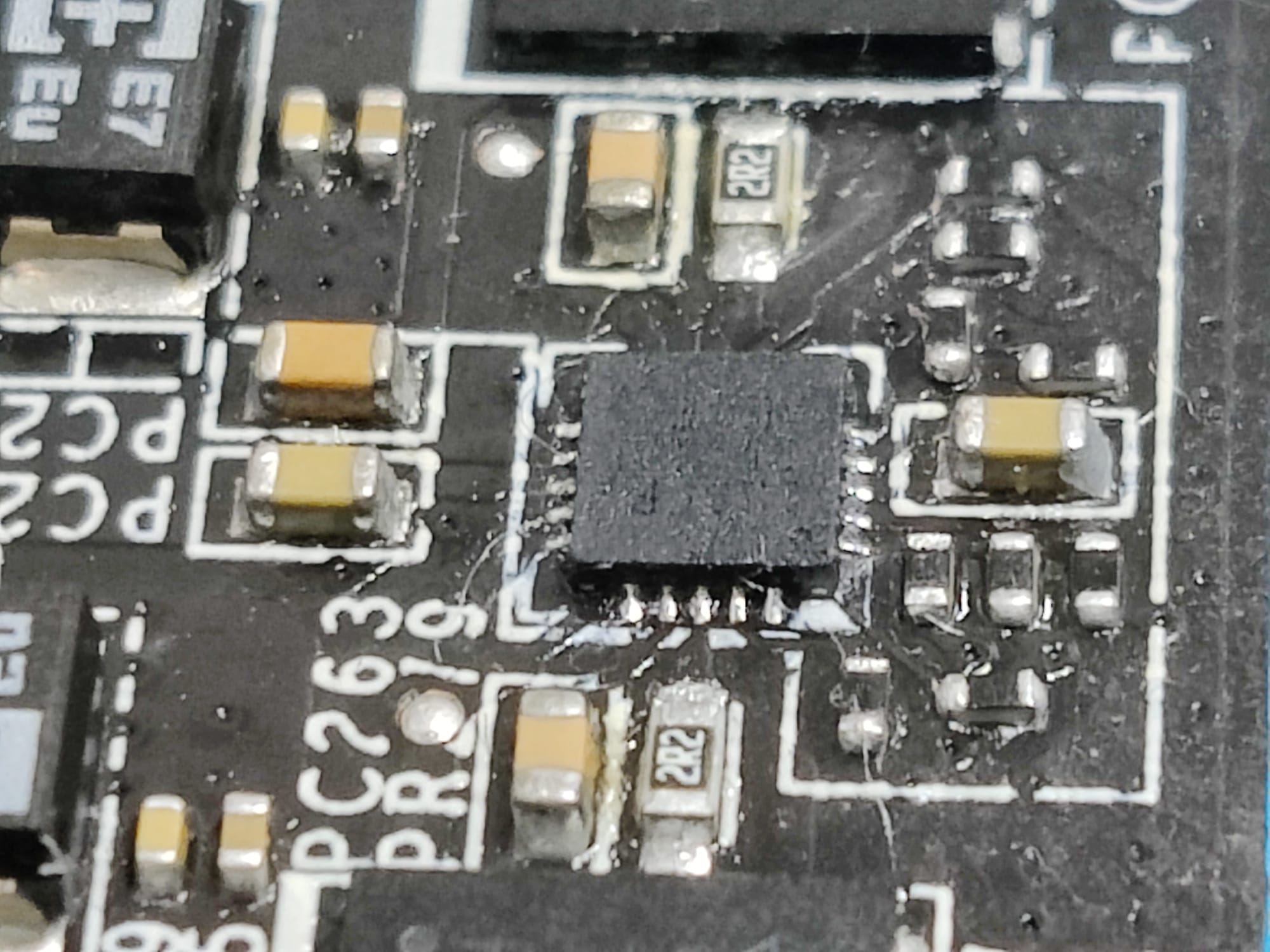

                Re: msi gs75 stealth 10se no 5V
                Vreg5 resistance is fine. On this ‘B’ regulator version, the ldo rails should be fixed on. See tables #1 and #2 in the data sheet for full details.
                The switching output rails should not be a low resistance value. Confirm the measurements again. Share a fresh picture of the reworked regulator area. Perhaps an underside solder short? Flux it well and allow low air pressure to make the part swim into place with a gentle push of the tweezers held by 2 sides of any corner. Watch Louis’ videos on YouTube for guidance. ‘Make the part dance’ will correct hidden solder shorts, if present. Be patient so the pads are not torn off the pcb!!
                  thanks mon2 for your response i'll rework the ic to be sure it's well soldered also tomorrow I'll receive a new 1285B IC to double check (also a ene9028b)

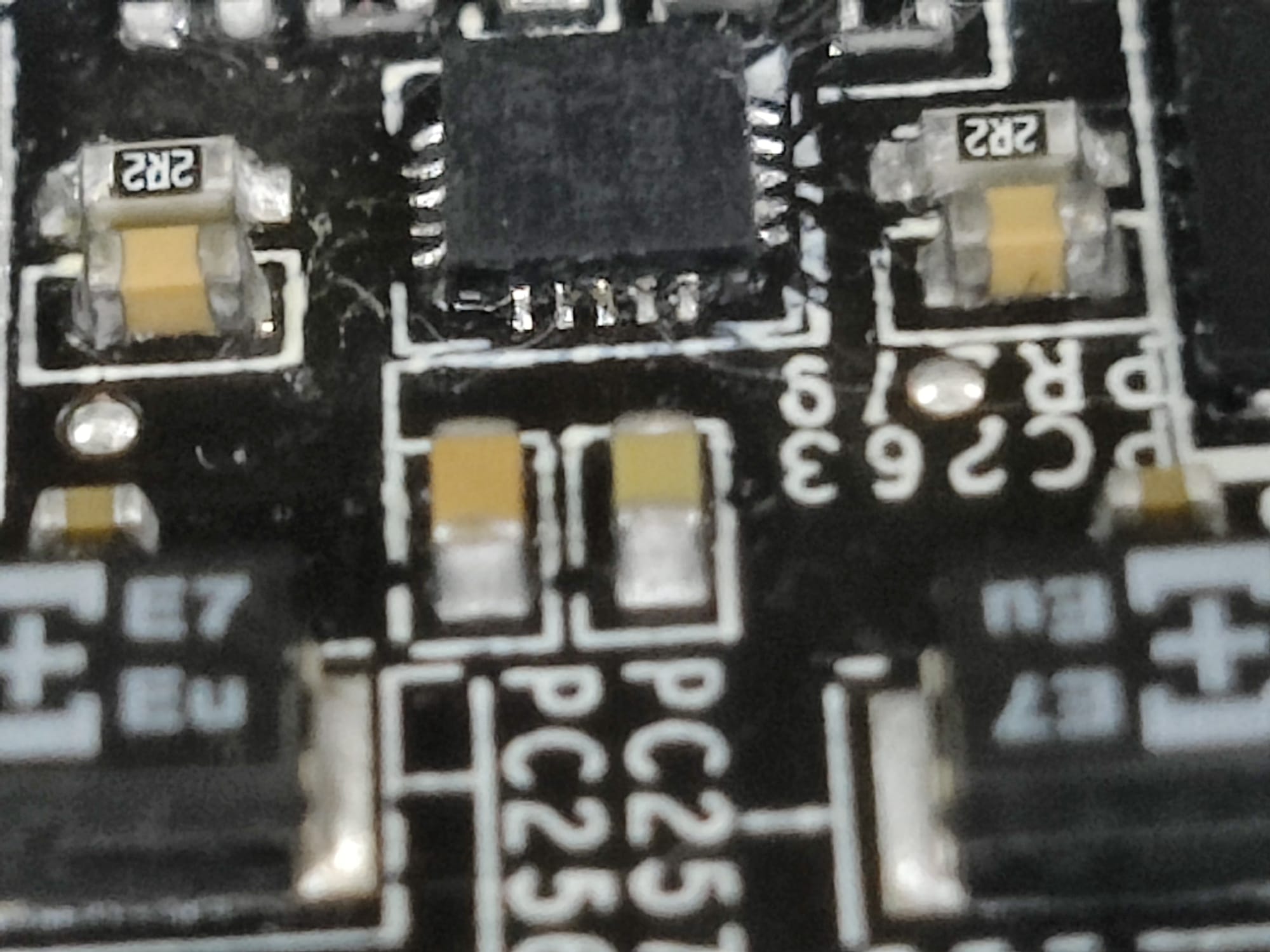

                    I replaced the TPS51285B and now i'm having both LDO voltages but still missing 5Vsus and 3.3Vsus. ENE IC is sending 3,3V to tps51285 Enable pins, now i'm a bit lost what to check.
