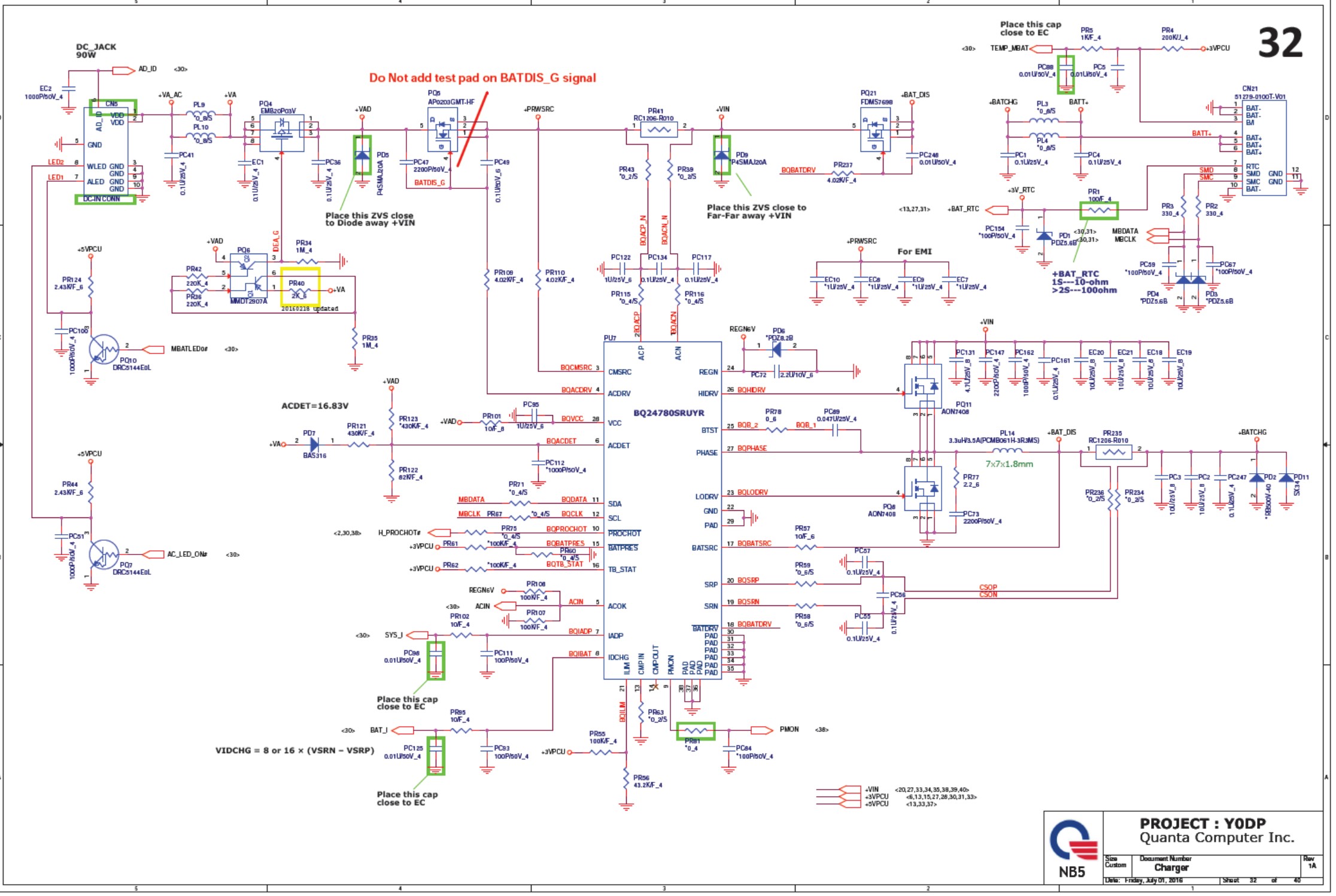

    I've been troubleshooting a failed laptop for a few months now. It's a personal project and I thought it would be easy. Not so much I'm figuring out. The motherboard is a DAYODPMBAFO, I found a schematic for QUANTA Y0DP REV 1A DAY0DPMBAF0 (HP ENVY X360 13-Y023CL), although my board is Rev F.
    Symtoms:
    Neither A/C power or battery charge light turn on when plugged in. Laptop does boot into windows with battery power, however the battery icon shows no charging or presence of the ac adapter.
    Both input mosfets appear good. I can measure the 19V past both mosfets. In checking the bq24780S Charge IC, plugged in (without and with the battery connected), I get the following voltages at the bq24780S:
    See attached for measurements and schematic.
    I have replaced the bq24780S charge IC chip.
    Additionally, when I have the battery and Adapter both connected, the PQ21 mosfet gets extremely hot. I replaced hoping that would resolve my issue, however the new mosfet also gets hot. I'm unsure where to look now. I see I have fluctuating voltages, and the ACOK signal is going from 0 to 2.4V with the same frequency as the other measured voltages are swinging.
    Bad input mosfet? It looks like they are working well, except for the gate voltages are fluctuating with the ACOK signal.

    are you using the original adapter? upload the schematic section. BQ REGN is connected to ACOK with an R1 R2 divider. It should be 0-3.3V max on your platform; 1.84V is less (with the adapter only). Trace it back to two components to test with a multimeter in diode mode without power

      There are multiple faults with the measurements. For PQ21, the gate threshold value is high +21V, which will pass to the battery terminals (4, 5, 6). What supply are you getting for the drain and source? The battery is not detected by the Master and Slave. It may be a bad battery. What supply do you get for PQ4, PQ5, S, D, and G

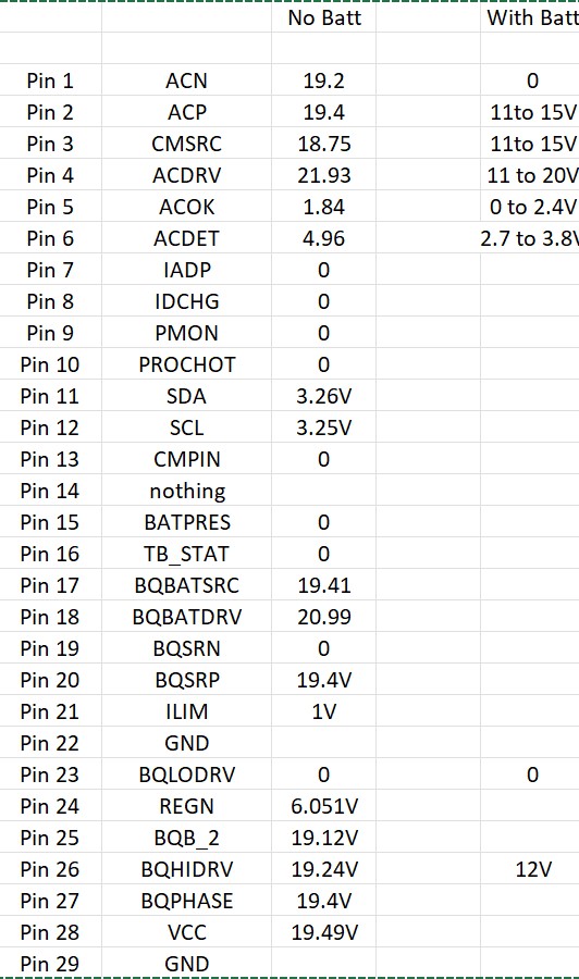

        All these measurements are with adapter plugged in with battery connected.
        PQ21
        D 11.5-15
        S 11.5-13V
        G 12.5 (not sure how I measured 21V before). Seems stable at 12.5V now
        PQ4
        D 11-15V
        S 11-15V
        G 11-15V
        PQ5
        D 11.5-15
        S 11.5-15
        G 11.3-21V
        REGN6V (pin 24 of Charger IC) = 6.05V
        ACIN (ACOK - Pin 5 of Charge IC) = 0V to 3V (alternating)
        Note: charger is original (and I have a second identical, same issue). Battery will boot laptop, and is holding a charge. I have a second battery, same result.

          test PQ4 and PQ5 for S D G supply without a battery update? Afterward test PQ21 for S D G supply without AC adapter update ? for ACIN test on PR106 and PR107 using the multimeter's resistance mode for update?. Is the voltage alternating on the input side of PR106?

            Without Battery:
            PQ4
            D 19.49V
            S 19.54V
            G 17.88V
            PQ5
            D 19.49V
            S 19.42V
            G 21.77V
            PQ21
            D 19.92V
            S 19.42V
            G 19.81V
            ACIN 1.83V (steady) (common to PR107 and PR108)
            PR106 => This revision does not have a PR106 populated. I wish I has a schematic for this Rev F. However PR106 on previous Revs connected to PU12, pin 3. Measuring that pin finds 0 volts. I'm thinking you were asking about PR107 and PR108 (resistors connected to ACOK).
            PR107 resistance:84K
            PR108 resistance: 85K
            Without Adapter
            PQ21
            D 11.22V
            S 11.21V
            G 12.55V
            REGN6V (pin 24 of Charger IC) is still = 6.05V
            ACIN (ACOK) = 0V (steady)(common to PR107 and PR108)

                Regarding the measurements for PQ21, when only the adapter is connected, the power supply should cease at the drain. However, in your case, the power supply is crossing over to the battery when the battery is connected. At this moment, the two power supplies will conflict with each other, which is why PQ21 is experiencing a leak again (hot)

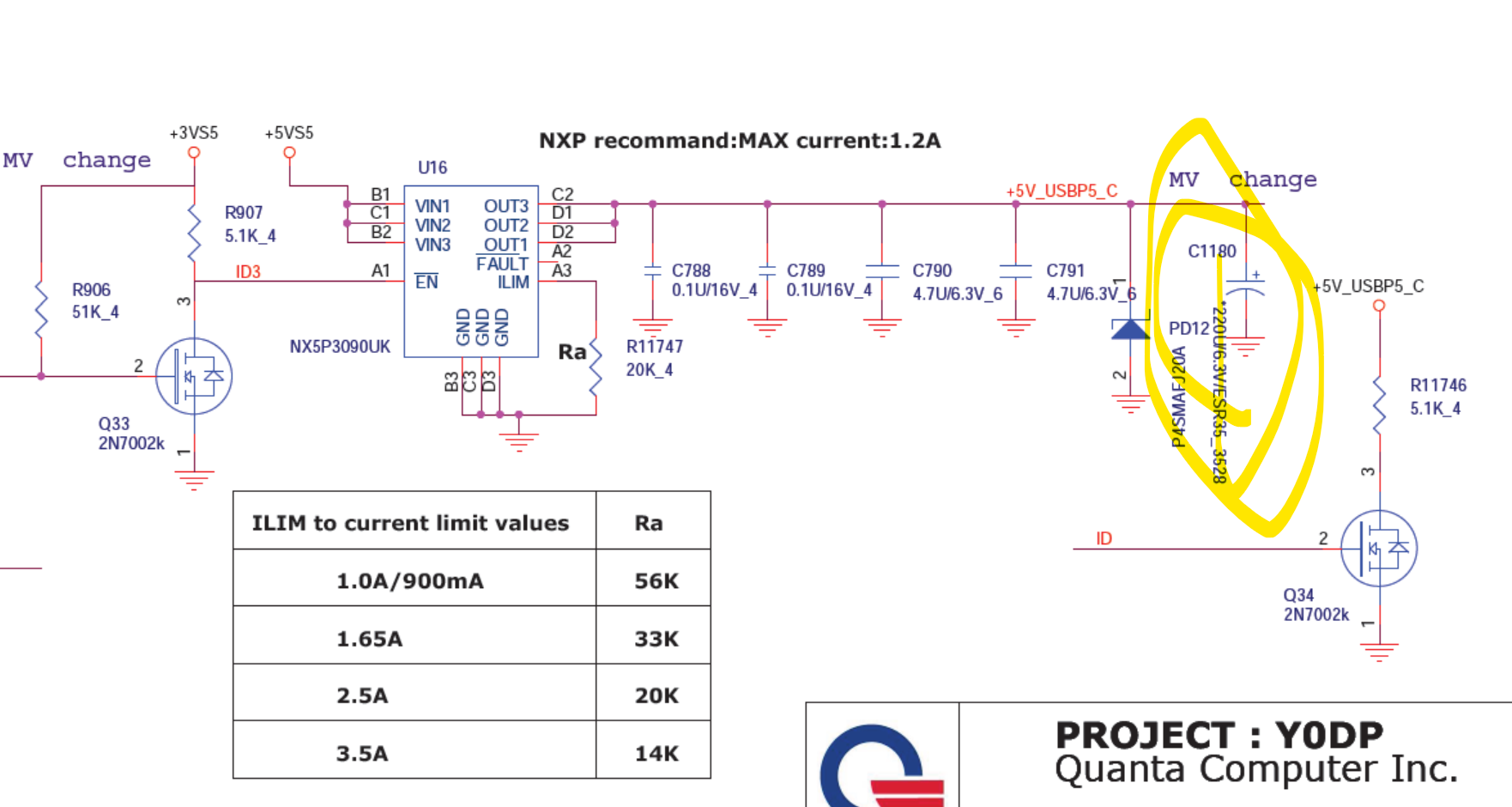

                              After letting this repair sit for quite a while, I thought I would take one last try to repair this MB. I finally found the bad capacitor! It was on the 5V usb circuit (current limiting IC circuit) for the USB-C port. I removed that cap, and now the laptop is charging and otherwise back working. I haven't replaced the cap, just removed it and left it off.

                                This is one capacitor that should be present and serves as an in-rush current limiter for the USB's VBUS power rail. From the USB spec, this capacitor should be 120uf or higher. Suggest the voltage rating of this cap to be 16v or higher.

                                  Thank you for the quick response. I'm going to replace this capacitor then, and need a hand deciphering the value. The schematic shows "220U/6.3V/ESR35_3528". I got it all figured out except the ESR value. would that be 35 mOhms? I can't find any 35 ohm at Mouser. If mOhm, then this capacitor at Mouser: T55B227M6R3C0035. Does that seem right?Click image for larger version

                                    Correct - the table below the text confirms the mOhms. The lower this value, the better the quality of the cap.
