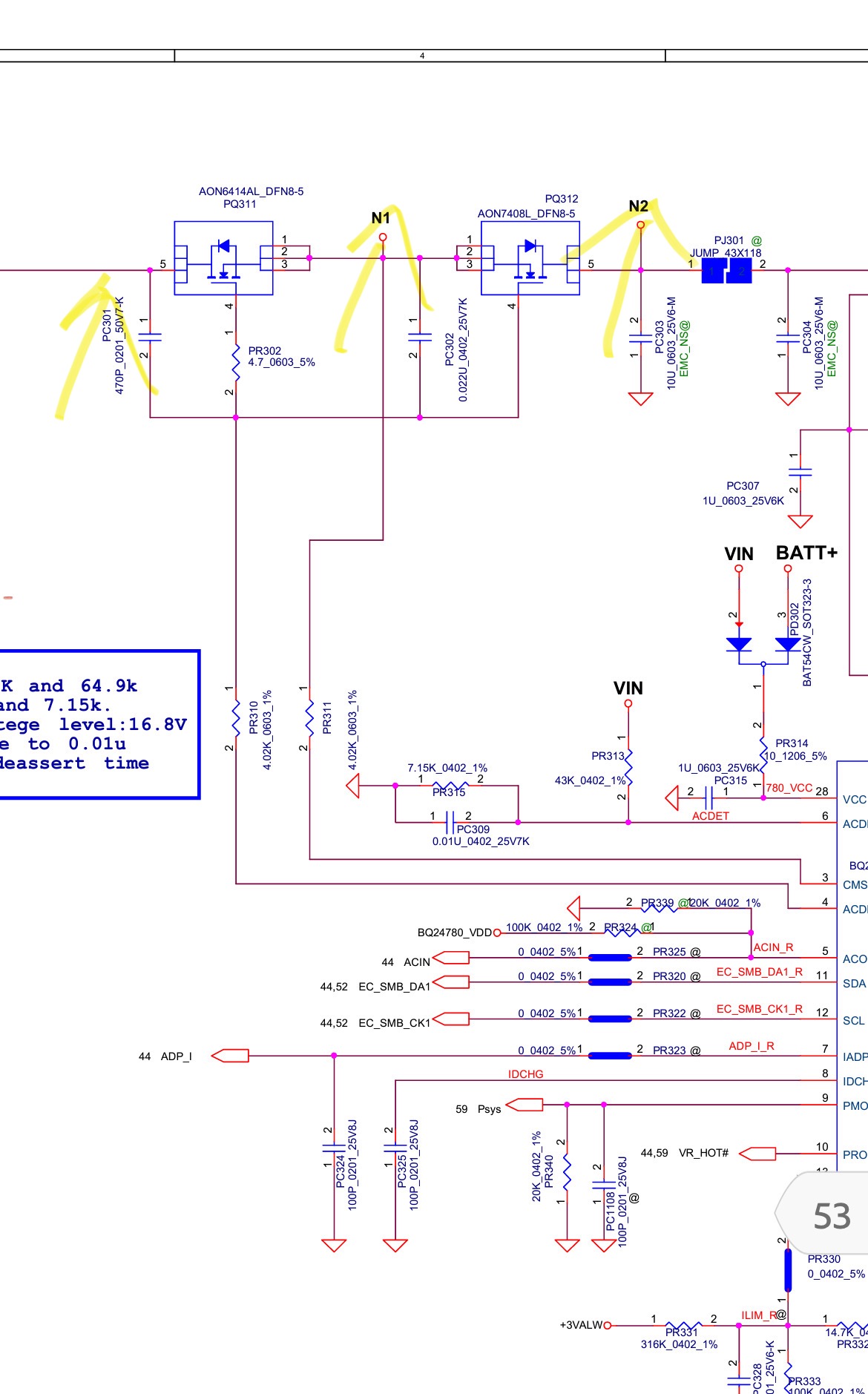

    Hi
    I have this laptop it shuts down immediately after lenovo screen
    sometimes hold for a few more seconds
    rltk 8111 (NIC) is getting hot tried without it still shuts down by it self
    resistance over coils is prity high
    i can see battery is not charging as well
    can any one advise ?

    Remove the keyboard and battery to see if there are any changes initially

      "If there's no change, check the supply voltage at the N1 and N2 terminals,PU301 specifically on Pin 3, 4, 5, 6, 28, and 24. Voltage? This issue may be related to the LID_SW."

        Hi thanks for reply
        voltages at bq chip
        pin 3 1v
        pin4 4.98v
        pin 5 3.3v
        pin 6 2.7v
        pin 28 19v
        pin 24 5.97v
        what do you mean N1 N2 terminals ?
        Also, I have tried remove the lid switch chip and still same, also replaced BQ chip same resault
        Any other idea ?

          There is a fault in pin 4 ACDRV not producing the correct voltage above +22V. It could be one of the components on this line, or possibly the BQ itself. I will provide an update.

            First, check the two MOSFETs, PQ311 and PQ312, in Diode mode using a multimeter to measure resistance the following connections:
            Source to Drain
            Source to Gate
            Gate to Drain

              Hi
              It is a typo
              on pin 24 i have 24.98
              on mosfets
              s to d 0.52
              g to d O.L
              s to g O.L
              both the same

                Earlier, you mentioned 6V, but now24V double-check it for the Mosfet test S to D, and confirm if it's 0.52 or 0.520 Ohms
