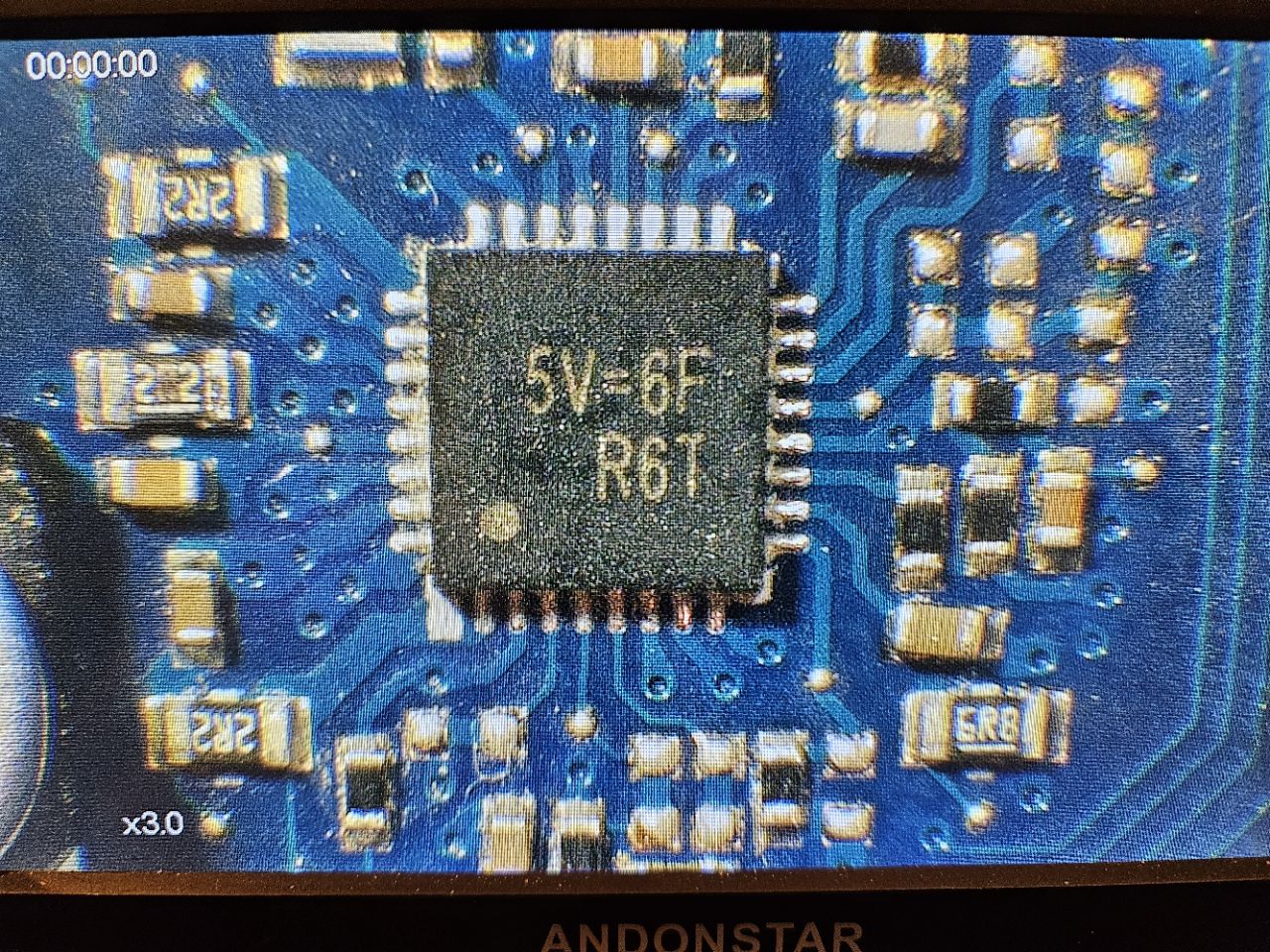

Ideapad S340 LA-H103P. Please help me identify this IC chip
  • trepachka
    • Oct 2022
    • 456
    The chip quickly goes to about 160c when power applied. I just need to figure out what it does and hopefully find a replacement. Thank you.
    • 21841
    Re: Please help me identify this IC chip
    Its a richtek part,but havn`t found the part number yet https://www.badcaps.net/forum/showthread.php?t=90619
    What motherboard is this on ? ,post the model number.
    • trepachka
      • Oct 2022
      • 456
      Motherboard LA-H103P - Lenovo Ideapad S340
      • Vesko356
        VIP Moderator
        • Aug 2018
        • 4386
        • Bulgaria 🇧🇬
        Richtek marking 5V= is RT3612EBGQW

        • trepachka
          • Oct 2022
          • 456
          Re: Ideapad S340 LA-H103P. Please help me identify this IC chip
          Thank you. They are only available in China, I just ordered one.
