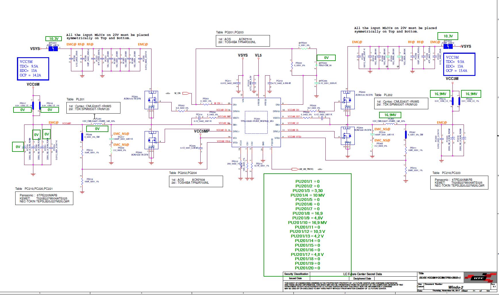

    I need some help troubleshoot my T480. It´s restarting after 10 seconds without showing screen-output.
    I´ve already flashed the bios but this doesn´t help.
    Now I´ll try to check the board. I´ve already done some measures:
    PU201/3 = 3,30
    PU201/13 = 5,03
    PU201/12 = 0
    PU201/6 = 0
    PU201/20 = 0
    PU201/7 = 0
    PJ201 = 10,3
    PJ202 = 10,3
    PQ202/4 = 16 MV when running
    PQ202/5 = 5,13 V when running
    PR217 = 0 / 5,13 when running
    PR218 = 0 / 5,13 when running
    I think the output of the mosfet PQ202 / Pin 4 is not working, but I´m not sure.
    Please find the schematic attached

      You´re right, the measurement is wrong, here we go again:

        Please see attached more measurings. What can I check next for missing M_ON?
          Re: Lenovo T480 Power cycle
          M_ON is generated by SIO.So you need to check the requirement of SIO. Link the schematic so that i can be precise what to check.

            Hi, thank you for your help! I´ve attached the schematics.

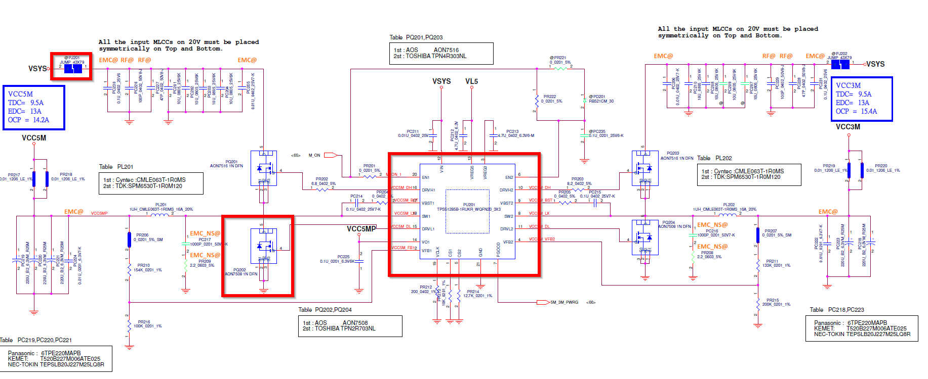

              The TPS51285B is not generating the output voltage for PL201/202 +5V/+3V. The M_ON signal is enabled to this IC, so you need to trace it back

                  We're on a wrong track. M_ON is generated after power on only-so nothing wrong there. Why it was in a loop needs to be investigated but now it has gone completely dead.
                  Suggest to remove PU201 and check resistance to GND on all pins without the IC soldered and no power attached.
                  PS: Dont put any power(both adapter & battery) while PU201 is de soldered. Else mb will go to trash.

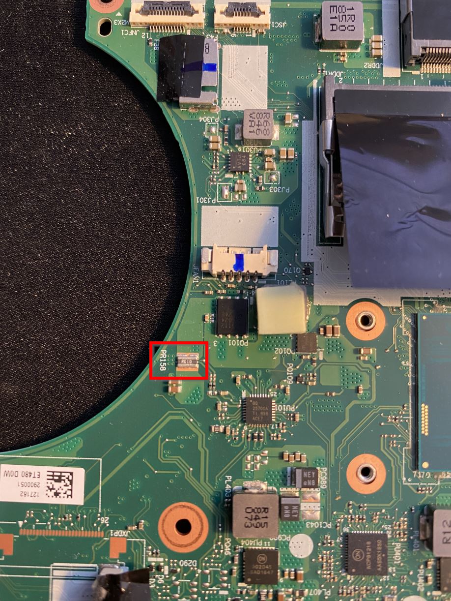

                      PIN 12 is your VIN aka 19V main rail-so its shorted to GND. Locate PR58 which is your CLR and de-solder it. Measure resistance to GND on both pads of PR58. The side which is shorted to GND needs voltage injection from DC supply to find out what is shorted. The voltage should not be more then 1V. Do you have a dc bench power supply?

                          So, just ordered a power supply. I Found PR158, do you mean this?
                          I´ve desoldered it and the bottom pad goes down to around 2 MΩ. Upper Pad goes down to 2 MΩ and then to 0.3 MΩ.

                              Yes,i meant PR158
