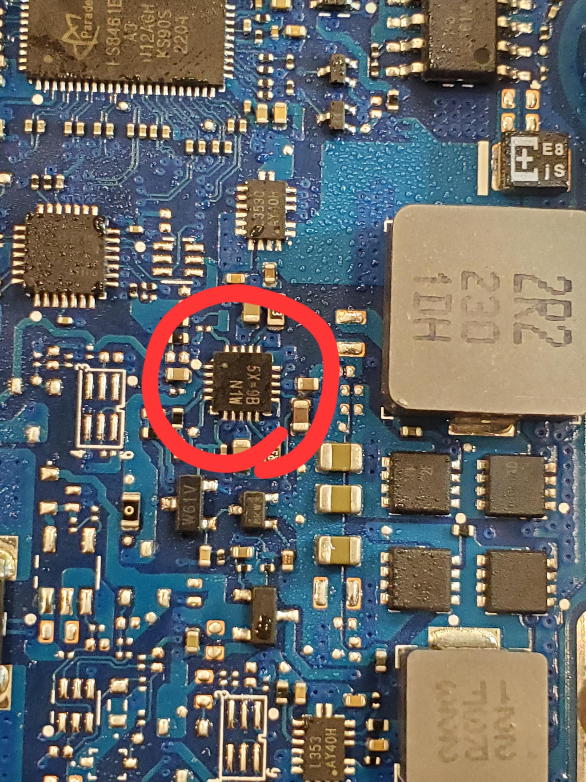

    Hello guys, asus fx507 no power.
    Can someone help me identify this component, I am suspecting because it's hot when charger is plugged in.
    See attached

    Re: Asus FX507z DA0NJKMBAF0
    RT6575DGQW
    It's 3v & 5V regulator
      Thank you

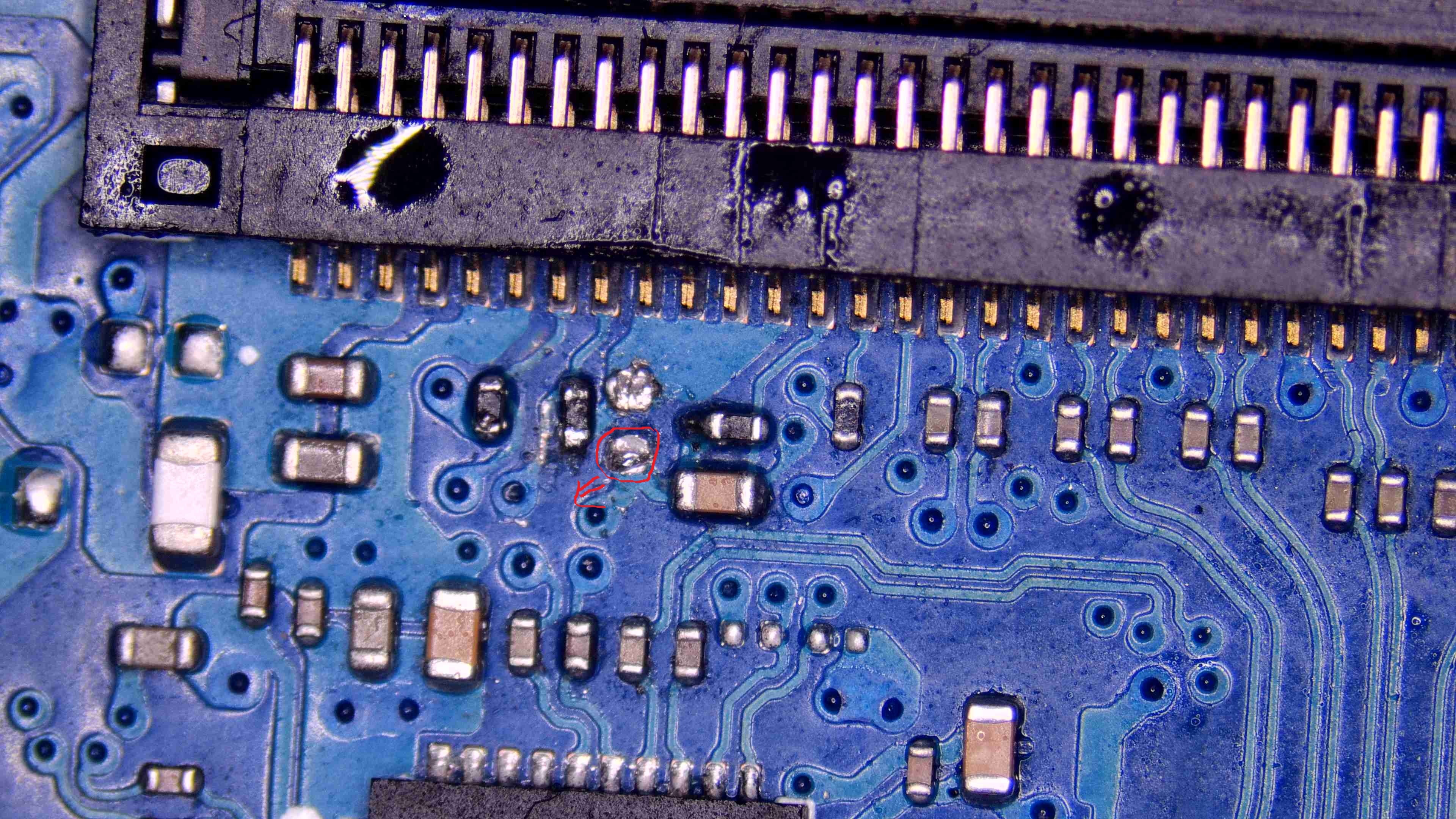

          hello guys , i have this lap asus fx517mz , the client try to change screen and something goes wrong ...the point on the picture grounded i think its lcdvdd & the pin 1 main bios is grounded too , i dont have schematic or drv for this mobo ..any ideas bros ?
            From your first picture i'm pretty sure those pin is 3V lcd.
            but for the bios voltage that you say grounded i don't know if it save to inject voltage and search which part that short or no since bv or schematic not available

              probably an inductance or resistance (perhaps 0 ohm) is missing, I can't see well from the image but check if the point circled in red is shorted
                yes bro the point in red is shorted
                  what if inject volt in lcdvdd point?
                    i won"t do that without knowing where the line go
