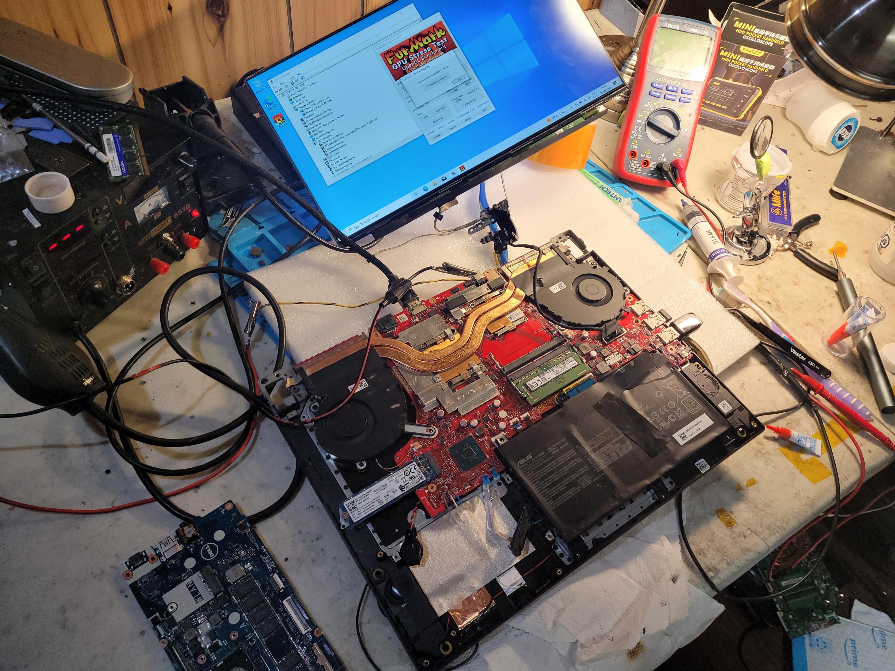

      Re: Asus G531GT missing vcore and mem 1.2v
      Thanks for the reply.
      the resistor connected to
      The p_DDR_EN_10 was bad.
      In stalled new 620kohm resistor and all voltages
      Are back.
      But theres no video.
      I worked on the same model last week and there sound as well when it post the splash screen wich is missing as well.

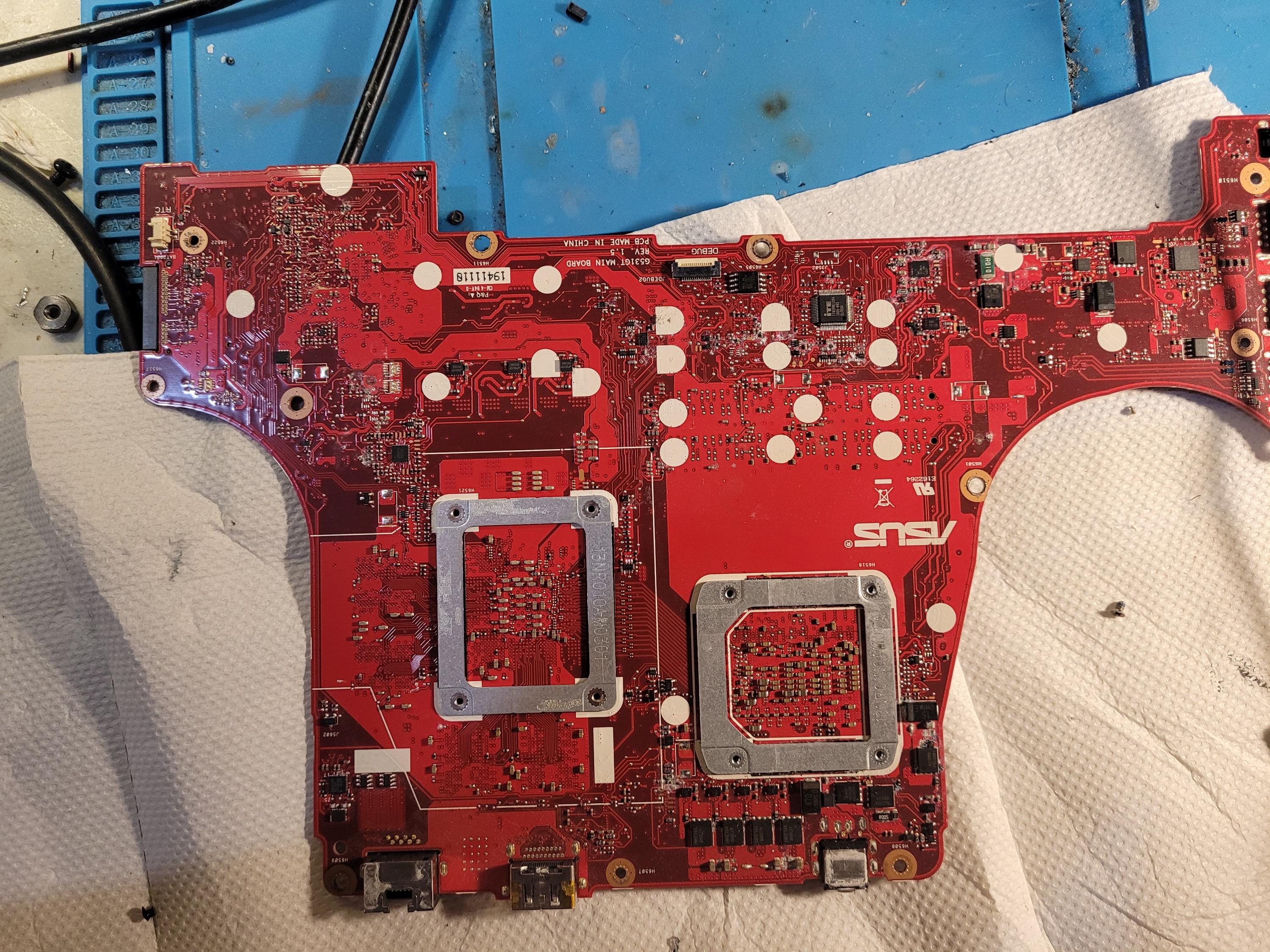

        Picture of the water damage
          This was a lot of damage... issue is solved?
            No, I have all power rails but no picture.
            I'm still looking for the problem.
            All water damage was on the back of the board, there was a lot of damage

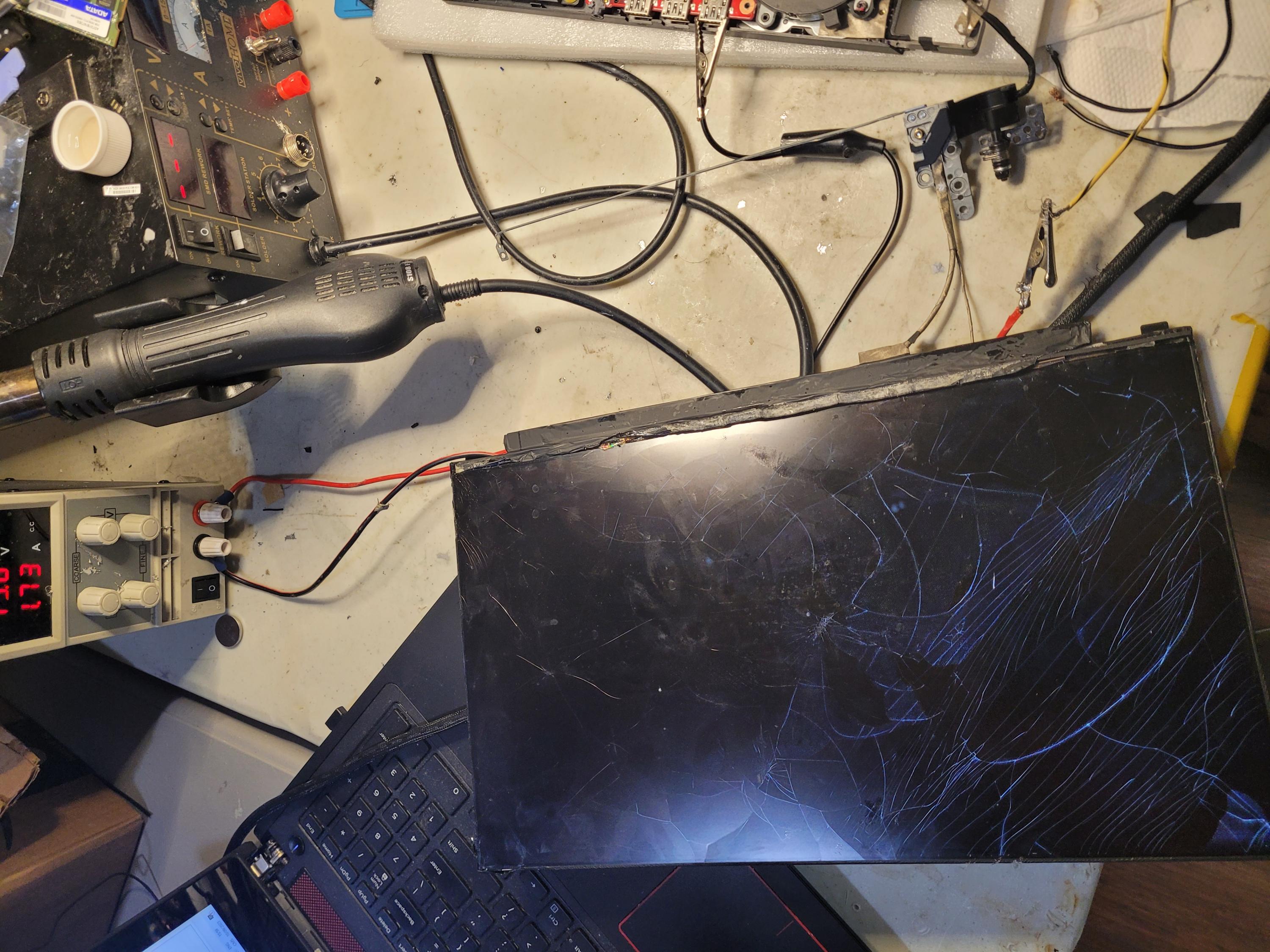

              It seems the memory module that came with laptop is faulty.
              I changed it and it starts up with splash screen sound.
              But the other issue is the screen is also cracked.
              The backlight is on but there's no way to see q picture.
              I can't seem to get anything on the hdmi port.
              When disconnect the display and restart the post sound disappears.
                Found another screen and its up and running!
                Had to change the power management chip,2 resistors and one bad cap.
                I'm amazed, that's all the problems there was.
                That's the most water damage iv ever came across.
