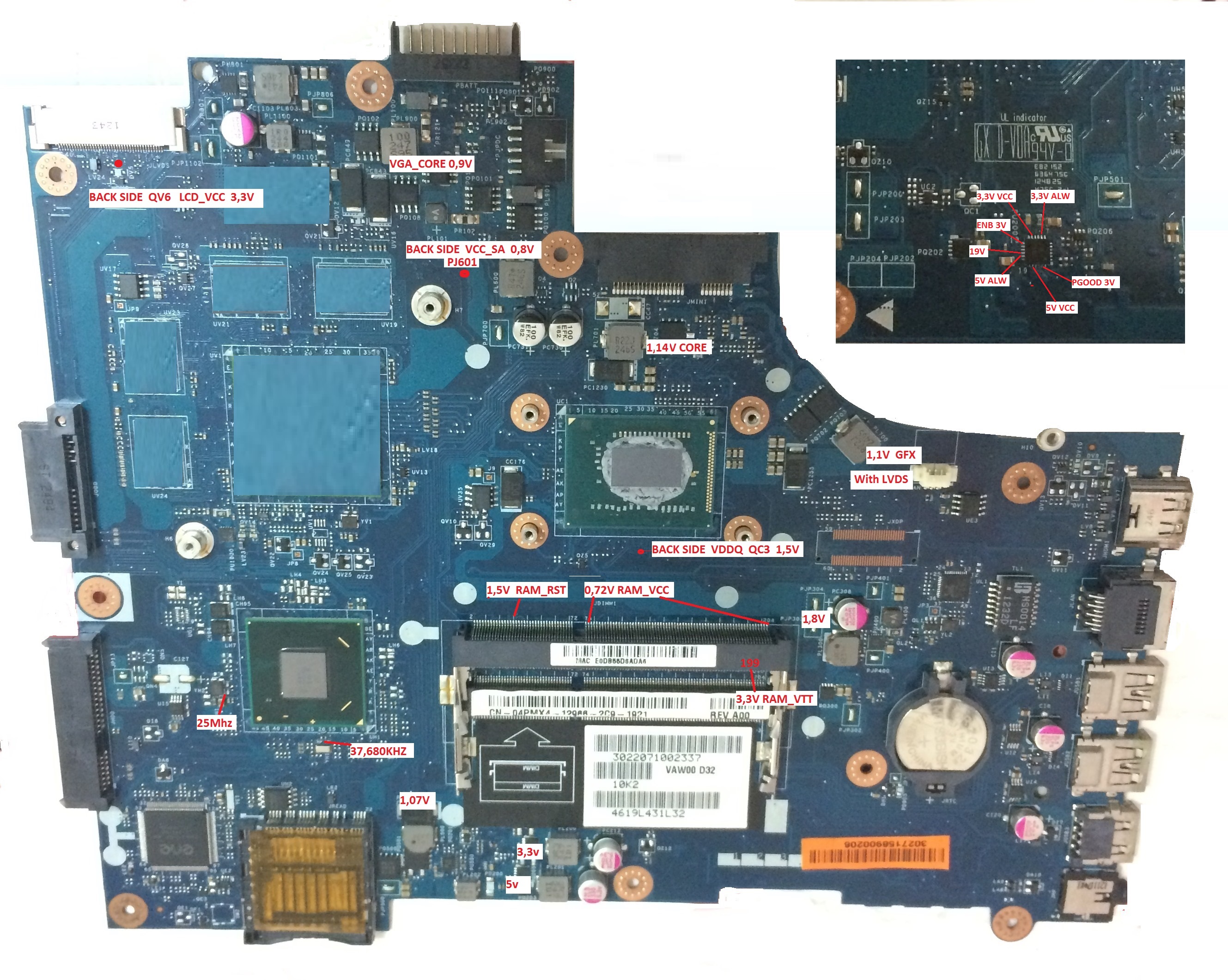

    Hi , I have this laptop with no picture problem, also mo picture on external monitor via hdmi port.
    All coil voltage present, IC for LVDS has all voltages.
    Any tips?

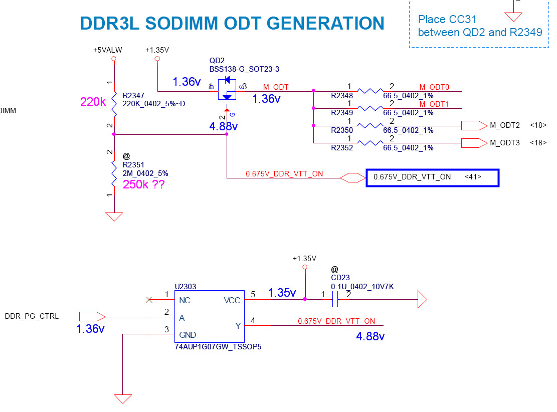

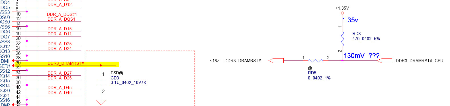

              I did some measurment, DRAMRST# is missing
              DDR_PG_CTRL 1.35v
              0.675V_DDR_VTT_ON 4.88v, is this normaL? because I see 0.675v named net but voltage diveder looks ok
              Here images for measurment
              To have DRAMRST# voltage I guess need to be present some other signal,but not know which one. DRAMRST# goes from CPU

                Re: Dell Inspiron 15 3537 Compal LA-9982P
                DDR_PG_CTRL 1.35v
                check the Ram slot pin 203 voltage if its +0675VS the move on, for 0.675V_DDR_VTT_ON 4.88v this is ok since @R2351 is not in used so V-Divider
                check RD3 470 with out power resistance, what is the voltage on J510 J511 VS

                    RD3 is ok,j510,j511 voltage present pin203 ram ok. All ram voltages ok except dramrst#. I saw other boards ,before dramrst# must have ok signal dram_pwrok,but not have on this board so named signal,maybe other named so if you have sch please find it.PLT_RST also present 3v2

                          You have not given the readings RD3 j510,j511 pin203

                            Nop what is the voltage U2303 all pin
                            • ziko07
                              • Jun 2021
                              • 99
                              • Somewhere
                              I put measurements of u2303 above in attachment
                              Post #6
                              Pin2 = 1.36v
                              Pin5 = 1 35v
                              Pin4 = 4.88v
                              Its 7407 ic hex buffer
                              In input 1.36v
                              On output 4.88v, strange but on my inafe in post6 0.675c_ddr_vtt_on is connected to 5valw through voltage divider actually r2351 missing so its not divider as you wrote above
                              Tnx
                              • mon2
                                • Dec 2019
                                • 14533
                                7407 = open drain buffer. This means the output voltage does NOT have to be the same as the input voltage. Instead, when there is a low on the input, the output will be a low voltage.
                                If the input is a high voltage ('1' state); the output will float open and an external pull-up resistor will define the output voltage. Respectively, it is safe to have the output pulled-up to a higher voltage than the input range.
                                The exact datasheet for the 7407 will offer full details.
                                Being an OD buffer, '0' = '0' (input to output); '1' = 'Z' (high impedance unless the external pull-up resistor is present).

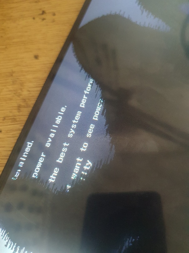

                                        Finally picture comes ON (on broken lcd tested)
                                        Very big thanks to "techtiger"
