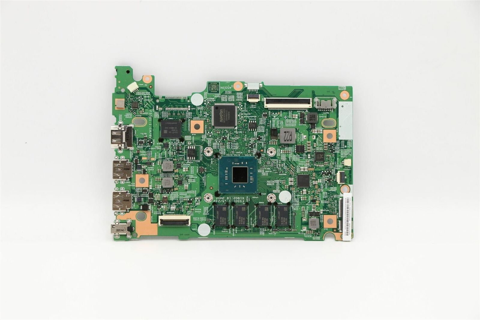

    I am trying to fix Lenovo ideapad 1 14|GL05 (Wistron LS1511G 19705-1M).
    When I press the power button its bulb turns on. But no display. When I keep the button pressed for a while. It goes off.
    I have the following rails working
    3.3V
    5V
    1.2V

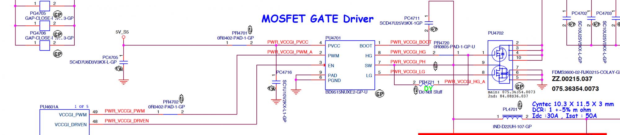

    The big coil (PL4701) which should be the CPU power supply doesn't produce any voltage. 19V is coming to the MOSFET.
    The microprocessor is not getting warm and no display. Is bios signal needed to power on CPU/GPU vcore?
    I flashed the bios but had no success. Please support me to go ahead. Thanks!

    What is the resistance to GND on vcore coils(likely two coils for vcore and another coil for GFX)?
    Alot many rails need to come up before vcore appears on motherboard,eg,VCCSA/1.8V/2.5V.

      Resistance to the ground is 205 Ohms.
      An Image of the motherboard and schematic are attached herewith.

                    PMIC_EN voltage is wrong. Its derived from 3v_5V_PWRGD,so check whether its present or not.PU4601,pin30 voltage? All_sys_pwrgd is derived from PMIC_pwrgd which in turn is derived from pch_pwrok. The pull up used is 3.3V,so logically speaking it should be 3.3V.
                    1D2V_S5 - 1.05V as per your post#7.Should be 1.2V.

                        These measurements looks good to me. I've seen All_SYS_PWRGD at this value on some working boards-so may be its correct. Is the ram soldered or is there a slot?
                        Voltage on these coils please
                        PL5103
                        PL5001/2/3/4

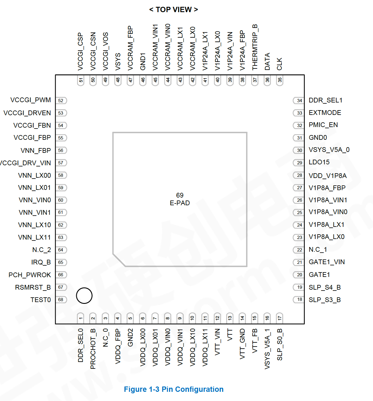

                            The main power IC here is BD2670MWV. What are the essential signals and voltages I have to check to figure out why VCCGI_DRVEN is not high? Really complicated issue for a beginner.
