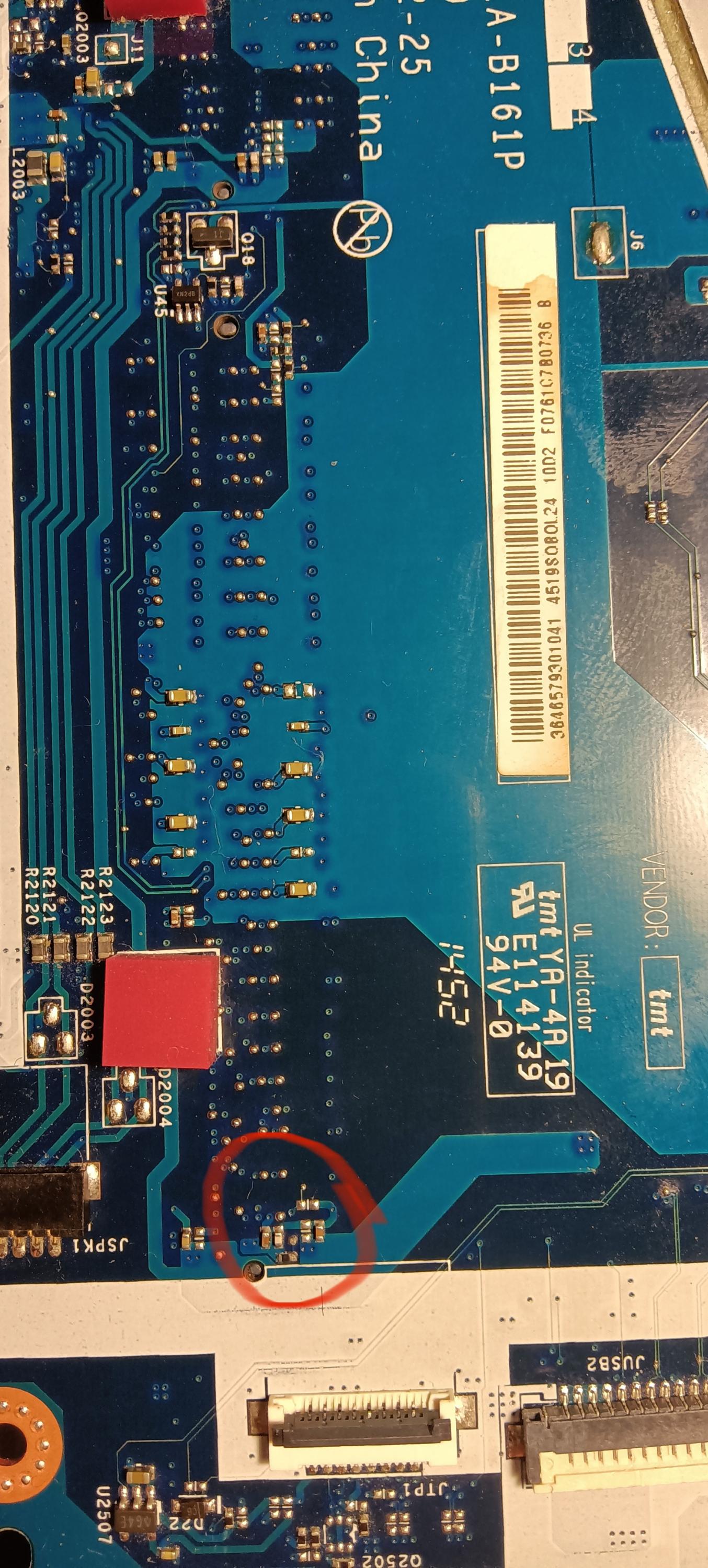

              More often then not,laptop stuck at oem boot logo is related to SIO or nearby components. Check SIO and nearby components for corrossion.
              Does it shuts down after acer logo or remains stuck there?
              Does it boots to windows on battery alone?

                yes, in fact, I had noticed a small area with a little oxidation but the components do not seem to be affected
                it won't turn off it stays stuck on the logo
                window won't start on battery only

                  Which area has oxidation?
                  • poweron
                    • May 2019
                    • 365
                    • italy
                    Re: acer E5-571-51H2 / i5-5200U no boot
                    the area circled in red behind one of the two ram slots

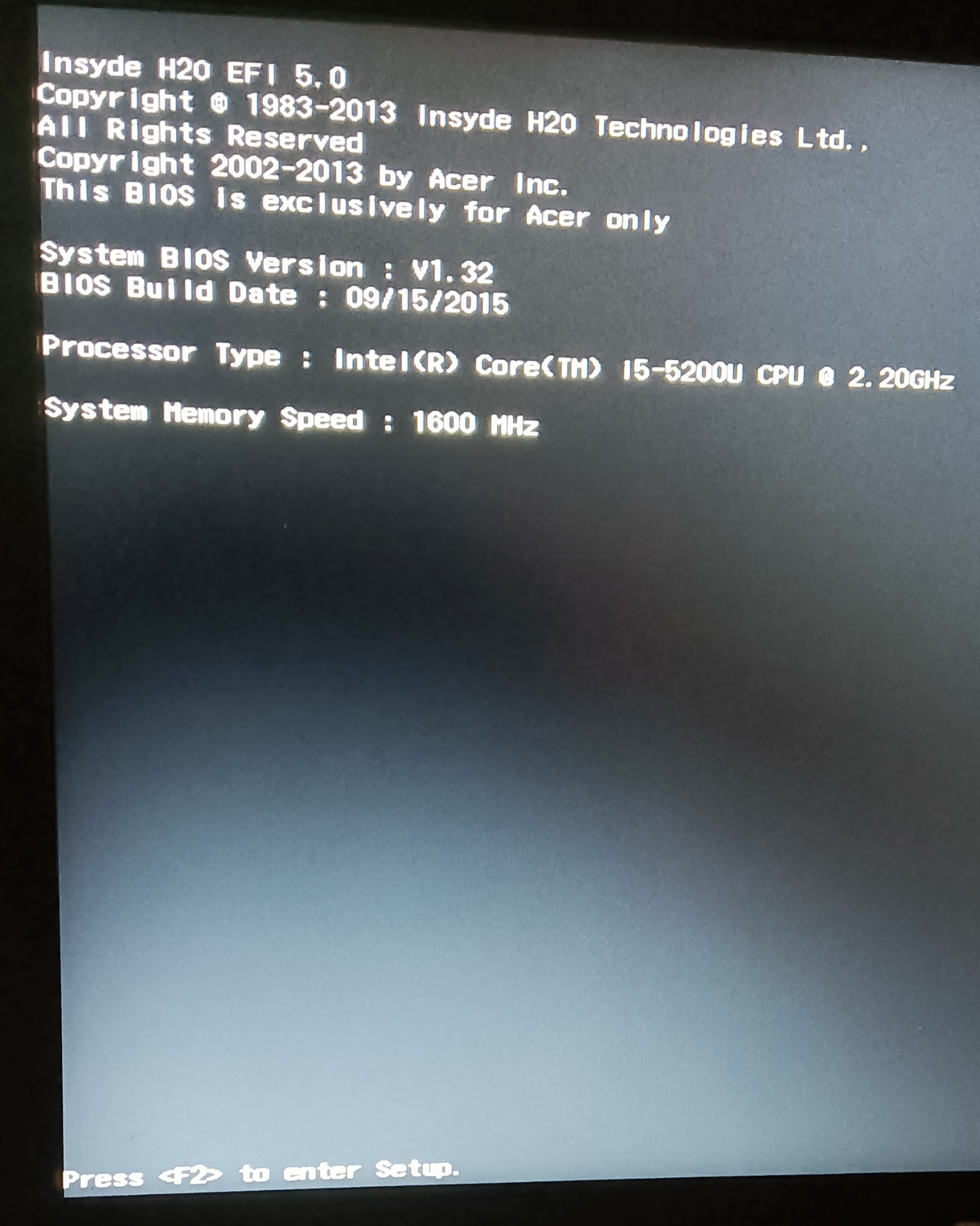

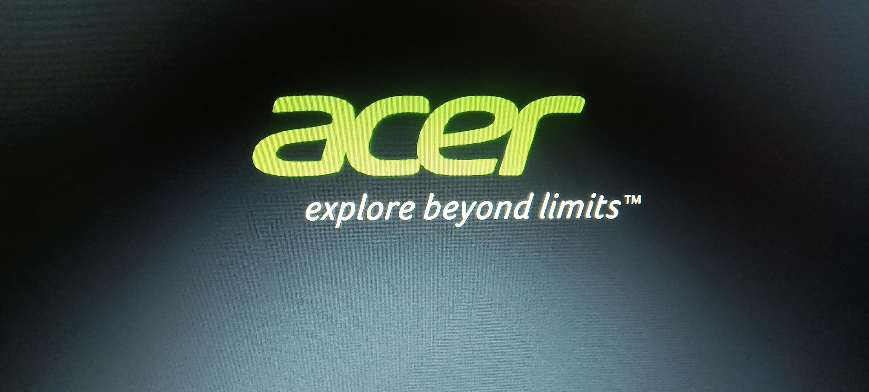

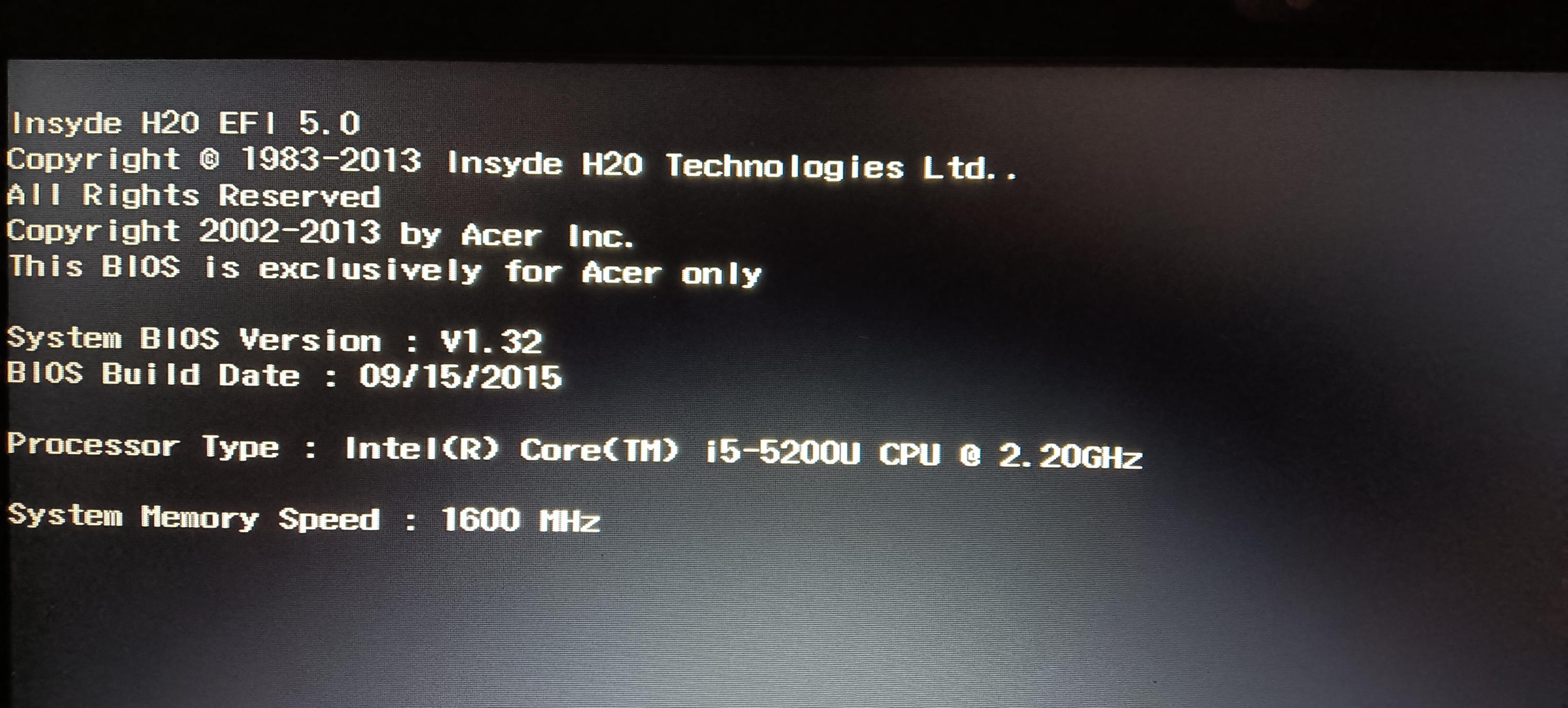

                      hello, I did some tests, I turn on the notebook and the acer logo appears which always remains fixed, it is not possible to enter the bios by pressing f2, by pressing esc a text appears that summarizes the bios ram cpu data etc., then under a message that invites you to press f2 to enter setup, I pressed , the message disappears but does not enter setup and remains so, after 5 minutes it entered setup, and so every time I turn it off and on again the same thing
