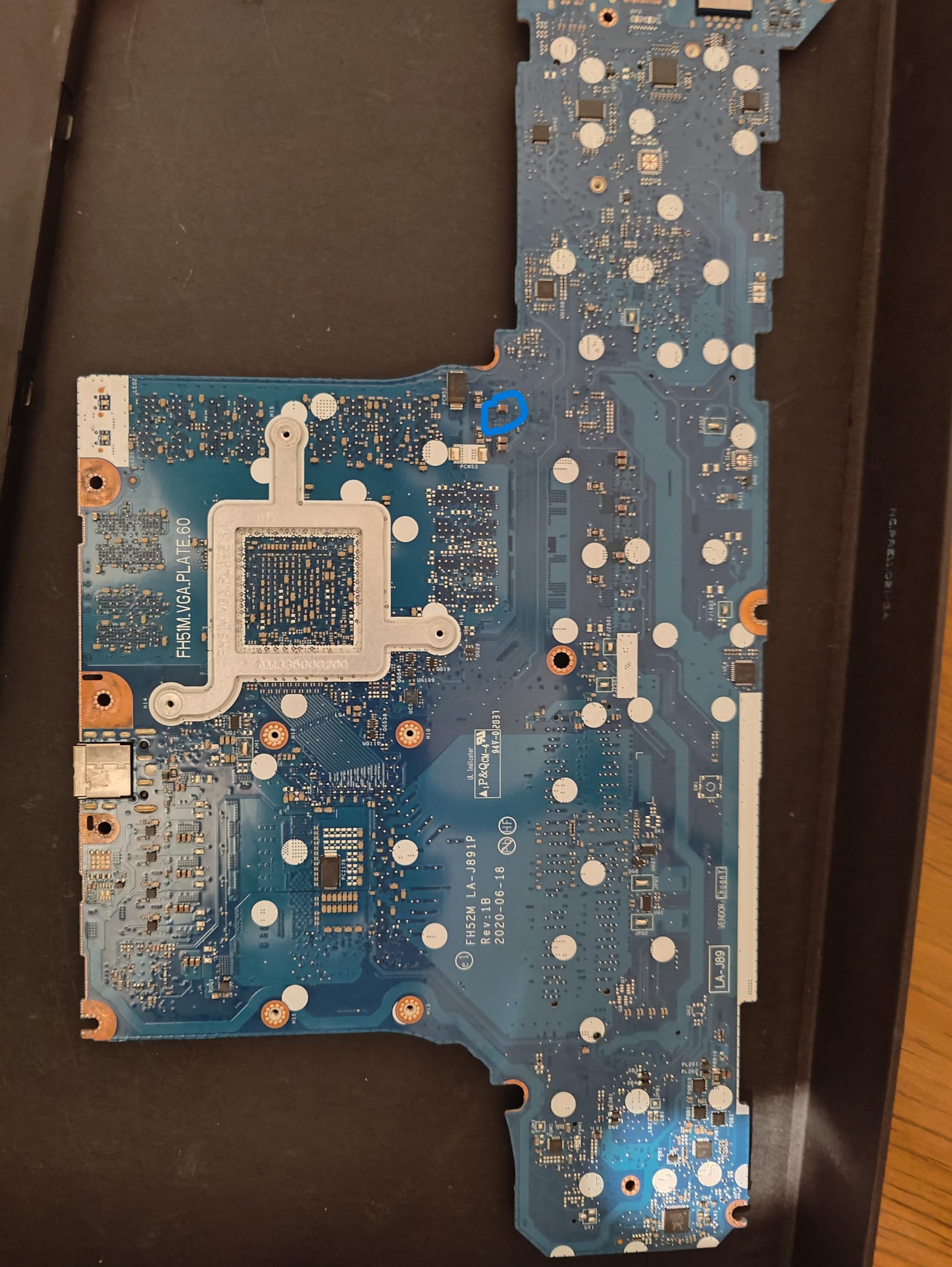

    Hi Guys noob here on electronics repairs but have been reading a lot of posts on here for similar boards and issues and have progressing quite a bit.
    A bit of history on the board, this is a water damaged Mb, initially I cleaned the board and found that there was a Short on +19 Vb rail (0.6ohm).

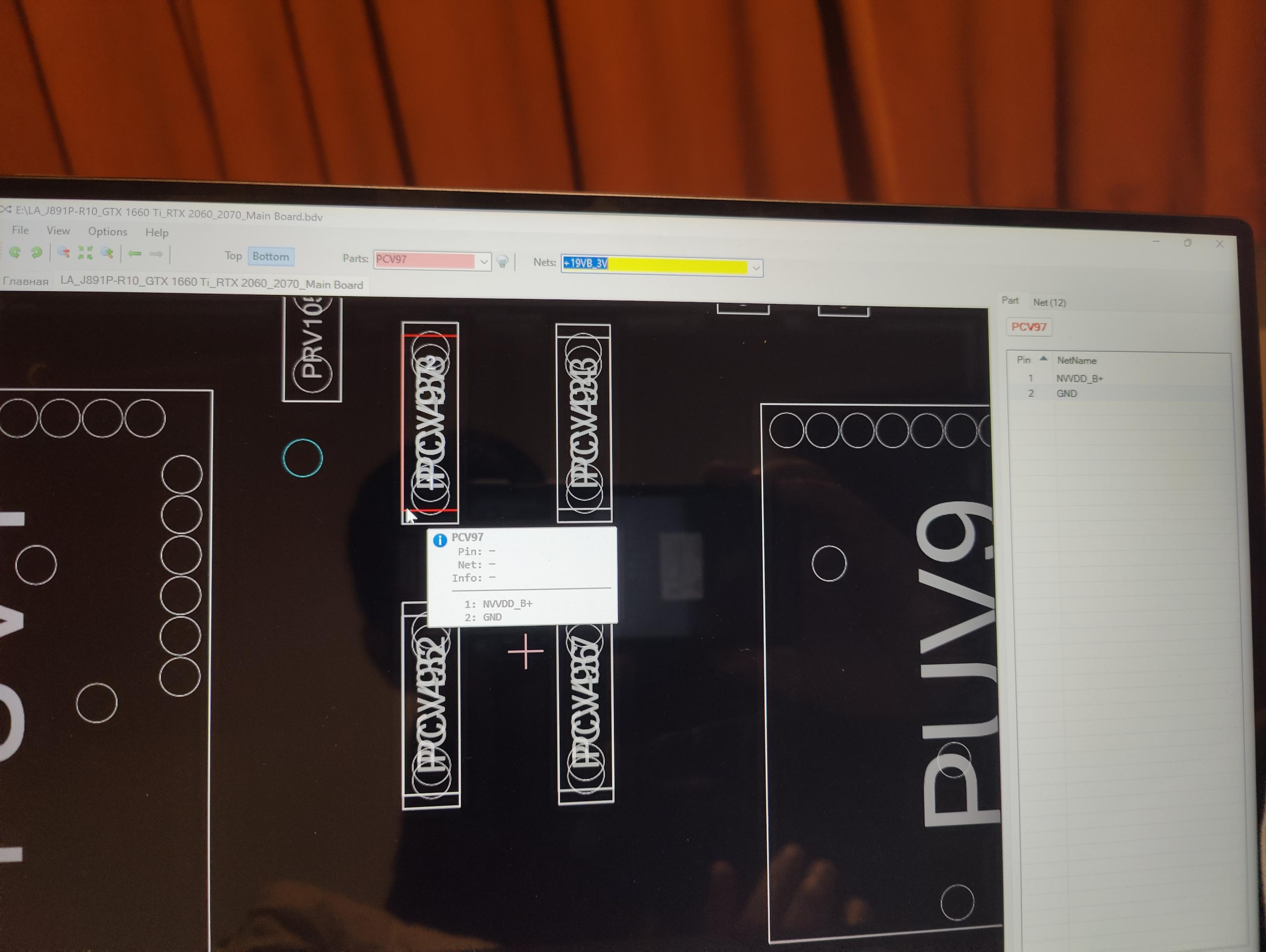

    I injected voltage (1V) and used thermal cam on the 19 Vb rail and found a cap (PCV97) shorted cap near PUV4. I removed it and short was gone. Attempted power no response, checked 19V rail and shorted again. Injected 1V again and found a cap near PCW52 shorted, removed. And short is gone.
    Plugged battery and charger in, battery charging PU301 warm, charger light on
    Power button pin 3.3 V
    Tried to power on, fan spin, light on, turns off within a couple of seconds.
    I noticed I would only have +3VALW and +1.05VALW momentarily after Power button was pressed ( which seems correct looking at power sequence schematic). PU1101, PUW1 and PCH warm up for a few seconds
    I read on another post about thermal protection circuitry near DB1 so i have jumped DB1 and removed PB14 and PB13.
    Pressing the power button give the same results quick fan spin, but now i have constant power at +3VALW and +1.05VALW. PCH is staying warm, chip looks to have uniform heat, holding at 23 C, is this a bad PCH? All chips mentioned before pulse heat once when power button is pressed.
    Now the I have
    Checked all rails 19V (xxK ohms), 3V (xxK ohms) , 1.8V (xxKohms), 1.05V (33ohm) no shorts.
    Voltage on
    PQB11 19.5V - source and gate
    PQB12 19.5V on gate and 25V on drain
    No shorts on PQZ1- PQZ4
    PLZ2 - PLZ4 - approx 3.5 ohm
    PLZ1 - 15 ohm
    +3VLP , +5VALW, +3VALW, 1.05VALW and 1.8VS all reading correct voltage
    One thing i found is 0V on DRAM_RESET ?
    Is the PCH toast or should i keep trying?
