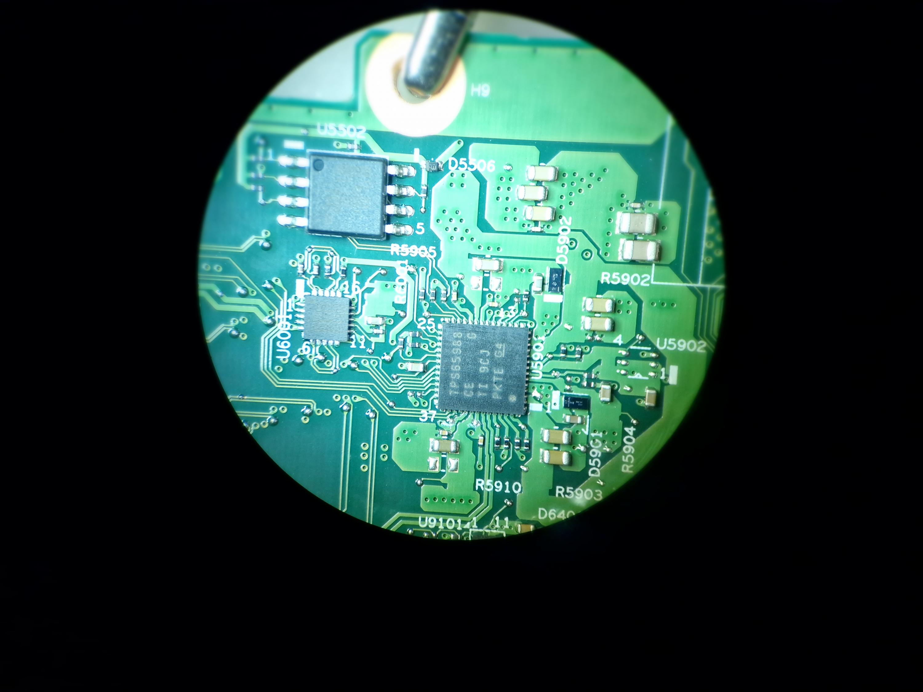

    I have a Lenovo ThinkPad T490 that will not start. When the charger is plugged in, the power indicator flashes 3 times, the charging LED lights up, the fan starts spinning, but the charger remains at 5V, which is not the fault of the charger.
    The 5V appear on the main power rail at the current sensing resistor.
    What can I check next? How can I check the power delivery protocol?
    Schematics and boardview can be found here: https://www.badcaps.net/forum/showthread.php?p=1146770

                    You really require a USB-C meter that can display the power delivery contracts or a USB-C bus analyzer. Each can monitor the data flow, if present from the PD controller on the logic board and the power adapter. After this handshake is completed, the controller will select the best suited power contract to power the logic board. This is often a stand alone pd controller with an onboard cortex M0 or similar microcontroller.
                    Any physical damage to the pd controller? Post a pic of the device.

                      Re: Lenovo ThinkPad T490 power delivery
                      there is no damage.

                          Have you checked the firmware of the U5502(TBT ROM), and the voltage at VCC3_LDO_TBT_SPI?
                          • rumpumpel1
                            • Jul 2019
                            • 155
                            • germany
                            Bingo! that's it!
                            I downloaded the newest TBT firmware from the Lenovo website and after flashing the new firmware the voltage showed 20V!
                            Thanks a lot!
