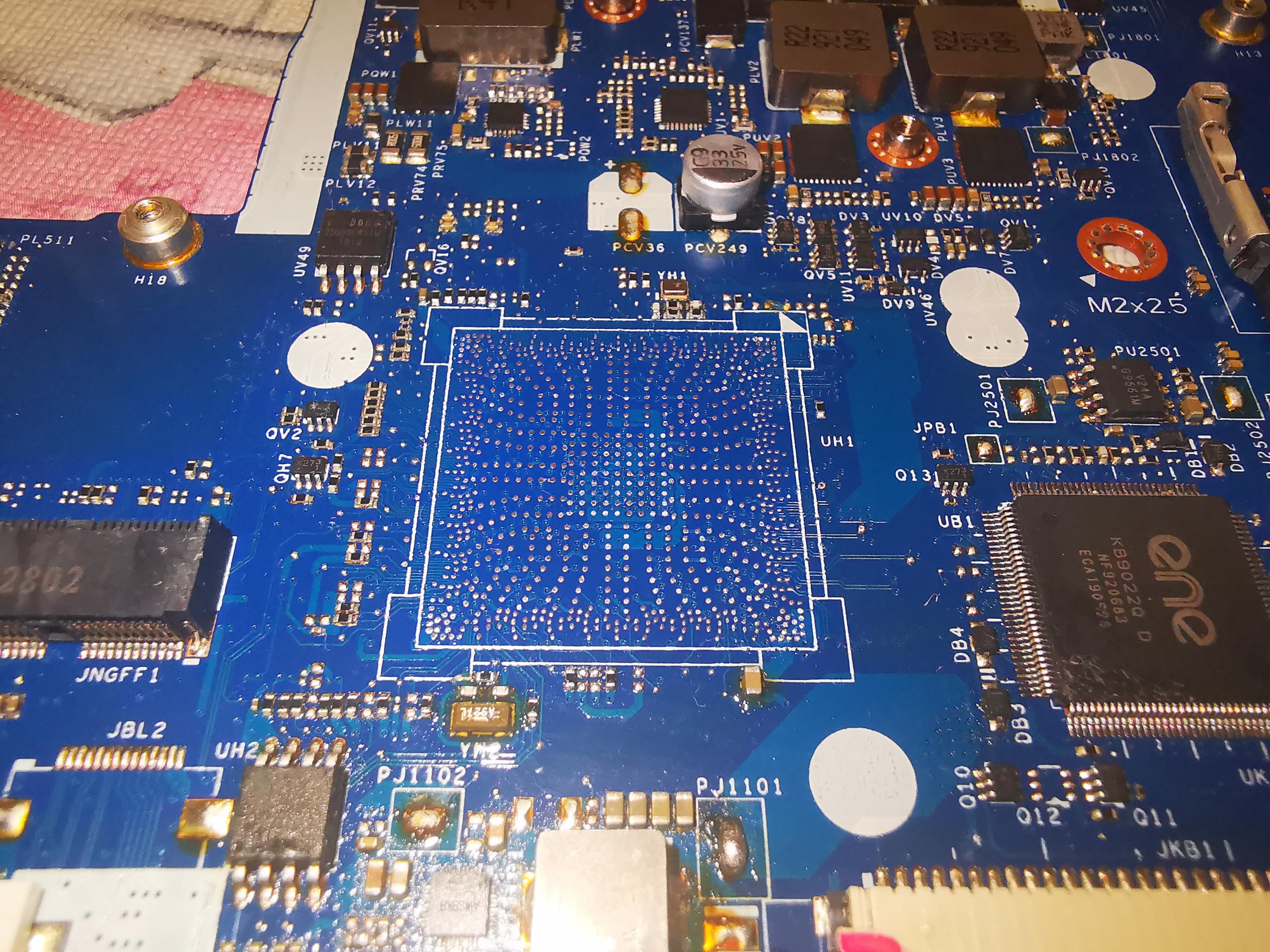

    Hi all!
    I have an acer nitro 5 notebook. The 1,05v, 1,8v and 3valwp were short.
    I injected 3v on 3v rail and the pch was hot,i desoldered it.
    The 1,8 and 1,05v are ok now, but the 3v still shorted.
    The 3v to ground resistance is 1ohm (not zero).
    Where do i find the fail?
    I have schematic and boardview too.
    Thanks!

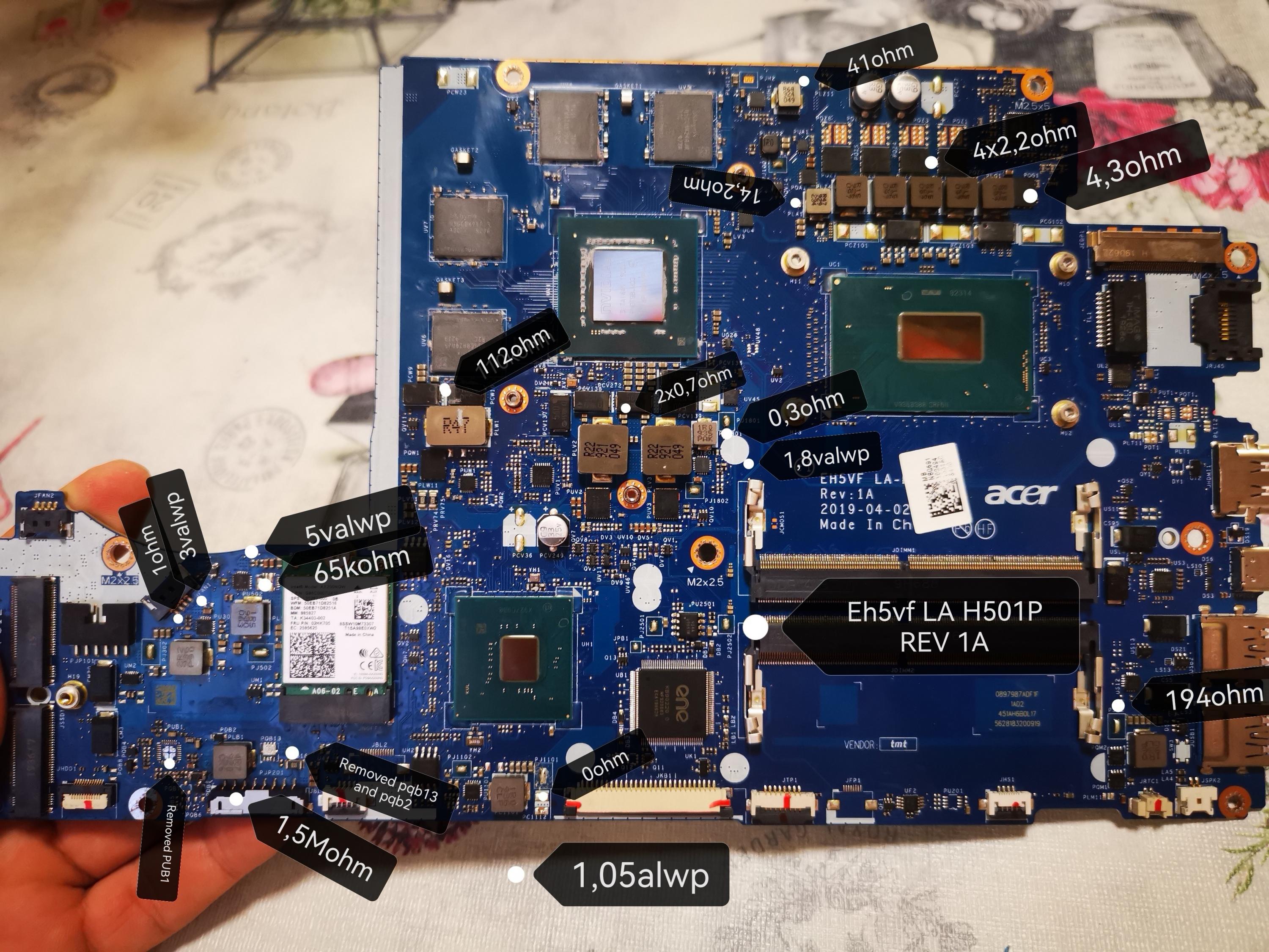

                            Sorry if I write something wrong, my English is bad. I may have said the wrong thing, or they mean it.
                            I removed and measured the following components and the resistance value did not change. I'm sure I'm missing something, but I can't figure out what.
                            I measured these:
                            Q10, Q11, Q12, Q13 next to SIO
                            PR1009 10K
                            RH3 10K
                            RH200 10K
                            RH201 10K
                            RH25 1K
                            RH26 1K
                            RH27 1K
                            RH29 100K
                            RH55 1K
                            RH56 8K2
                            RH183 10K
                            RH251 2K2
                            RH252 2K2
                            RH253 2K2
                            RH254 2K2
                            RH63 499OHM
                            RH64 499OHM
                            RH215 2K2
                            RH216 2K2
                            RH217 2K2
                            RH218 2K2
                            RB78 10K
                            R38 100K
                            R37 100K
                            I removed and measure resistance on 3valw:
                            UL1
                            UM1
                            UH2
                            UM2
                            UK1
                            UQ1
                            PCH
                            I soldered these jumpers apart:
                            PJ1001
                            JPB1 (SIO)
                            PJ2501, PJ2502
                            PJ302
                            There must be a faulty part that I missed
                            Thank you everyone!

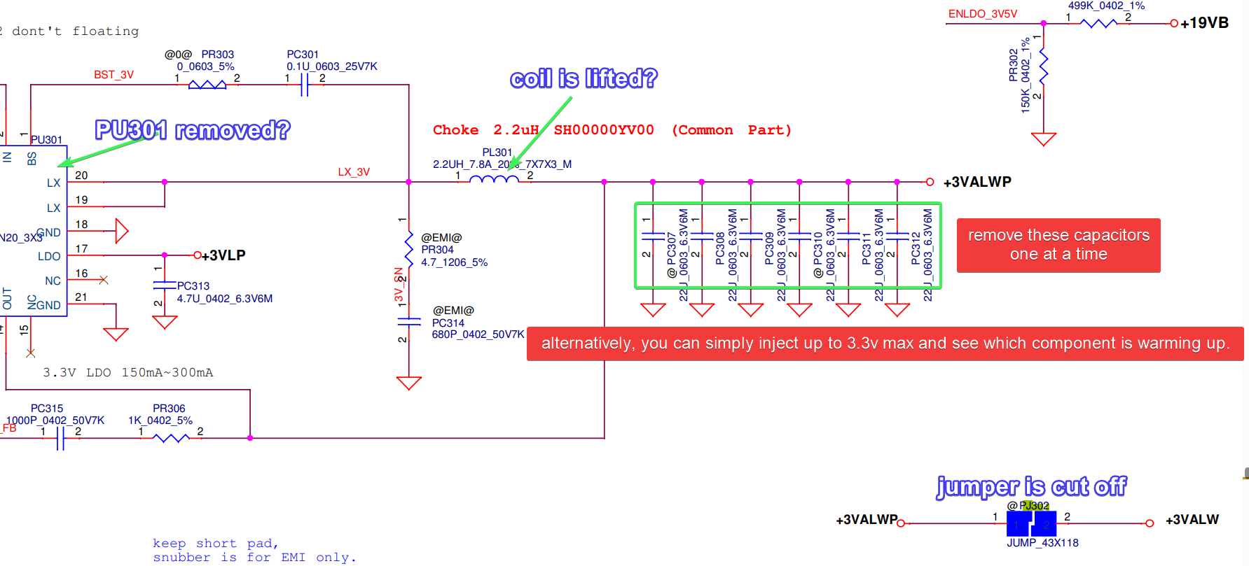

                            • whaldsz
                              • Apr 2013
                              • 395
                              • Philippines
                              Re: Acer Nitro 5 3valwp short 1ohm
                              You've done a lot!
                              You haven't removed PU301, have you? How about the capacitors prior to +3ALWP? You can also inject up to 3.3v at PL301 then check (via thermal scanner) which one is heating up.
                              • Thomas8607
                                • Feb 2021
                                • 30
                                • Hungary
                                If i've cutted the jumper between 3valwp and 3valw, then i've measured kohm range on 3valwp (on pl301), also capacitors are good.?
                                I tried lift up coil too.
                                Thank you!

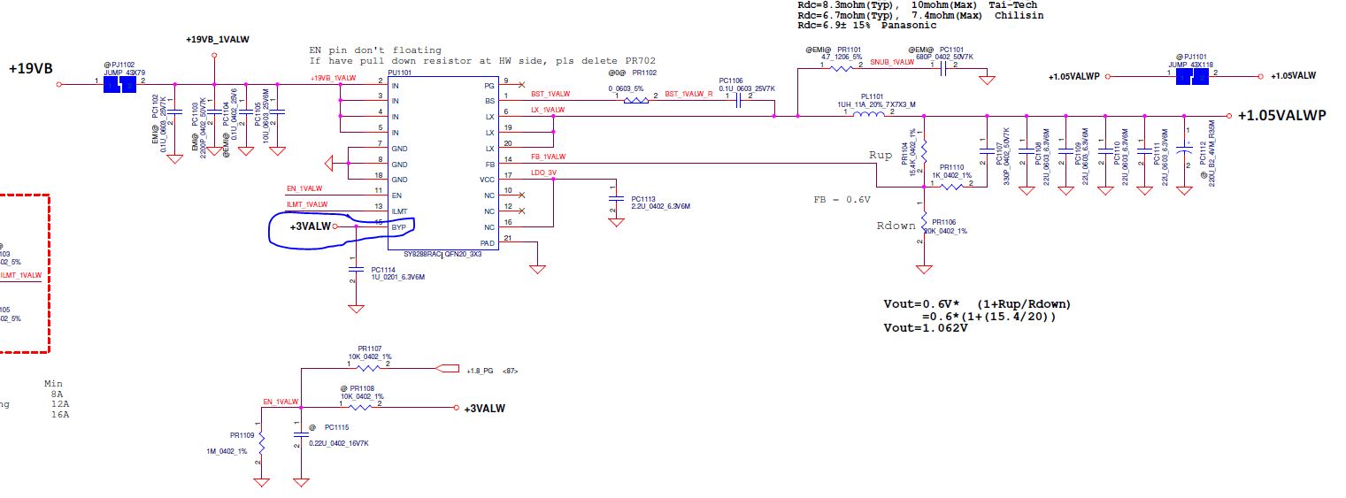

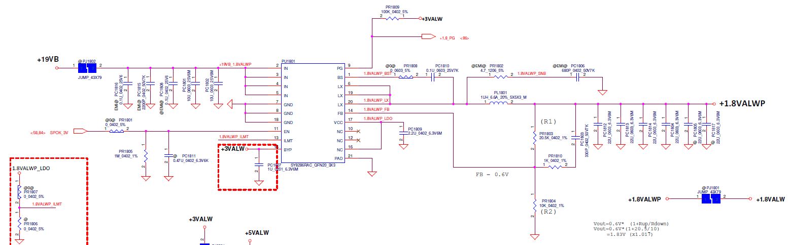

                                    Or these ICs?
                                    The PCH shorted the 1,05 and 1,8V
                                    Maybe these ics are bad?
                                    I measure a good resistance at the output of their coil, but on the byp pin is the 3valw.
