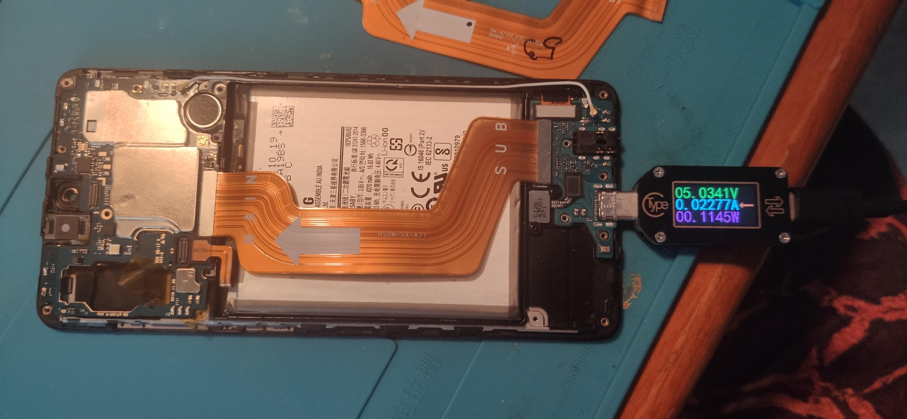

    Hi everyone, I have this phone that works fine but it doesn't charge and it doesn't connect with the pc via usb cable. I replace the flat cable and the bottom board but nothing change. It's my first time working on this kind of foult on phone. Where should I start for the troubleshooting?

    Confirm it is A715F.
    Check bad soldering on FPC 2x39 pins near battery connector.

      Re: Samsung A71 does not charge
      Test with another USB cable.
      Review the installation of the charge port board.
      Confirm the charge board is compatible with your model of logic board.
      Test with a known good battery.
          1) done
          2)the port is settle down in place normally
          3) the charge board is compatible
          4) I charged the battery with a test power supply and it charges fine
            Use a USB power meter to monitor the voltage and current draw from the adapter to this phone, while the phone should be charging.
            What are the details of the voltage and current draw in this setup?
              Here the infos
                Any chance we could get a close up picture of the connector where the flex cable (flat cable) plugs into the motherboard? I have worked on many of these devices and in so many cases is that connector. You could also test this by pressing down on the cable when trying to charge to see if it makes a difference.
                  I press down the connector with much more force and it start to charge! for now I will let it in that way, if the charge will stop again I think I'll should change the connector on mb.
