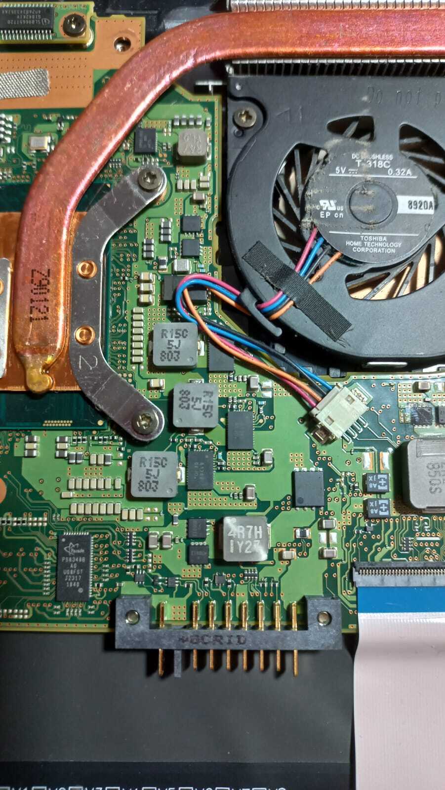

    Hi guys, just a quick note, maybe it helps. I have had 10 of those devices with the same fault.
    Symptoms: Device freezes, shuts down or gives BSOD "WHEA UNEXPECTED ERROR"
    Solution for all 10 (in my case): Replace the three CPU MOSFETs
    https://cdn.badcaps-static.com/pdfs/...8509f4fedb.pdf
    Happy repairing!

              cpu mosfet are this 3 pieces with write R15C 5J 803 ?
              • rogfanther
                • Jul 2006
                • 458
                • Brazil
                No . He means those marked as NCP 8132

                  update: a reflow is enough (did it on 70+ devices. all worked afterwards without problems)
                    You just saved my day! :-) I could safe my u758 by reflowing those three CPU mosfets!

                          Did somebody have some of directions about temperature, time etc? I will try for short time
                          • mshone
                            • Jan 2014
                            • 56
                            • serbia
                            well, update for this case. Have 13 to service. One is finished sucesfully with 380 degree C, flow 80% and about one minute each. So far, so good.
