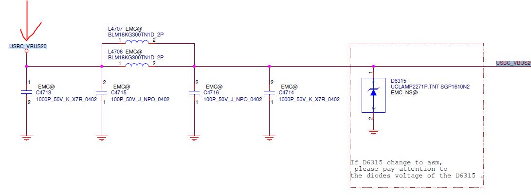

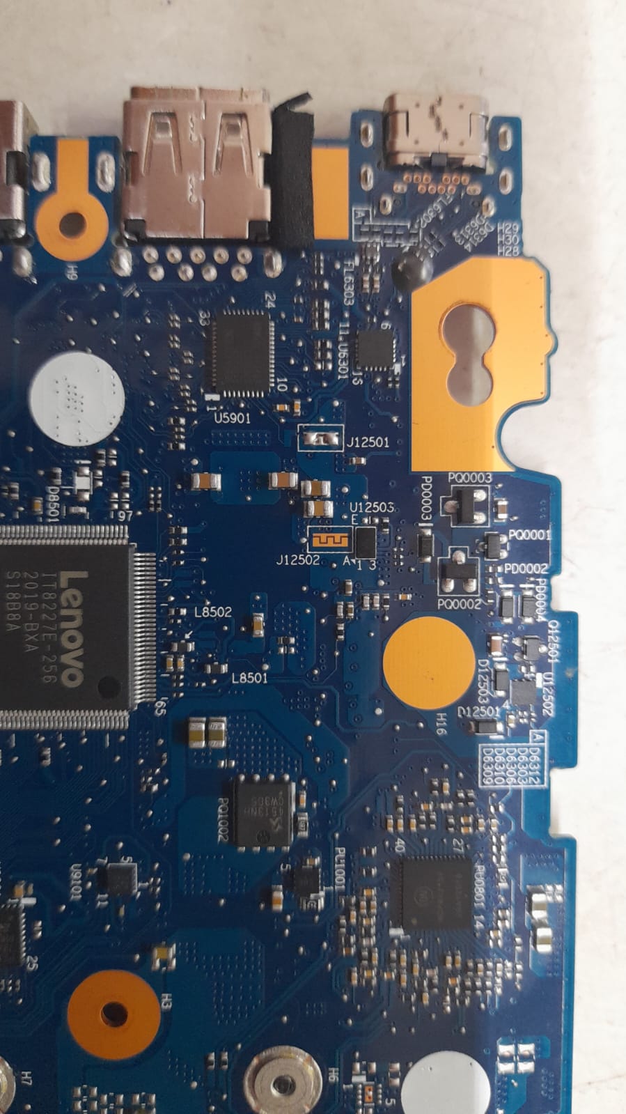

              I have measured resistance.
              black tip on gnd and red on USBC_VBUS20, mark 192.5.
              and red tip on gnd and black tip on USBC_VBUS20 and it shows 54.9 ohms.
              leave marked on a picture the point where you measured resistance

                Re: I need help with Lenovo E14 laptop. FE4A0/FE5A0 NM-C421 REV 1.0
                As expected, your VBUS is (partial) shorted. U12501, U12502 and U12503 would be my main suspects here.
