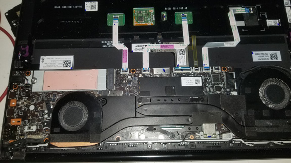

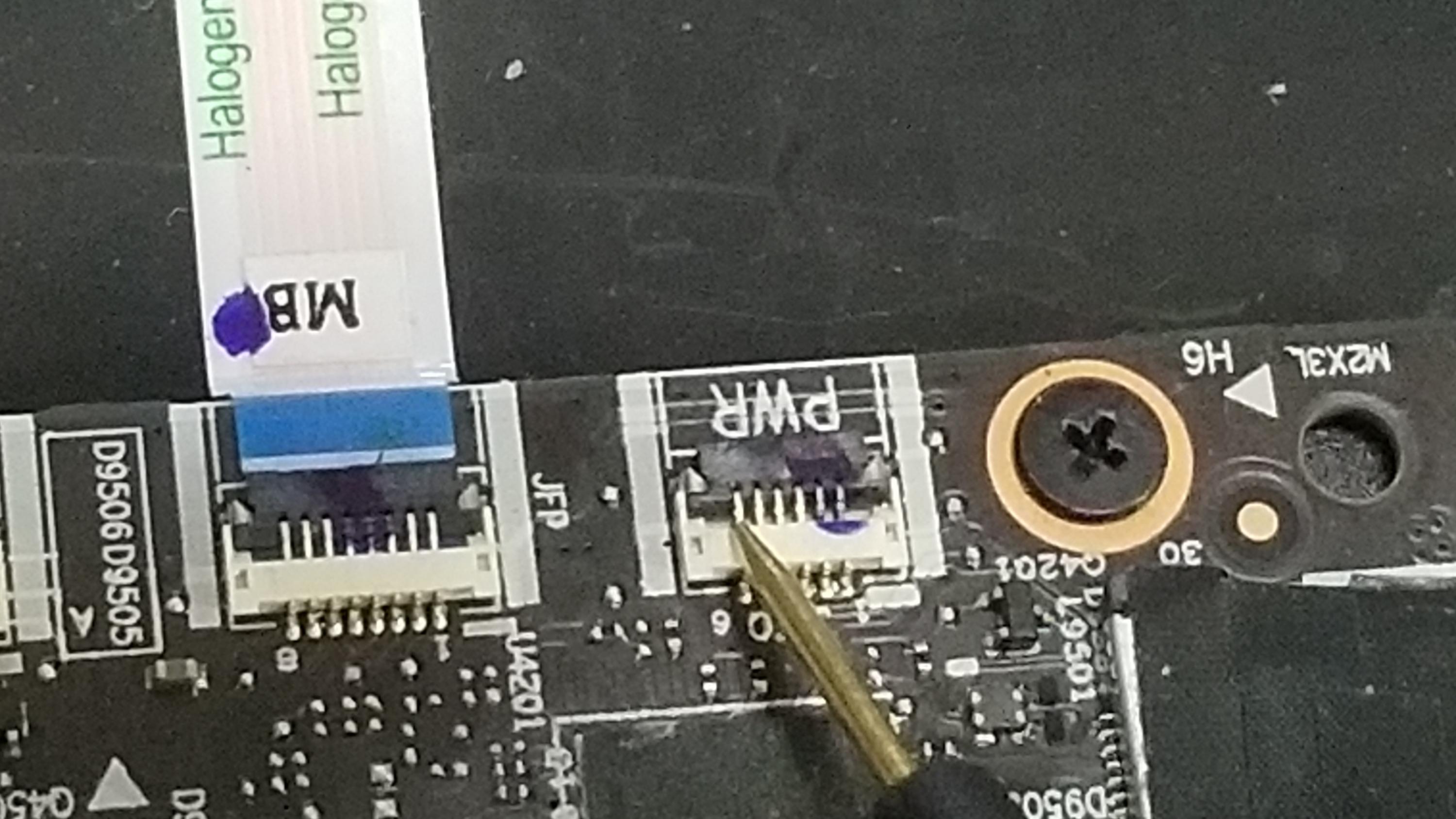

    Lenovo Yoga 9 will not power up
    it is getting 3.5v at the power button cable, was wondering if anyone knew what pins to jumper
    here is the MB
    Last edited by SMDFlea; 05-19-2023, 12:55 AM. Reason: Copied image from external to badcaps

    Re: Lenovo Yoga 9 will not power up
    You must link the schematic, but in general it's a 3.3V signal and if you want to power up the laptop it must be shorted to ground briefly to simulate pressing the power button.
