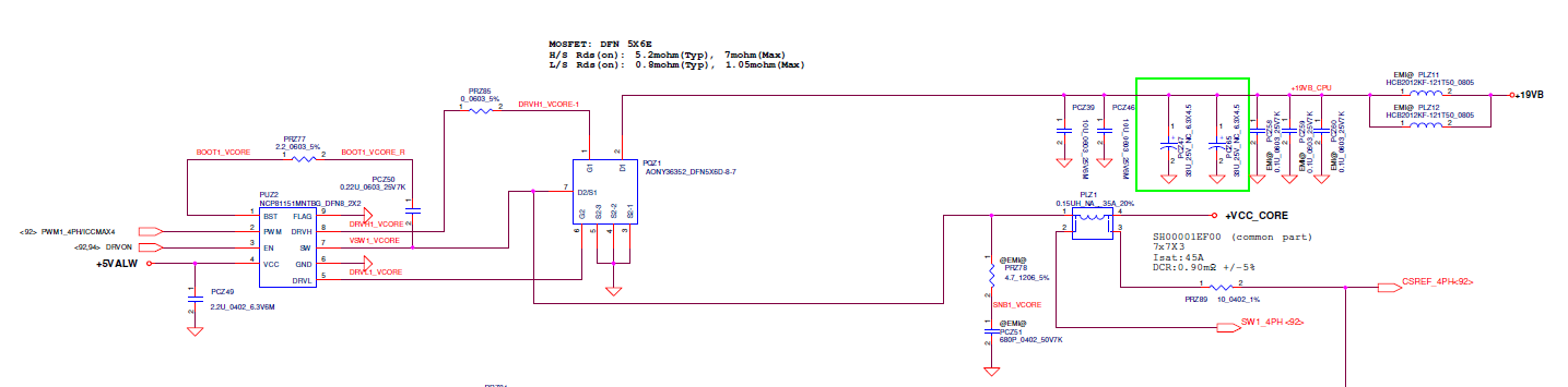

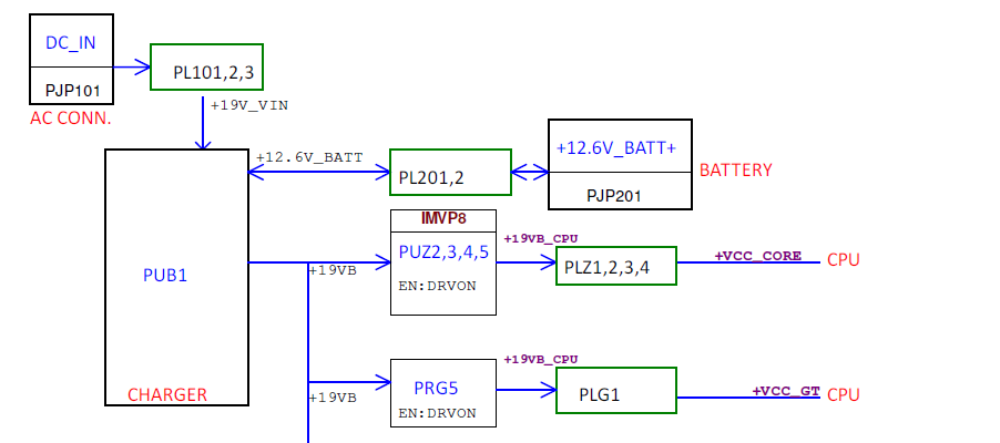

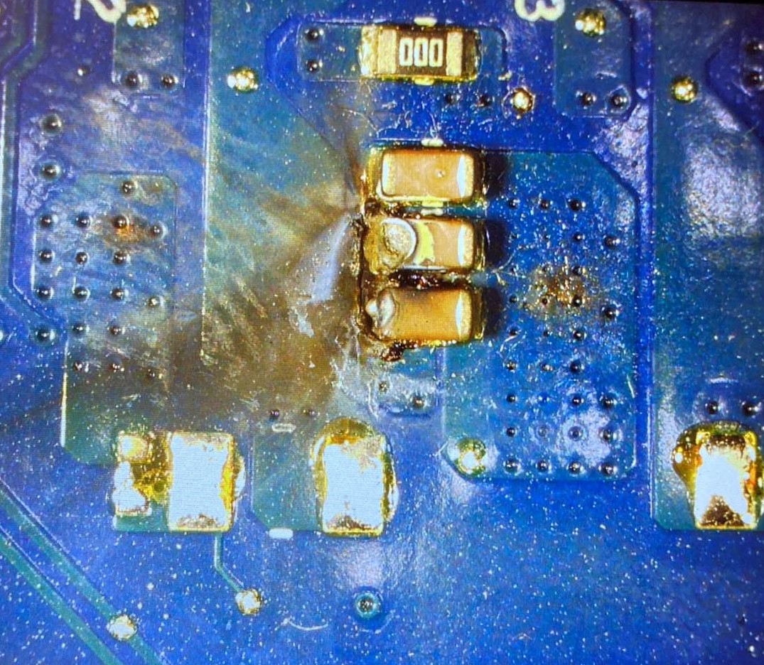

    What happened:
    Notebook crashed under load randomly. After several crashes throughout the week (after each crash it got worse and worse meaning crashes were happening more often) i found out it works just fine not plugged in AC charger only powered by battery so i was using it that way until battery was drained to 5%. When i plugged AC charger in battery wasn't charging so i restarted the machine hoping it will fix itself by some miracle . After turning it back on with my AC charger plugged in it windows showed "no battery detected/installed" down in system tray.
    Next step: I sent laptop to Acer service centre (it was already out of warranty) hoping the quote for repair will be acceptable. They couldn't figure it out tried changing the battery but to no success and sent it back to me.

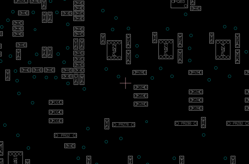

    Having some experience with repair and moderate experience in soldering SMDs i disassembled it and found blown/fried MLCC caps PCZ39 and PCZ67 under PUZ2 circuit (mosfet driver NCP81151MNTBG). I replaced damaged caps with same specs ones and repaired damaged trace tested with multimeter for shorts around repaired trace and soldered caps if i didn't messed up and everithing was fine. I reassembled it and tried powering it on but all the issues mentioned above persisted. I tought that maybe those caps were just badly soldered and for a long time they were piece by piece losing contact with board but it seems it propably wasn't the case.
    I have attached photos of fried caps and some schematics of mentioned components.
    If someone have any ideas what to check next, what to measure ill be grateful i have access to my schools equipment in my spare time, things like multimeters, oscilloscopes, microscopes, PSUs, thermal cameras etc., also feel free to correct me if im wrong somewhere. I have boardview and full schematic of board, i can attach it if needed. (wasnt really sure if it is allowed )
    Thanks for help!

                  I was using notebook for about a week without issue when it died again when playing games. No charge no power nothing. Opened it up - main power rail shorted insane. I was about to inject some low voltage to find a short with thermal camera when i saw a dodgy looking cap next to the caps i repaired (in first post). So i just unsoldered it and short was gone . Replaced it, also ofc first DCIN mosfet was destroyed again by the short so thanks god minimum order quantity was 5pcs .
                  Laptop is working again without issues. If another cap from this area (there are 4 rows of 3 caps next to each other) goes i will replace all of them as a precaution.
