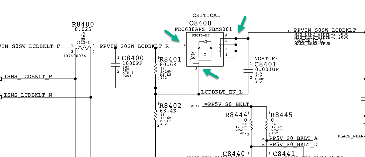

Macbook Pro 820-00840 have image no backlight
  • mon2
    • Dec 2019
    • 13835
    Re: Macbook Pro 820-00840 have image no backlight
    This is a good reading.
    Measure voltage of PPVIN_S0SW_LCDBKLTFET to ground @ F8400, pin # 1. This power rail should be the same value as PPBUS_G3H.
      pin 1 reads 12.63v
      also F7000 pin 2 reads 12.6v

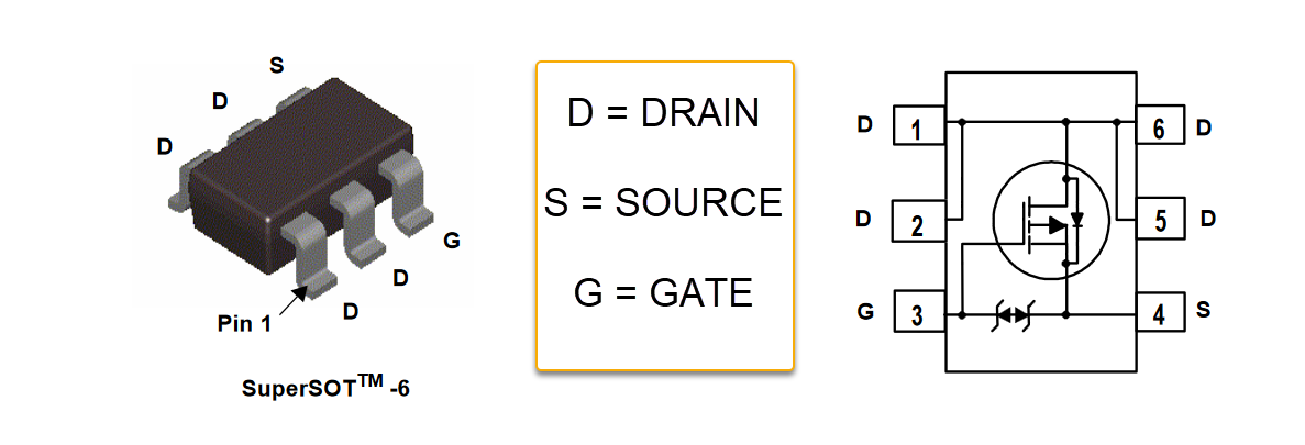

        Good. Continue to measure the voltage to ground for the enable mosfet @ Q8400. Measure with care for each of the pins on this component.
        See attached for the x-ray view of how the pins are assigned. Look for a dimple in the package which denotes pin #1 then the pin count will be in the form of a letter 'U'.
        Interested in the voltage to ground readings of the SOURCE, GATE and then DRAIN pins.
        Post each measurement.
          Ok readings as follows
          Pin 1 D = 30mV (raises from .2mv to 50mv then falls back)
          Pin 2 D = 30mV as above
          Pin 3 G = 12.6v
          Pin 4 S = 12.6v
          Pin 5 D = 30mV (raise and fall as above)
          Pin 6 D = 30mV as above
