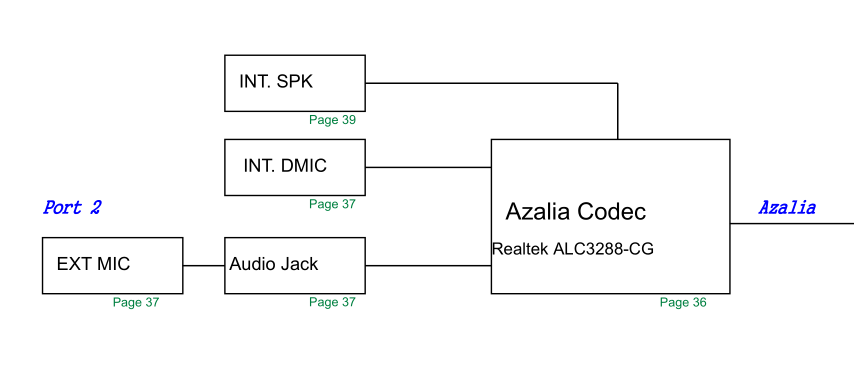

    Working on a Asus Gl504GS mainboard.
    the laptop has no sound anymore tried anything in windows but still no luck.
    the realtek driver is also not shown in windows and it doesnt even play in the BIOS sounds.(startup logo sound)
    i founded one shorted CAP near the Realtek ALC3288 IC removed but still no luck.
    what should i do next? just replace the IC ?

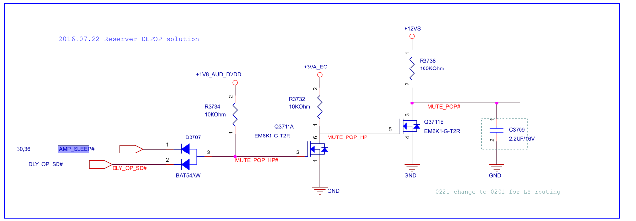

      Is the (Iggy?) Azalia codec heating up ?
      What is the history of this unit? Any liquid damage near the audio section?
      What is the voltage to ground of AMP_SLEEP# ?
      Check each of the power rails that are shown in the schematic for this device.
      Each one is present and within the proper range?

                    This is an active low signal since the net name has a '#' suffix.
                    So with a 0 volt = low digital signal, the amp is being requested to turn OFF.
                    Remove all power, meter in resistance mode, check the resistance to ground of this enable signal.
                    What is the resistance reading ? If the resistance is not a low value, then the driver of this signal is controlling this amplifier status.
                    Check your BIOS settings. Any option for audio enable / disable ?

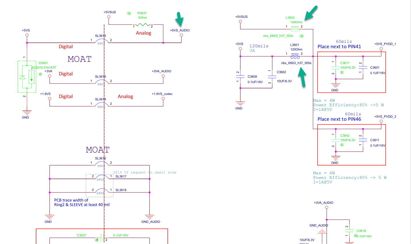

                    If the audio codec is not being detected, check the power rails for this device. Check the series ferrite beads that are used to filter the power rails that may be damaged due to an excessive current draw so now, the audio codec is not being powered so cannot be enumerated. If the codec was toasty hot, likely it is damaged and will need to be replaced.

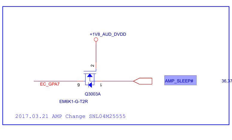

                    Check the voltage to ground measurements on Q3003A
                    PS: What is the version of your board? Is it 2.0 or 2.1 ?

                        Re: Asus GL504GS
                        Resistance of AMP-sleep : .972m
                        Q3003A : Pin 1 2.5V
                        Pin 2 : 0
                        pin 3 : 0
                        pin 4 : 2.5v
                        pin 5 : 5v
                        pin 6 : 0

                          Confirm the pin #1 voltage. It should be the same reaching the codec for amp_sleep#. If you have a voltage here at pin #1 then it should be the same at the codec.
