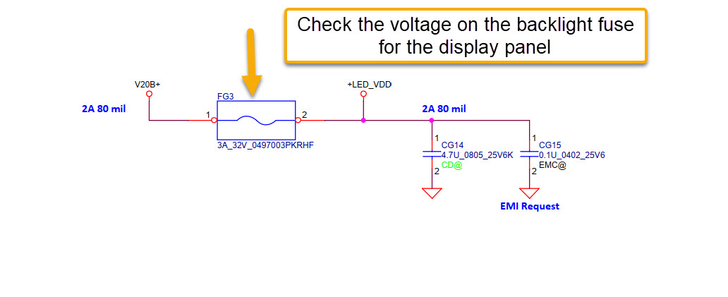

    I am having a little trouble finding a replacement fuse to repair my laptop, I need a 3a 32v 04970003 pkrhf fuse, but I have no idea where to find one. I got the part number from another thread on the forum This is my first component level repair on a laptop, normally it is on scientific instruments where I can contact my supplier at work and they find it for me.
    Could anyone point me in the right direction to find this. Thank you in advance.

    Re: Legion 5 15IMH05H NM-C911 LCD Backlight fuse
    Check Digikey or Mouser. Measure the size of the part. Probably a smd 0603 or 0805 or 1206 sized fuse. Post the link of the part before purchasing for a final review.

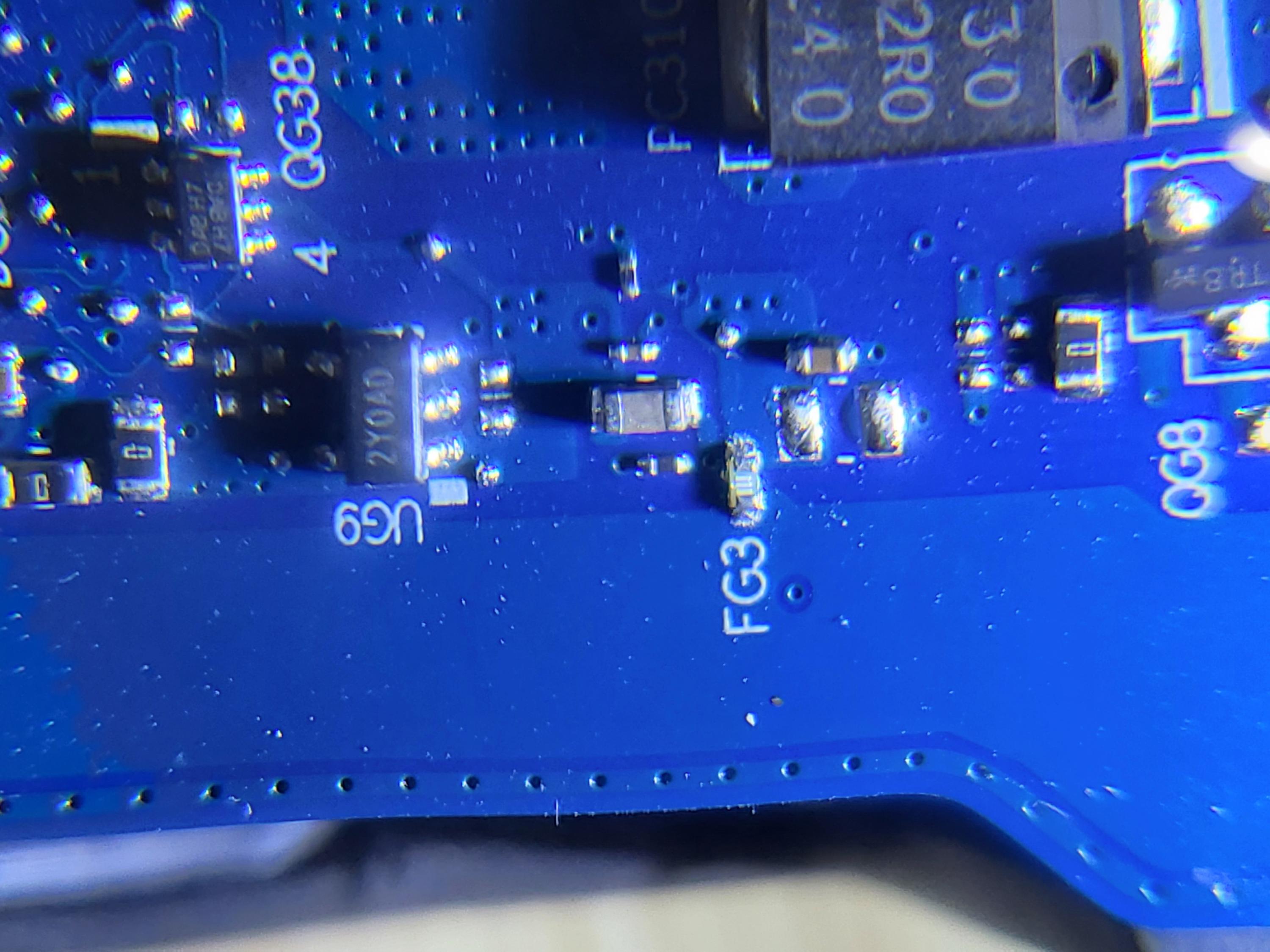

      So I measured the size of the fuse and it is about 1mm. I wish I could get a better measurement, but I only have an analog micrometer. Attached is the schematic for the board and the photo I took, it is labeled FG3.
        1mm x 0.5mm is 0402 (1005 metric) surface mount package size code.
        https://eu.mouser.com/c/circuit-prot...20Mount%20Fuse
