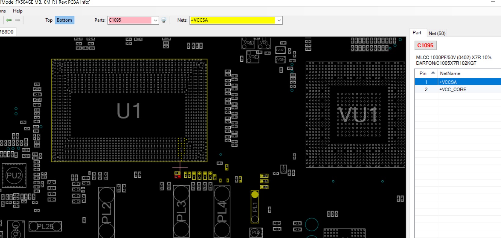

    Looking for help with DABKLGB8D0 REV.D board, laptop was in standby mode with closed lid when all fans start spinning for max speed, when I open the lid screen was black closed it again nothing happens fan still max speed, power supply disconnected and all fans stops. After that no live in laptop no led's or any reaction for power button / charger battery etc. I did some checks looks like 19v is exist, check for short to ground: located on rail +VCC CORE all shorts to ground as per photo, also next to it rail +VCCSA is all highlited short to ground on both sides of the board. Thanks in advance for any help.

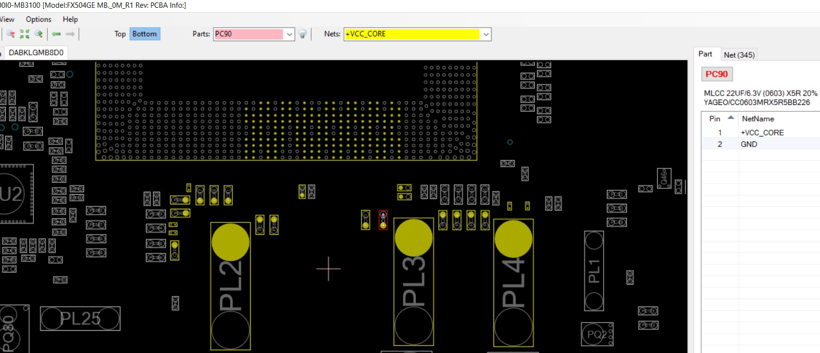

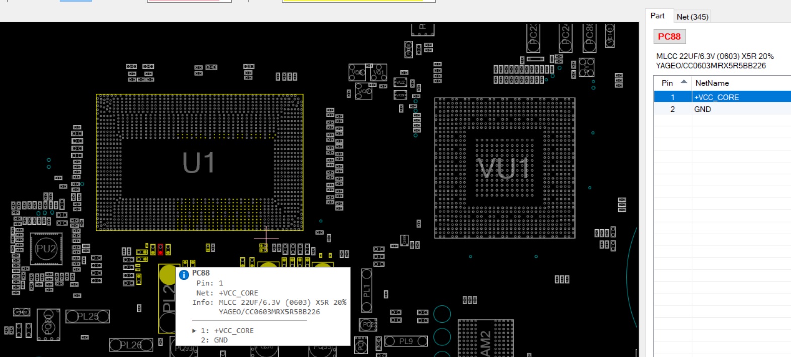

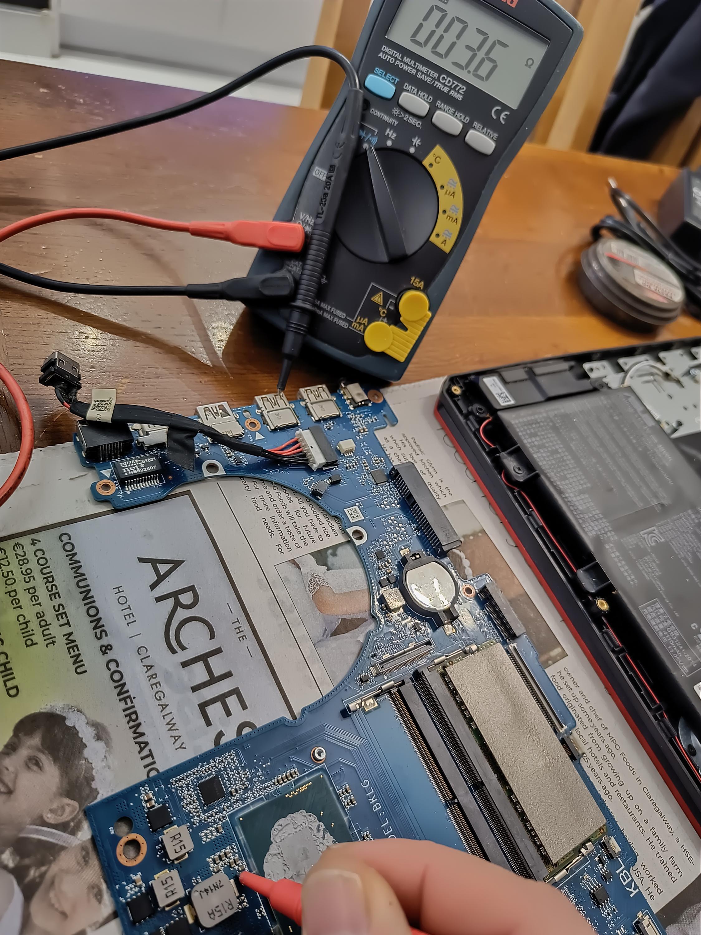

      Re: Asus TUF FX504 not powering on
      Can you please tell me where to check exactly here is reading for pc88 resistance is 003.6 Ohms
        why does everbody thinks that 3,6 ohms is a short that is no short and it is normal to get low resistance like that and less on vcc core and gpu core on newer laptops.

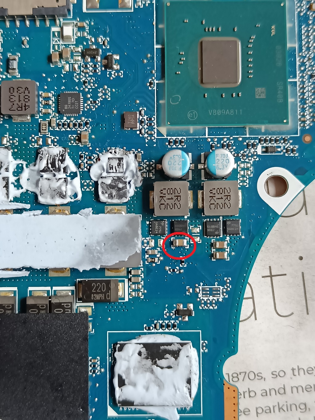

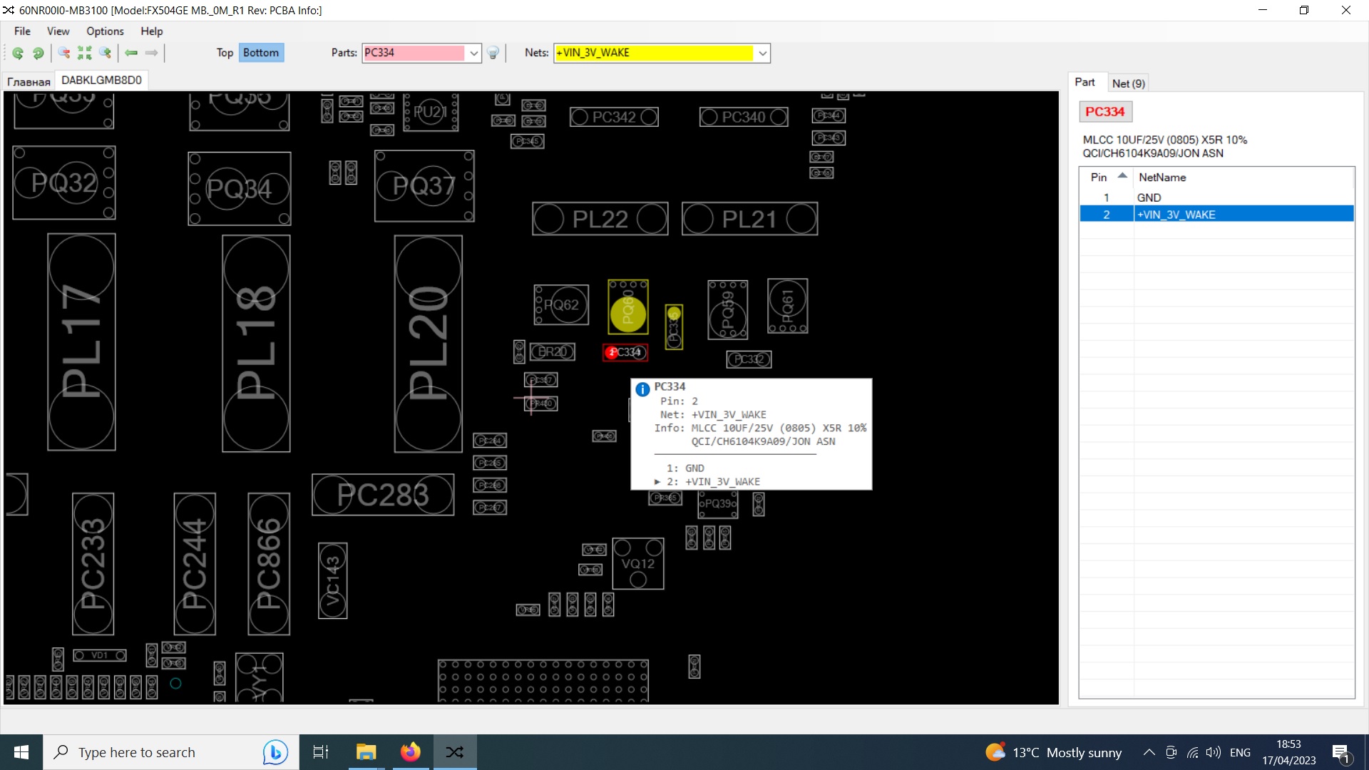

          at the time when testing PL21 and PL22 spotted excessive heat from PC334 marked in red circle, reading is 19.46V also PC332 and PC333 - 19.46V
          Any ideas what to check next ?
