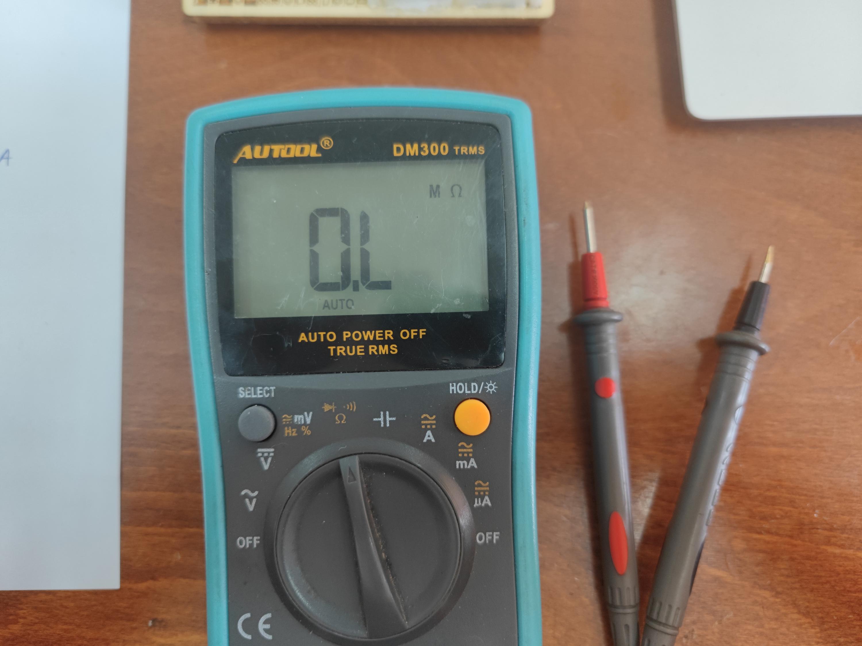

when i removed the resistor - i measured voltage on gate - pin 4 on pq201, and there was 0 volts
PQ201/202-Gate & Drain resistance-0mohm. What do you mean by that? It doesnt make any sense. If your meter is showing o, then lower the scale to 200K and check again resistance between G-D
Ok. Pin #4 is now the correct voltage to enable the DCin mosfets.
You have a fault with one of these DCin mosfets that is causing the ACDRV voltage to sink to 0 volts. The charger IC is behaving correctly.
As suggested above, remove all power and check the resistance of the DCin mosfets.
Often the 2nd mosfet gets killed and needs to be replaced. You can confirm the state with the resistance checks. If the readings are low, the mosfet is defective.
Source & drain
Source & gate
Gate & drain
