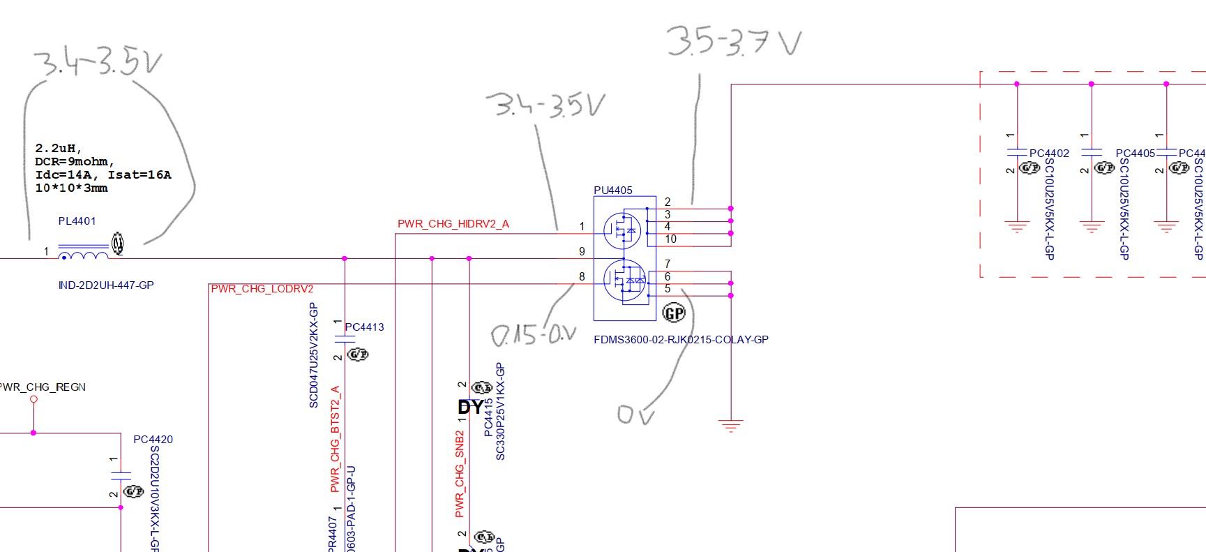

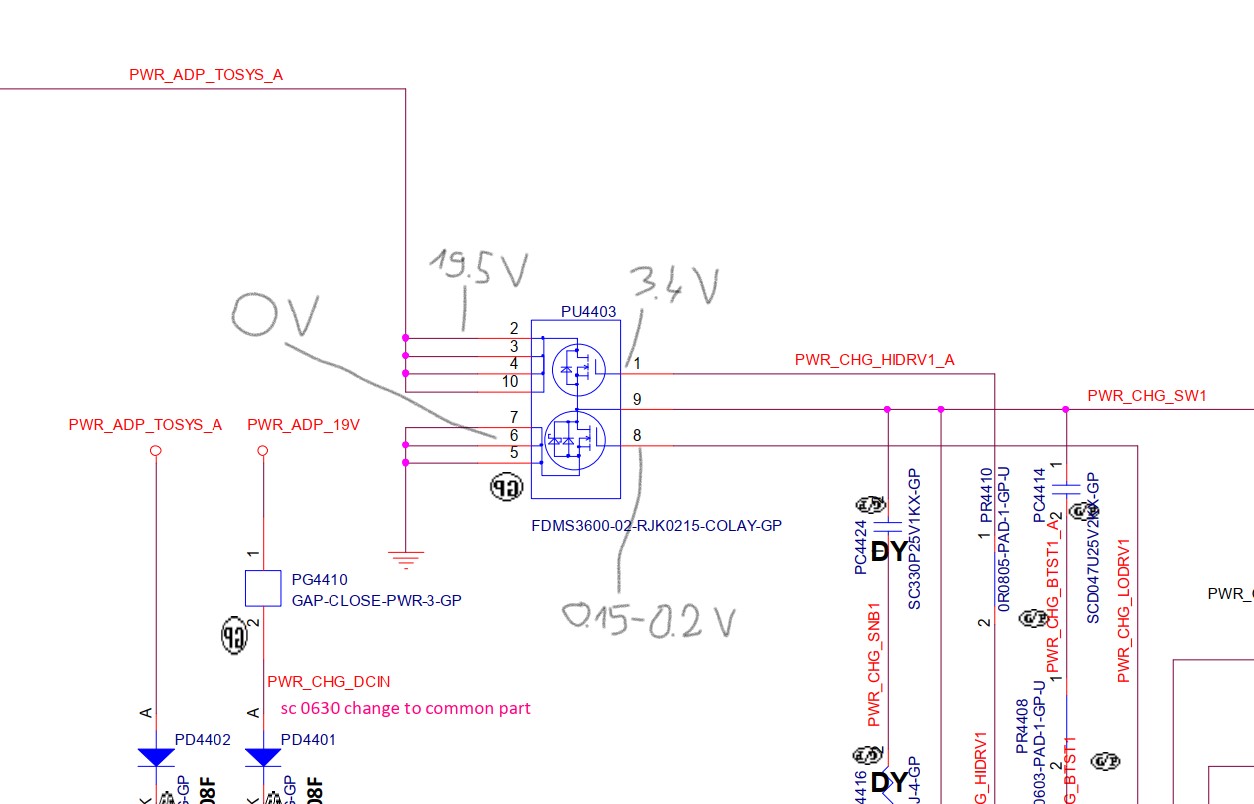

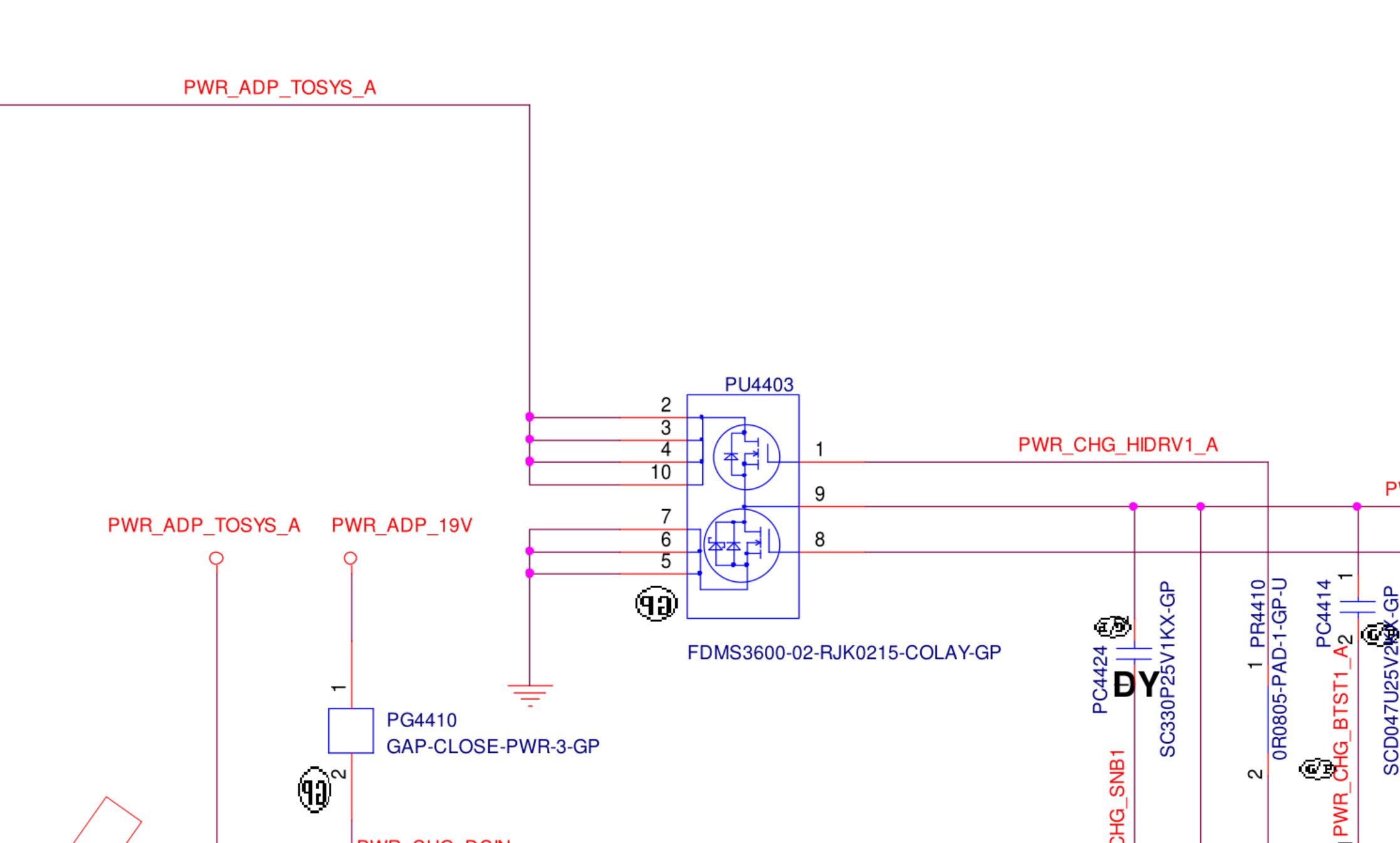

                      Resistance is fine on the main power rail.
                      Suspects are the DCin mosfets and the charger IC.
                      Remove all power. Meter in resistance mode.
                      Check the resistance of the first DCin mosfet pair. There are 2 mosfets inside this single package.
                      This is PU4403.
                      Check the HIGH side mosfet and LOW side mosfet in the same way.
                      Meter across the mosfet pins as follows:
                      Pins 2 & 1 (gate)
                      Pins 2 & 9
                      Pins 9 & 1 (gate)
                      Then repeat for the low side mosfet:
                      Pins 7 & 8 (gate)
                      Pins 7 & 9
                      Pins 9 & 8 (gate)
                      Post each measurement.
                      The next dual mosfet @ PU4405 should be checked in the same way.

                        Re: Lenovo IdeaPad Flex 5 14IIL05, ticking sound
                        PU4403
                        Pins 1-2: Mohms
                        Pins 2-9: Mohms
                        Pins 9-1: 114k
                        Pins 7-8: 100k
                        Pins 7-9: Mohms
                        Pins 9-8: Mohms
                        PU4405:
                        Pins 1-2: Mohms
                        Pins 2-9: Mohms
                        Pins 9-1: 114k
                        Pins 7-8: 101k
                        Pins 7-9: Mohms
                        Pins 9-8: Mohms
                          The resistance is low.
                          Remove the 2nd dual mosfet and then check the resistance of the 1st dual mosfet that is still on the board.
                          Check the resistance of the removed mosfet while it is on your work table.
                          Post the readings again.
                            OK, removed PU4405
                            PU4403
                            Pins 1-2: Mohms
                            Pins 2-9: Mohms
                            Pins 9-1: 114k
                            Pins 7-8: 97k
                            Pins 7-9: Mohms
                            Pins 9-8: Mohms
                            PU4405:
                            Pins 1-2: OL
                            Pins 2-9: 30k and growing
                            Pins 9-1: OL
                            Pins 7-8: OL
                            Pins 7-9: 1k and growing
                            Pins 9-8: OL
