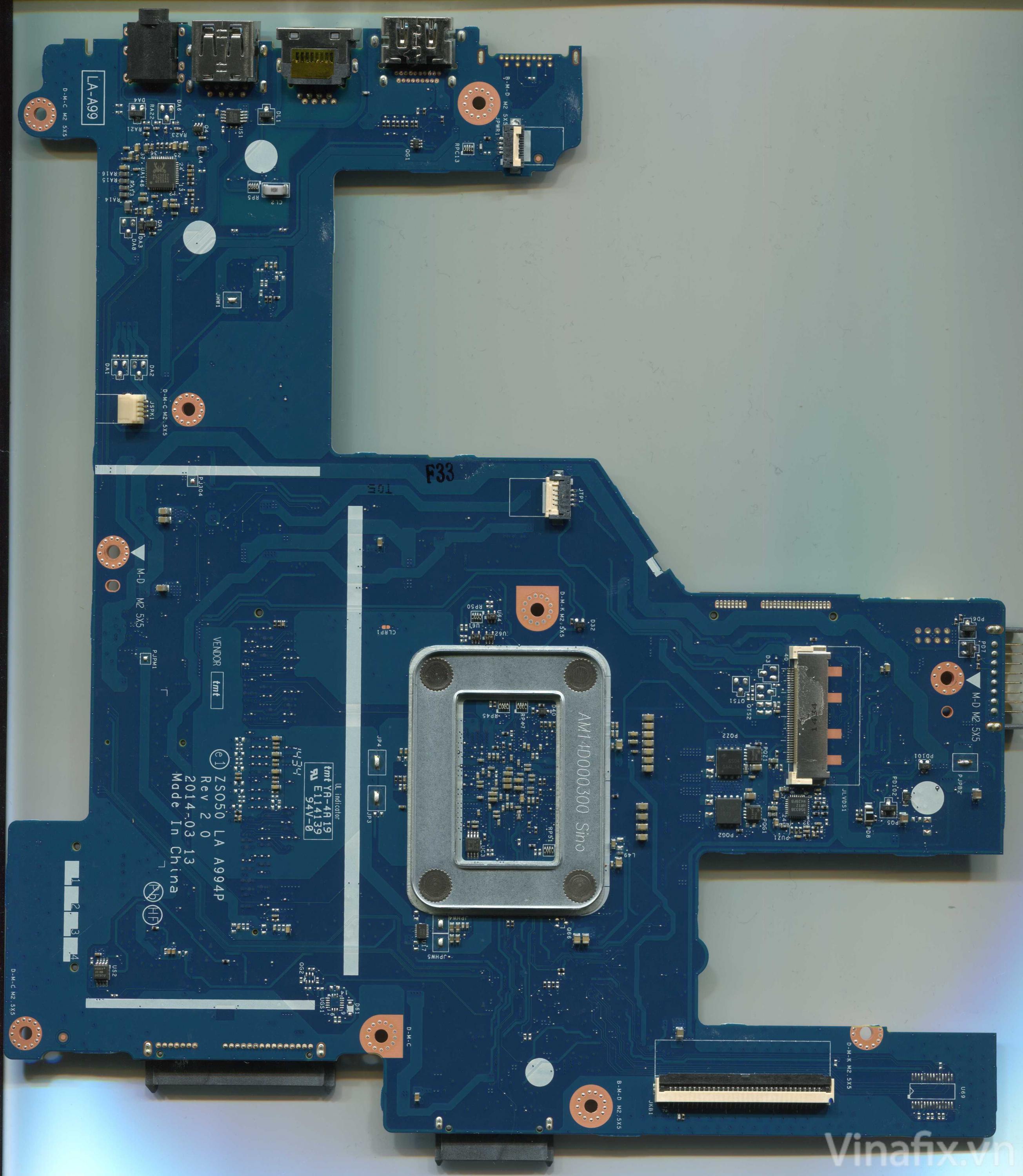

    This motherboard had a shorted cap, after repacing it the board turned on but with no display.
    I checked a few voltages in the power on sequence, among others the PLTRST# is present.
    Upon checking the LVDS connector I found that +LCDVDD is absent.
    I am totally stuck here. Guys, I need Your assistance.
    Could find the schematic for rev 2.0. But I have attached the rev 1.0 schematic and it is a bit different.
    3VS to LCDVDD converter UG1 is absent on rev 2.0 board

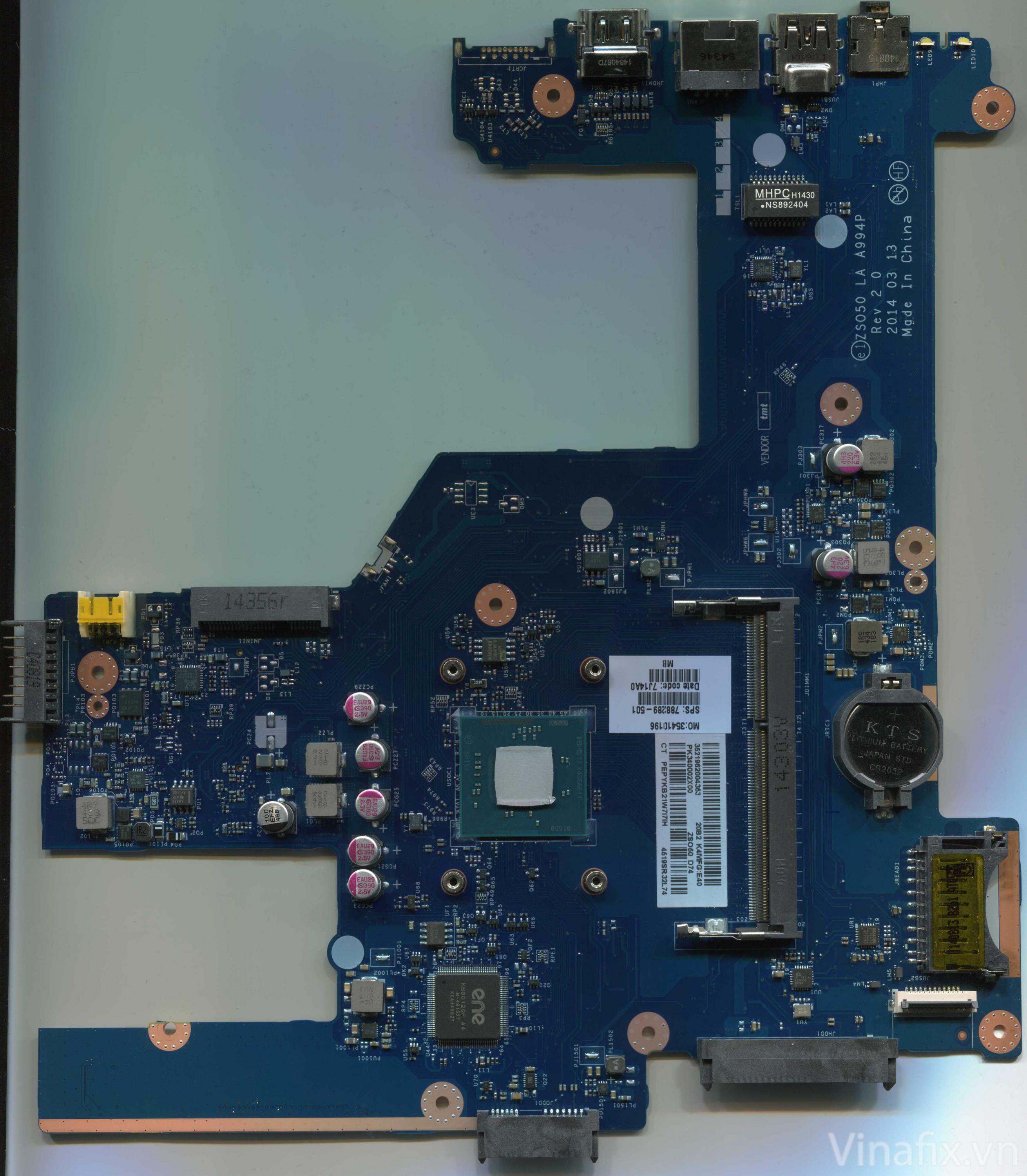

        RTD2132S is there and its Pin 15 is +DP_ENVDD which then becomes +LCDVDD. The models where RTD2132S is there wont have UG1. So probe RTD2132S or if you have spare one ,just replace it.

                    So consumption is more or less same with or without ram?? meausre voltage on UF1 mosfet on Pin1/4/8. Most likely you will not get 1.0V on pin8 and may be less voltage is present. Confirm your finding. UF1 is located near SOC.

                        UF1 is working fine. DRAMRST# present on pin30 of ram slot?
                        • Jmine
                          • Dec 2022
                          • 52
                          • Sri Lanka
                          Re: HP zso50 LA A994P rev 2.0
                          Nothing on 30th pin.
                          • mcplslg123
                            • Jun 2015
                            • 7262
                            • india
                            Replace the ram stick. make sure its DDR3-L. Look for corrossion on ram slot. Flash bios.
                            If all these steps fails, then you need to probe PUM1 ic.
                            • Jmine
                              • Dec 2022
                              • 52
                              • Sri Lanka
                              I changed the ram stick now DRAMRST is present.( 1.3v)
                              Guess I have to flash the bios now.
                              • mcplslg123
                                • Jun 2015
                                • 7262
                                • india
                                Good. Now repeat the measurements at post#8. yes, flash known good bios.
