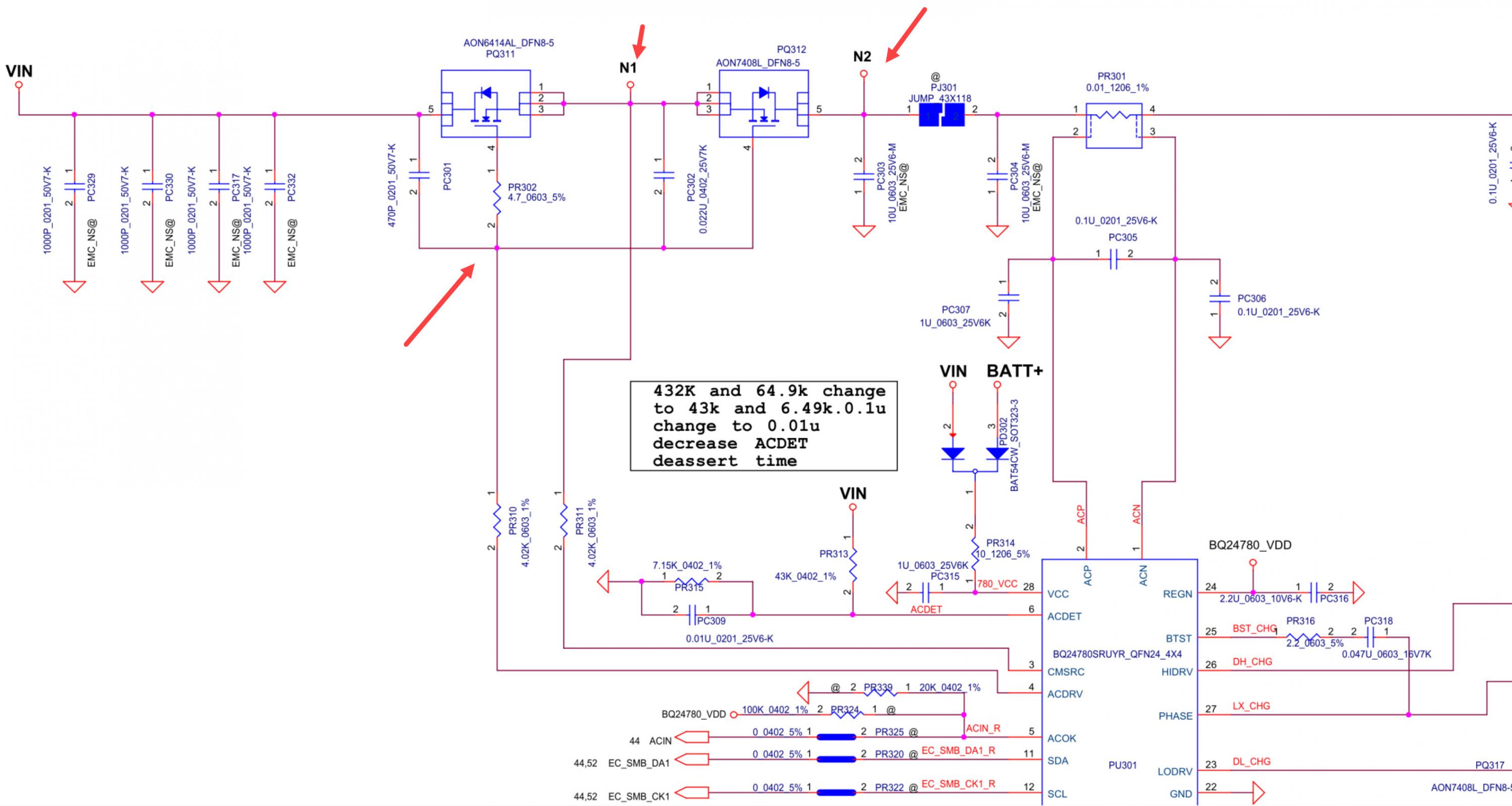

    only red light brief flash (periodcally) without battery, with battery white light 4 sec
    +5VALW and 3VALW turns off
    no shorts found
    any ideas?

    Review the DCin mosfets.
    Measure the voltages on each of the points in the attached.
    ACDRV should be ~25 volts to enable the DCin mosfets.

      Re: Nm-a981
      20v
      26v
      20v

        "No shorts found" is a little less in my opinion. What's the resistance to GND of +5VALW, +3VALW, 1.8VALW and +1.0VALW to start with

            +5VALW >20k
            +3VALW >10k
            +1.8VALW > 40k
            +1.0VALW 53ohm
            notice that EC_ON goes on and off

              Does 1.8VALW and 1.0V ALW comes up too, or only 3VALW and 5VALW?

                Re: Nm-a981
                comes up just like 3VALW and 5VALW

                  Well, then go ahead, and check the coils/power rails which were not mentioned before, the same way. so we maybe get a idea where it is Stuck.

                    Re: Nm-a981
                    found nothing of interest

                      check bios/ec firmware
