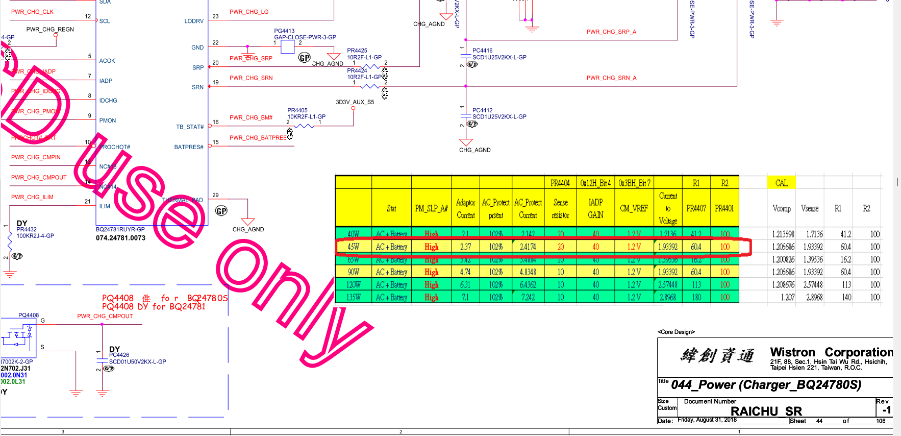

acer a314-41 dead
  • salawayon
    • Nov 2012
    • 575
    • philippines
    acer a314-41 dead
    board info:
    RAICHU_SR
    18762-1448
    @ PU4301 (SM4378):
    D - 19v
    S - 0v
    G - 0v
    @ BQ24781:
    pin28 - 19v
    4 - 0v
    can't find any short circuit. tried already changing BQ24781 with BQ24780s. i tried to bypass PU4301 and PU4401 and the unit will power up with display.
    anyone could share a schematics for this unit?

    Re: acer a314-41 dead
    Post all voltage readings to ground of the charger IC with the adapter connected.

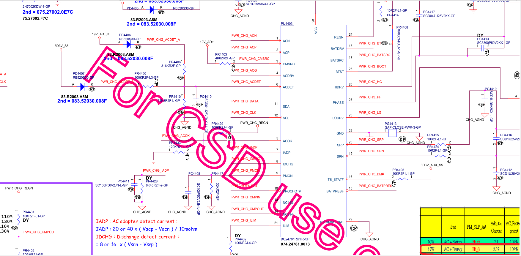

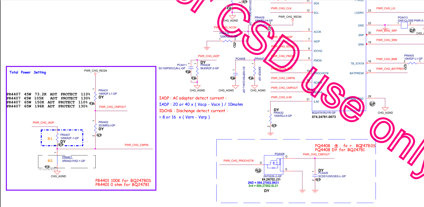

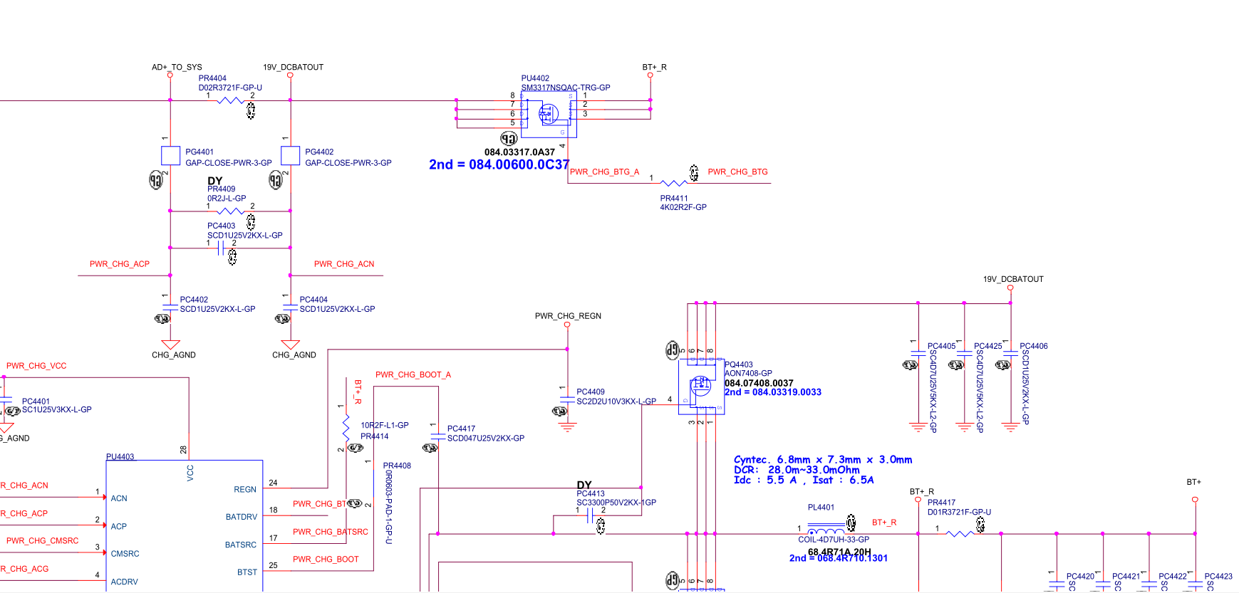

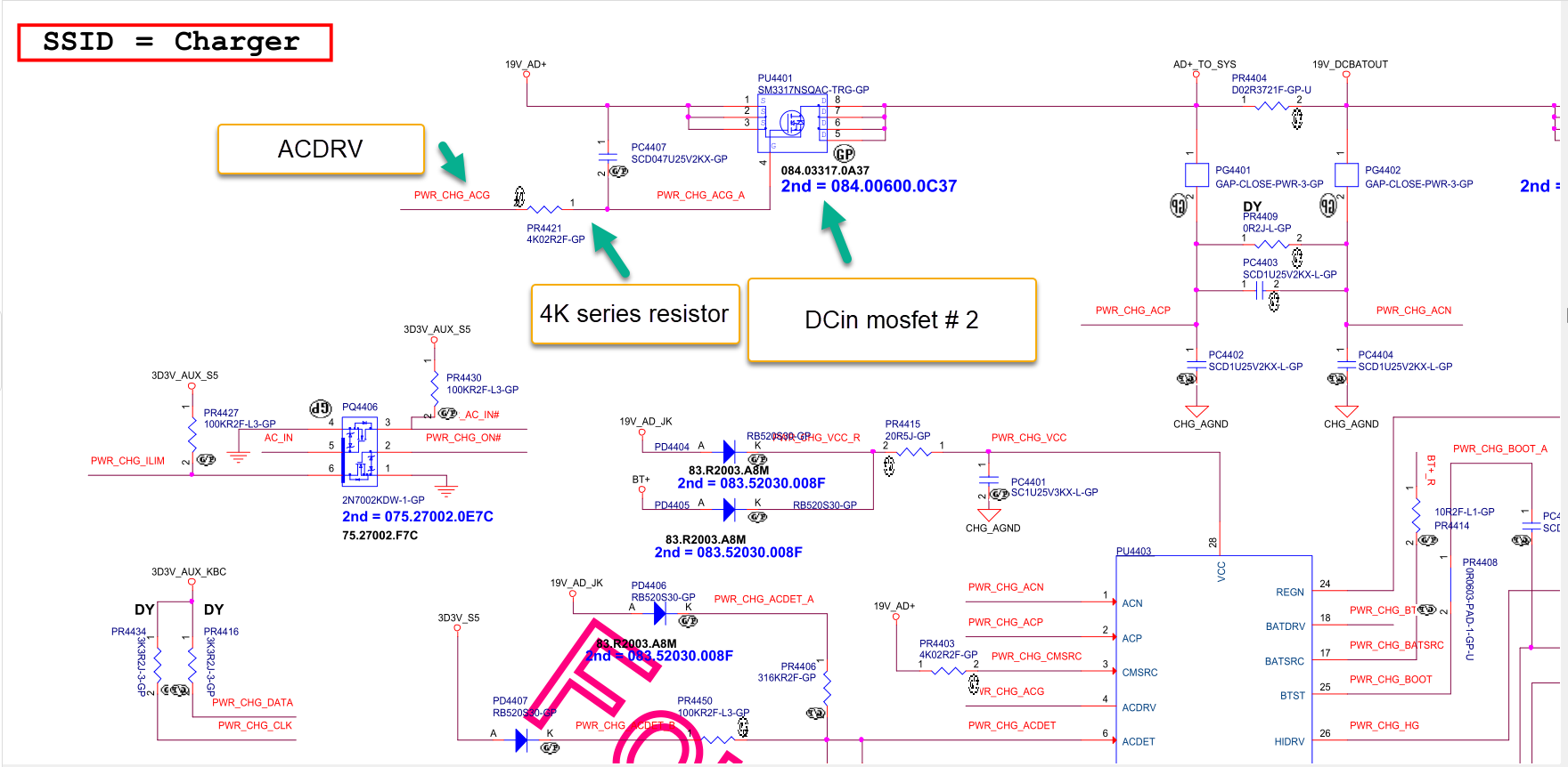

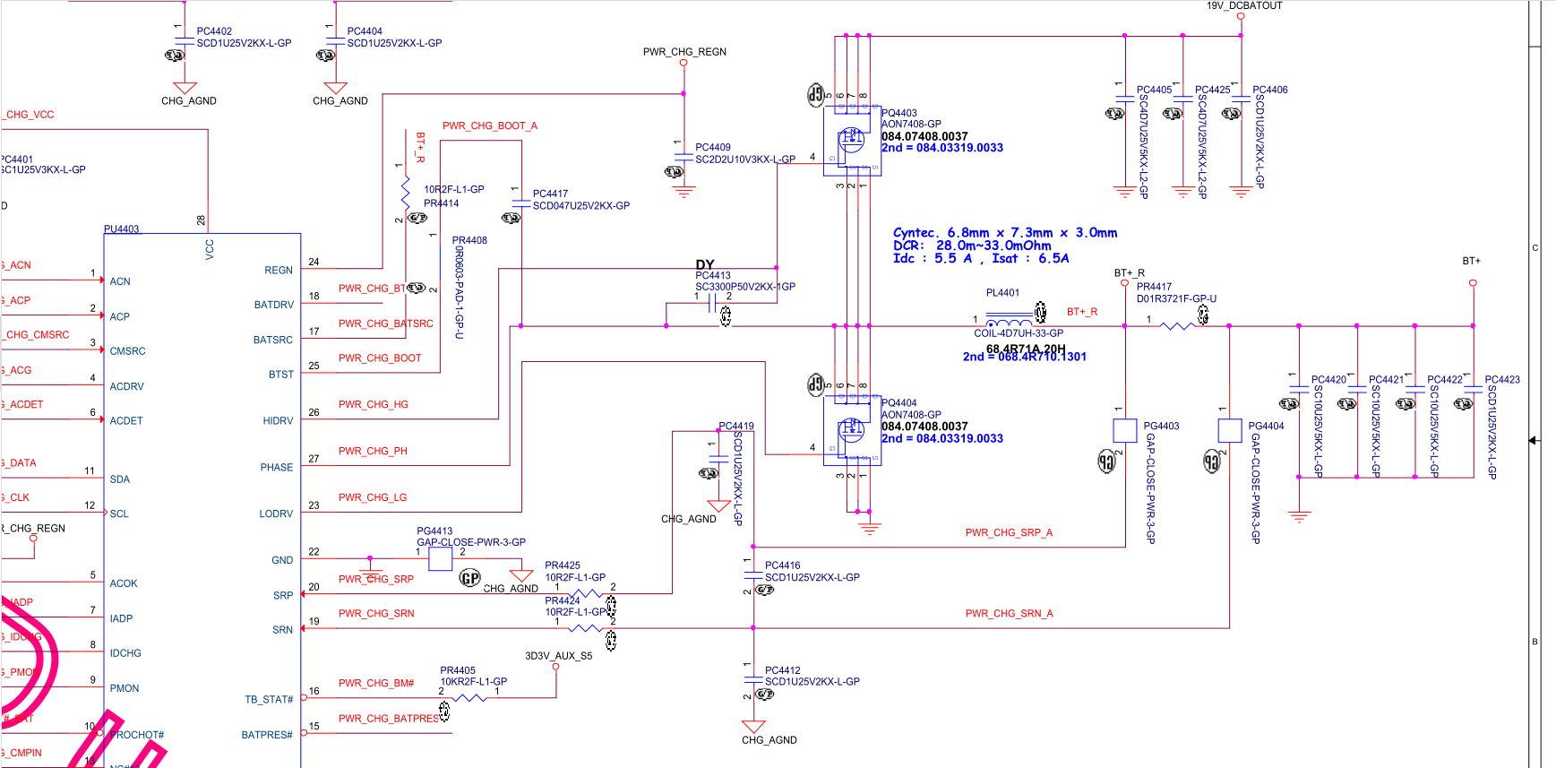

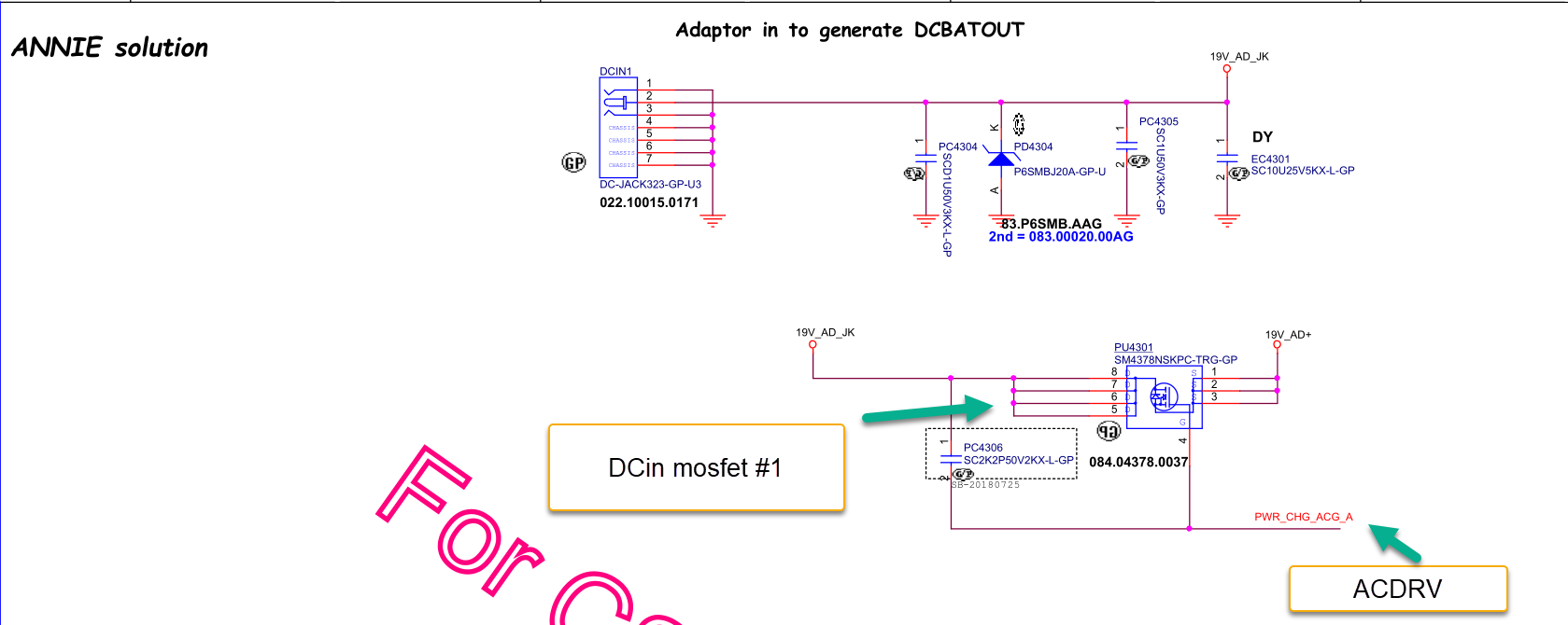

        Hi. Did you locate the schematics? I have them but it is tied to a paid service so let me share the relevant portions of this schematic.
        The charger IC is a common BQ series from TI. Respectively, TI chargers like to use N-channel mosfets.
        There are 2 x DCin mosfets (as per the sticky article above by @Piernov - a must read).
        Often, faults like yours are linked to the 2nd DCin mosfet = PU4401.
        The ACDRV drive voltage to enable the 2 x DCin mosfets should be ~25 volts if all is normal.
        This value is based on AC ADAPTER voltage + REGN pin voltage = 19v + 6v = 25 volts.
        There is a series resistor of ~4k @ PR4421 that drives the 2 x DCin mosfet's gate pin.
        As a test, you can remove this part but do not lose it. Then power up again.
        Do you now see the ACDRV pin @ ~25 volts ? See attached.
        PS: Very late for you so proceed with caution.
          thank you for your inputs. i already solved the problem before i even read your reply. i just replaced PU4301 just by trial and error cause i can't detect any short circuit on PU4301.
          resistance between pins @ PU4301:
          D-S = 2.362Mohms
          D-G = 5.2Mohms
          S-G = 2Mohms
          when applying positive supply at G pin, PU4301 won't function.
