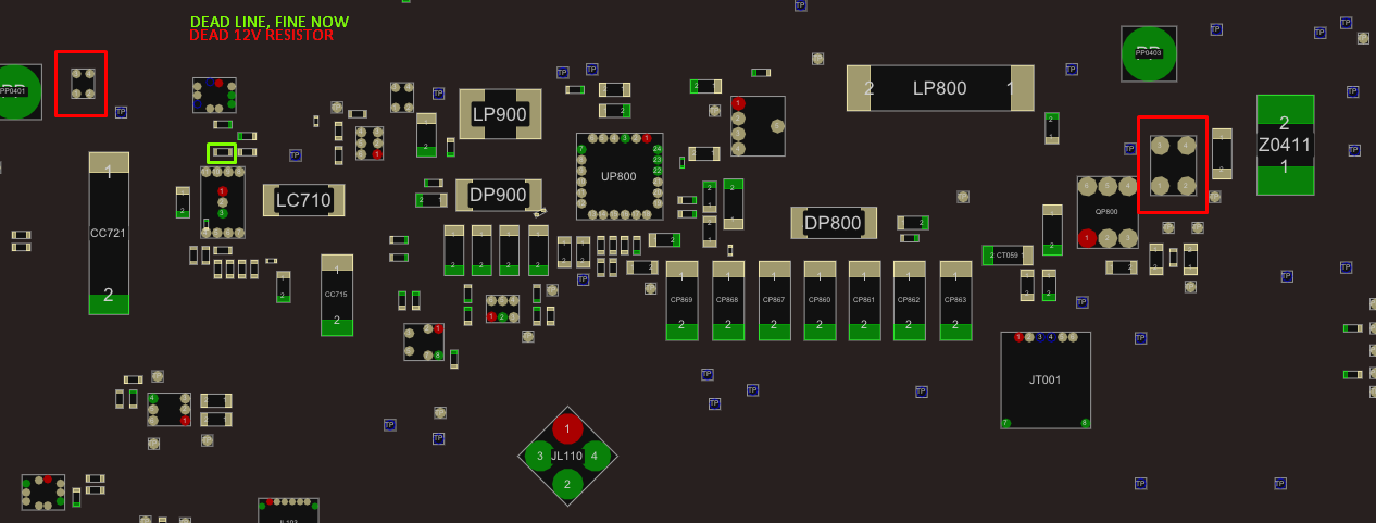

    I face a problem with this motherboard.
    Working perfectly in HDMI.
    First problem liquid damage.
    Problems were on RD560 and RP800, these 12V with sense was dead.
    And pin 9 on UC710 too.
    RD560, RP800, UC710, UD560, UP800 has been replaced.
    Now, on the screen (JP600) I have :
    PP3V3_SW_LCD_CONN : 3V
    EDP_PANEL_1V8_EN : 1.8V
    PP5V_SW_LCD_CONN : 5V
    PP5V_CAM : 5V
    LPDP_INT_HPD : 0V
    PPVOUT_LCDBKLT : 0V
    I2C_BKLT_SDA : Have DATA with oscilloscope
    I2C_BKLT_SCL : Have CLOCK with oscilloscope
    On the UP800, pin 17 : BKLT_EN_R, I have 0V too.
    I did a bridge on this pin, and I had PPVOUT_LCDBKLT : 50V.
    No backlight visible on the screen with PPVOUT_LCDBKLT at 50V.
    I tried my screen on another A2338, this screen seems to have lines but works perfectly.
    Now, I'm short of ideas.
    If some of you have a new one to help

    Backlight is a function of the LCD being detected and the lid sensor able to sense that the display is open.
    Check the logic level of the lid status. This is from a hall effect sensor in the trackpad.

      Also 50v is too high for the backlight voltage. Be sure the backlight led strips are connected at the lcd display connector.

        Re: A2338 820-02020 No backlight
        Hi thanks for you reply.
        IPD_LID_OPEN_1V8 is 1.8V
        Screen connected and close, in HDMI I have the log on the session if I open the screen, it desapear and print the background wallpaper only.
        LID is working great so ?
        For the 50V, the 2 connector on the board of the screen are connected too.
