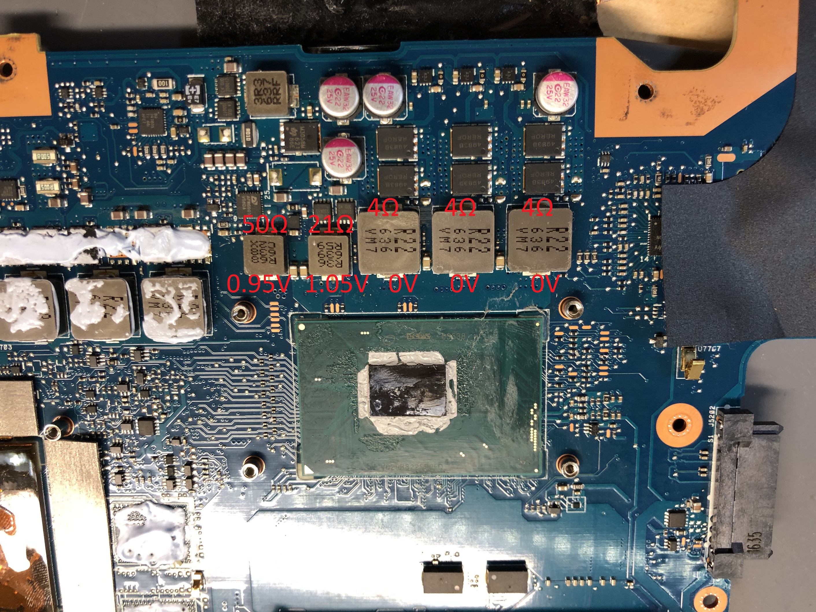

    Hey everyone.
    Long story short, another dead no power ROG with shorted chip7.
    Removed chip7, short gone, ordered a new one and replaced.
    All resistances ok.
    Now machine takes power, turns on the power leds, and stuck at 600ma.
    All rails are present except Vccore.
    All rails seem to have a decent resistance value, but im inclined to say its a dead CPU no?

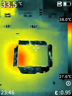

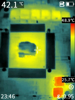

    Check photos with values and also thermal pic of the cpu and gpu.
    GPU gets warm, but normal since its powered.
    I also leave here the original bios dump, in case its usefull for someone.
    PN:60NB0D60-MB1013 G752VM
    board model: G752VS rev 2.1 BIOS -> https://www.badcaps.net/forum/showthread.php?p=1213856
    RIP cpu right?
    Another opinion is much appreciated!
    Cheers guys

        Re: Asus ROG G752VM - Chip7 replaced no VCCcore
        On vcore coils 4 ohm should be fine... Check alert pins near ncp81205...probably svidalert is 0V?
            yeah those 4 ohm were my hope!
            On PWM ic I have
            pin 43 EN - 3.36V
            Pin 41 P_SVID_ALERT - 0.076V ( 550 ohm resistance)
            RIP cpu right?
