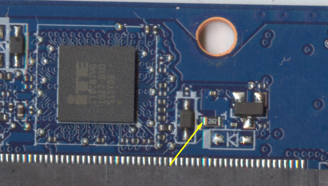

          Re: HP Pavilion 15-cs1042ng - unknown 3.3/5.0V LDO
          Originally posted by loopster View Post
          You got the same laptop? Would it be safe to connect the adapter and measure the voltage with the QM3002M mosfet off the board? It's not turning on anyway?
          no it's just the picture of your MB from Internet. Remove this resistor and measure voltage again
            Are you referring to this thread to check whether the EC is pulling the voltage down
            to 1V on the 2.2Ohm resistor? Should be 3V or 3.3, right?

                  I also borrowed a linear power supply from work, and now injected 1V with limited current on the 2.2Ohms resistor. Current draw is 0.35A, which is quite (in fact very) high I think. Since there is supposed to be 3.3 there, is there any objection to injecting 3.3V with say 1A (or more, as the case may be) to see whats causing the current, i.e. gets warm/hot?
                    Well, i have to admit that i was likely wrong before.
                    Please check resistance to GND at the same point. We probably have a (partial) shorted VREG3 (+3VPCU). So yeah, in this case the EC does not work properly. It is just a bit confusing, that +3VALW and +5VALW are up anyway. It seems they're enabled from somewhere else.
                    However, if it turns out to be the truth, you are 99% "just" dealing with a dead Embedded Controller. check on which side of the resistor you have the lowest resistance then.

                      #30
                      Thanks for your reply. Resistance is around 960 Ohm on both sides of the resistor.
                      There is no discernable difference.
                      Edit: on further measurements, it's a teeny bit higher on the left side, maybe around 2 to 3 Ohms.
                        #31
                        This would fit to my actual assumption, although 960 Ohms would be the highest partial short, I've ever seen so far.
                        So, lift the 2.2Ohms resistor from at least one pad and try to not lose it. Now plug the charger and see whether you get stable 3.3V on the left side.
                        If so, inject into the right side again and check whether the EC is noticeable getting warm.

                          #32
                          I removed the 2.2Ohms resistor, and the voltage now measures 0.86V on the left pad
                          and 1.03V on the right. Weird, nothing I can wrap my head around :-)
                            #33
                            This did not went like expected, again.
                            If you still have the bench PSU available, inject into both sides, like before and share how much the rail takes on each side. When you're done, you can solder the resistor back in place.

                              #34
                              Zilch on the left pad, 0.36A on the right. Resistance to ground on the left in the Megohms,
                              on the right I get nonsensical readings depending on the measurement range I choose. Took two different multimeters. From 60Ohms up to 5k? I am currently recharging the batteries for both to see whether they read bullshit due to low charge...
                                #35
                                Regarding the schematics of a similar device, at the right of the 2.2Ohms resistor is +3VPCU_KBC while on the left is +3VPCU, so maybe we're dealing with multiple faults here but from my understanding at least the EC has a serious issue and should be replaced.
                                I have no clue why +3VPCU still doesn't reach its proper voltage when the EC is disconnected from this rail, though. Imho your best bet is to replace the EC first and see what happens. Inject into the resistor again as soon as you have removed the EC, to confirm the partial short is gone.

                                  #36
                                  I just can't believe it. I injected some more, this time 2V at 0.4A current draw and the short cleared itself
                                  You literally could see it fizzle out on the bench power supply, slowly going down.
                                  I now have the white light on the charging port
                                  Weird case. Will reassemble the thing tomorrow and give an update.
                                  Edit: battery is also charging. Hopefully no further damage
