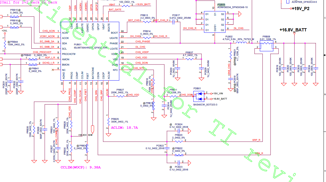

              If the configuration is similar to this schematic found in this thread
              https://www.badcaps.net/forum/showthread.php?t=89239
              Pin 14 and 15 of ISL88739B will show continuity as current sense lines.
              What else can I check?

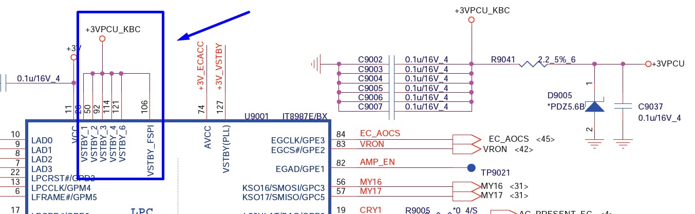

                          • gs84
                            • Dec 2022
                            • 36
                            • Ukraine
                            Re: HP Pavilion 15-cs1042ng - unknown 3.3/5.0V LDO
                            which voltage is here?

                              • gs84
                                • Dec 2022
                                • 36
                                • Ukraine
                                here

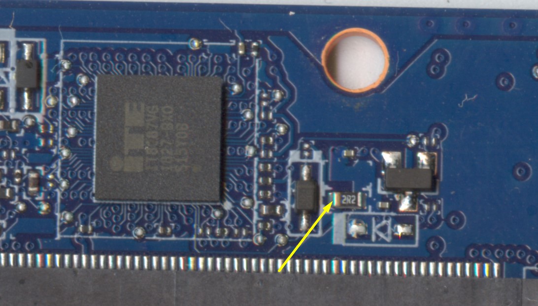

                                  You got the same laptop? Would it be safe to connect the adapter and measure the voltage with the QM3002M mosfet off the board? It's not turning on anyway?
                                  • loopster
                                    • Sep 2020
                                    • 76
                                    I put QM3002M back on the board, just to be safe. I have 1V on the 2.2Ohm resistor.

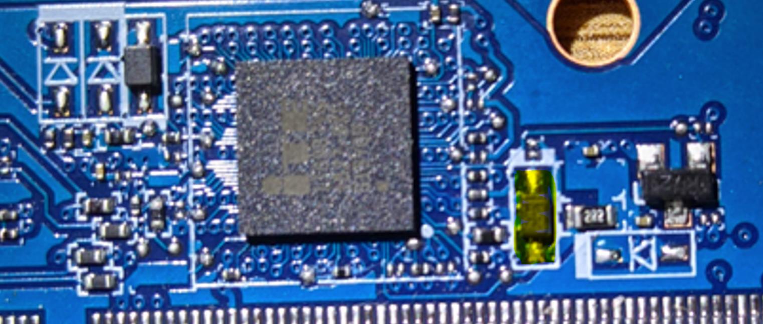

                                      This diode feeding into ITE8987 marked yellow measures funny.
                                      While all other diodes of the same type on this board measure 269 and OL in diode mode, this one measures 269 and 1350.
                                      It's marked KN 500. Could this be the cause of the fault?
                                      Can't find any datasheet on that type. Anyone knows whait it is, is it a Schottky diode? Could I replace it with a different type?
                                      • Sephir0th
                                        • Oct 2020
                                        • 1282
                                        Measurement of a diode IN-circuit is almost always inconclusive.
                                        Your troubleshooting is way to random to reach any goal here in addition. it might even end contrary.
                                        If the Main power rail is present, there is pretty sure no issue with the charging controller and if 3V/5V coils are present you pretty much don't have to worry about the LDOs.
                                        You have to start with the basics instead. With a known good charger for example.
