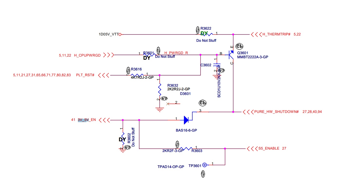

      Update, after remove diode (diode.jpg) i got correct 3.3v and 5v.
      After a while TPS51123RGER regulator died.
      I have put back diode and changed TPS51123RGER with new.
      Now iam on starting point again.
      Question is, why ENC pin is on 1.27v ? Probably pure_hw_shutdown# signal after diode is bad.
      i have schematic from thinkpad L430 and boardview L530

        What is the voltage to ground of PURE_HW_SHUTDOWN# ?
        Are the DCin mosfets bypassed / shorted to force the logic board to power on ?

              mon2, after removing diode d3601 on picture all voltages are ok, ENC ok, 3.3v ok, 5v ok ... but pure_hw_shutdown# going to 9x plases, one is pnp transistor q2701 that cut ECRST from 3.3v to 1.4v which is needed in power sequence. Ill try to remove all components connected to pure_hw_shutdown# one by one to figure which one causing voltage drop.

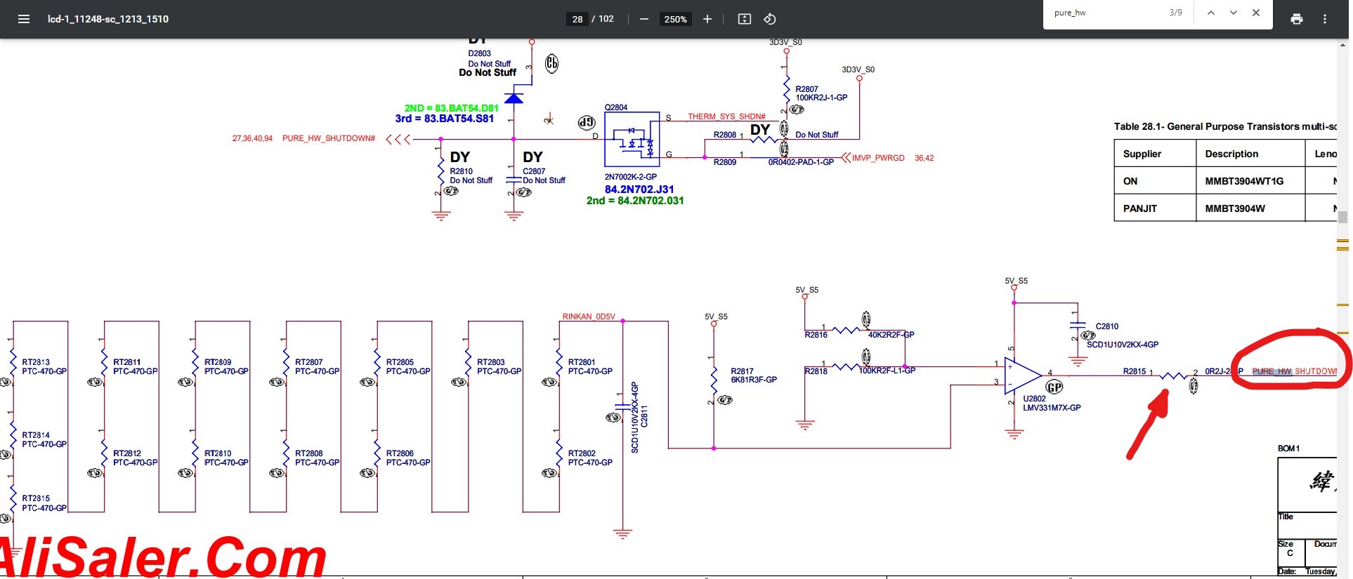

                tracing pure_hw_shutdown i came to U2802 (op amp) and removed

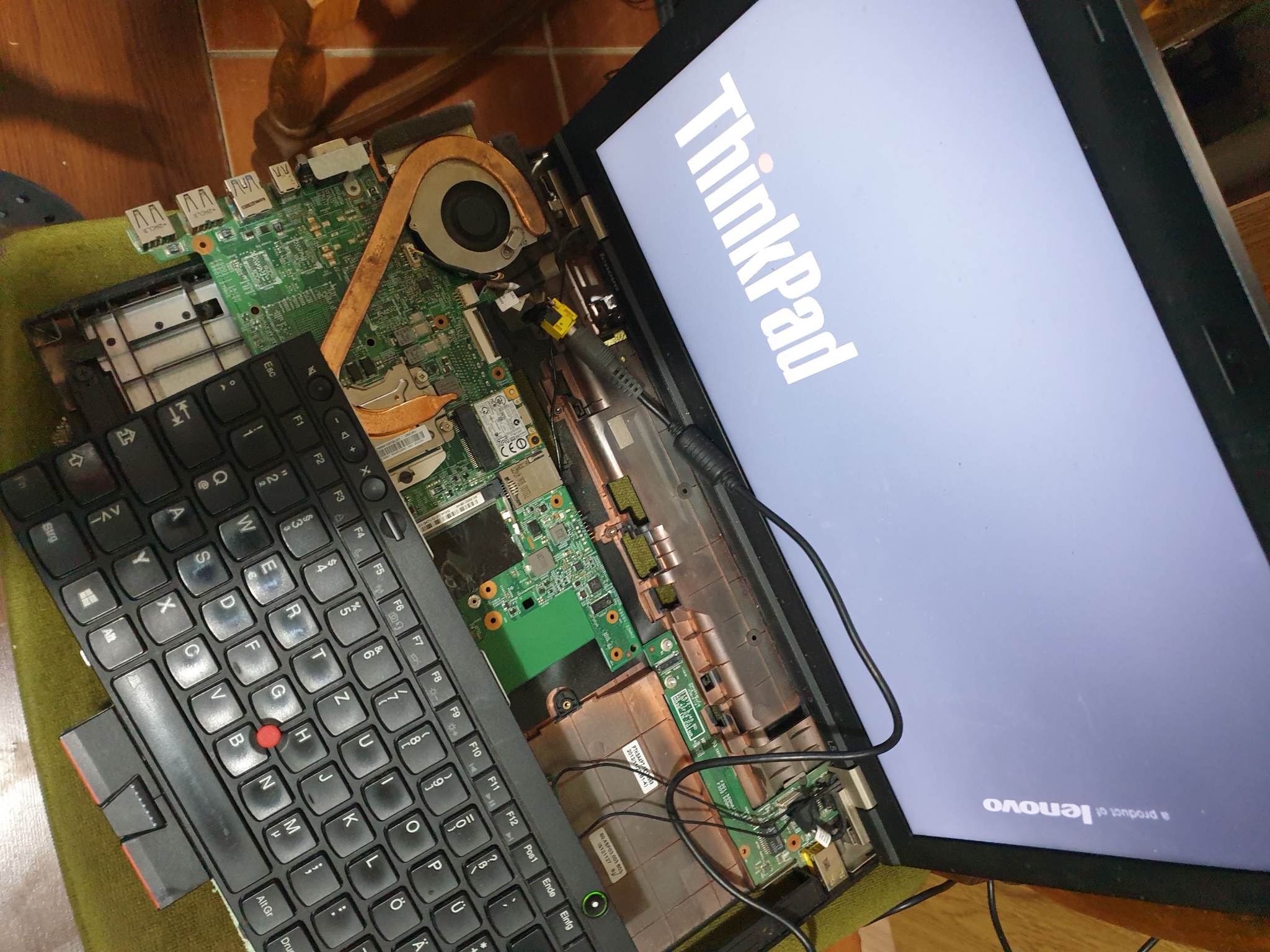

                R2815 ( 0ohm ) which connecting pure_hw_shutdown to U2802. After that motherboard starting. Laptop working.
                Question is why U2802 outputting wrong voltage and causing pure_hw_shutdown# voltage drop ?
                Something about FAN or some of PTC network failed ?

                  Measure the voltage to ground on each pin of U2802 comparator.

                    Re: Thinkpad L540 5v/3.3v output issue
                    u2802
                    before bwrbtn
                    only pin 5: 5,11v
                    after bwrbtn
                    1: 3.65v 2: 0v 3: 5.11v 4: 0v and 5: 5,11V
                    customer call me, so ill leave this state. Laptop is working.
