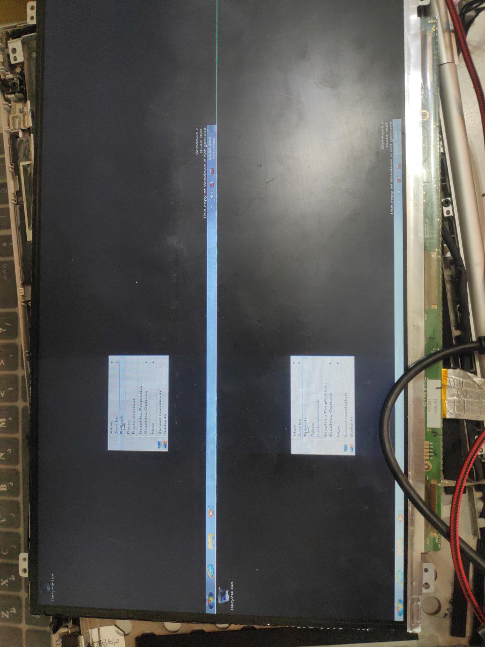

    hello my friend
    i have a motherboard here with lvds problem
    with some panels there is no output just black screen
    with some panels its noisy and split horizontally
    Dp output is ok
    i tried different bios,led,led cable
    no change
    any idea?

    Re: Post subject: 6570b (CASPER-UMA_CR_HPB ) LVDS Problem
    Boot in safe mode and check if the display is ok.
    Fault could be a bad video card device driver or configuration (ie. Too high refresh rate).
      nope
      its same from begining
