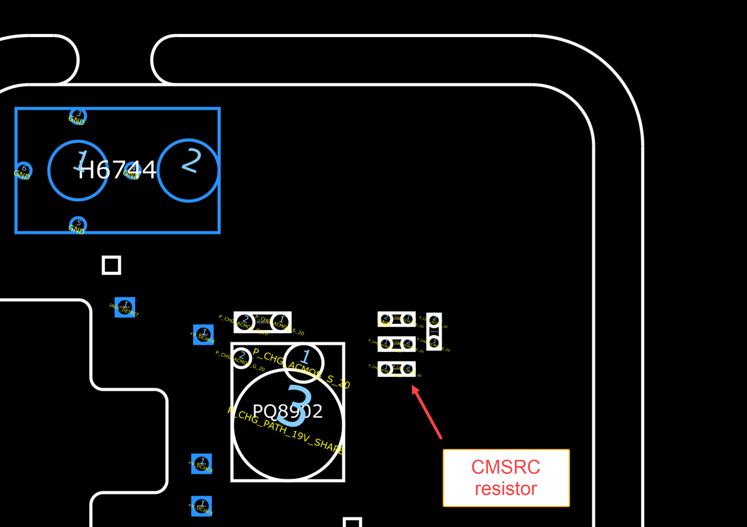

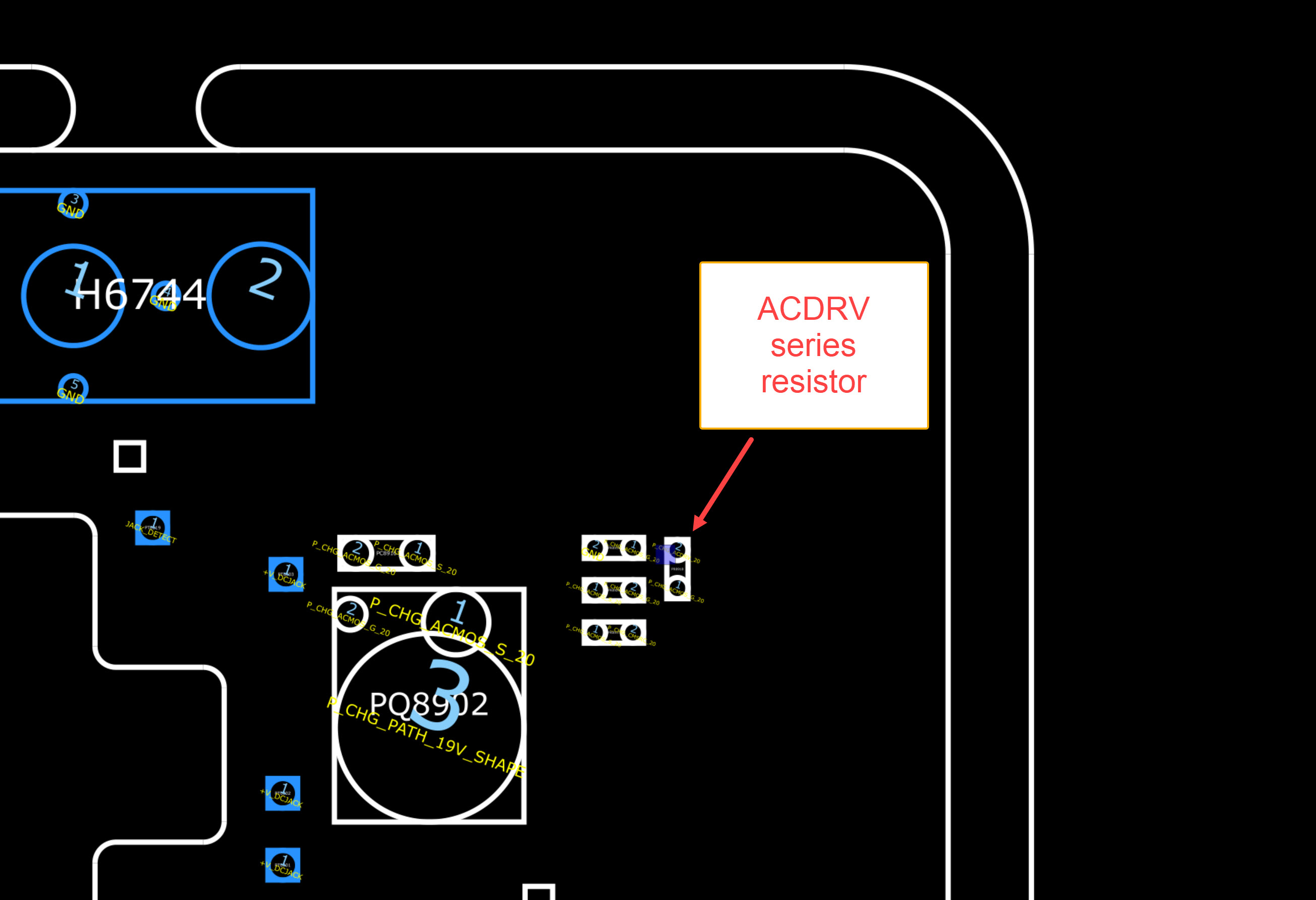

                          ACDRV resistor - see attached. It is on the backside of the PCB.
                          Check the resistance and it should be ~4k ohms.
                          Then remove it but do not lose this part.
                          Then measure ACDRV voltage again to see if it is ~25 volts.

                              Re: Asus UX550VD no power
                              The resistor is stop ringing (bounce) of the ACDRV voltage.
                              A common fault is that the mosfet being driven by the ACDRV pin is leaking and causes this ACDRV voltage to sink to a lower value or even 0 volts.
                              Once you remove this series resistor, the mosfets will not be driven by their gate pins and no longer hinder the ACDRV voltage. Often, the ACDRV voltage will be normal.
                              Then you can focus on which mosfet is defective. As per above sticky by @Piernov, the 2nd mosfet is usually the bad seed.
