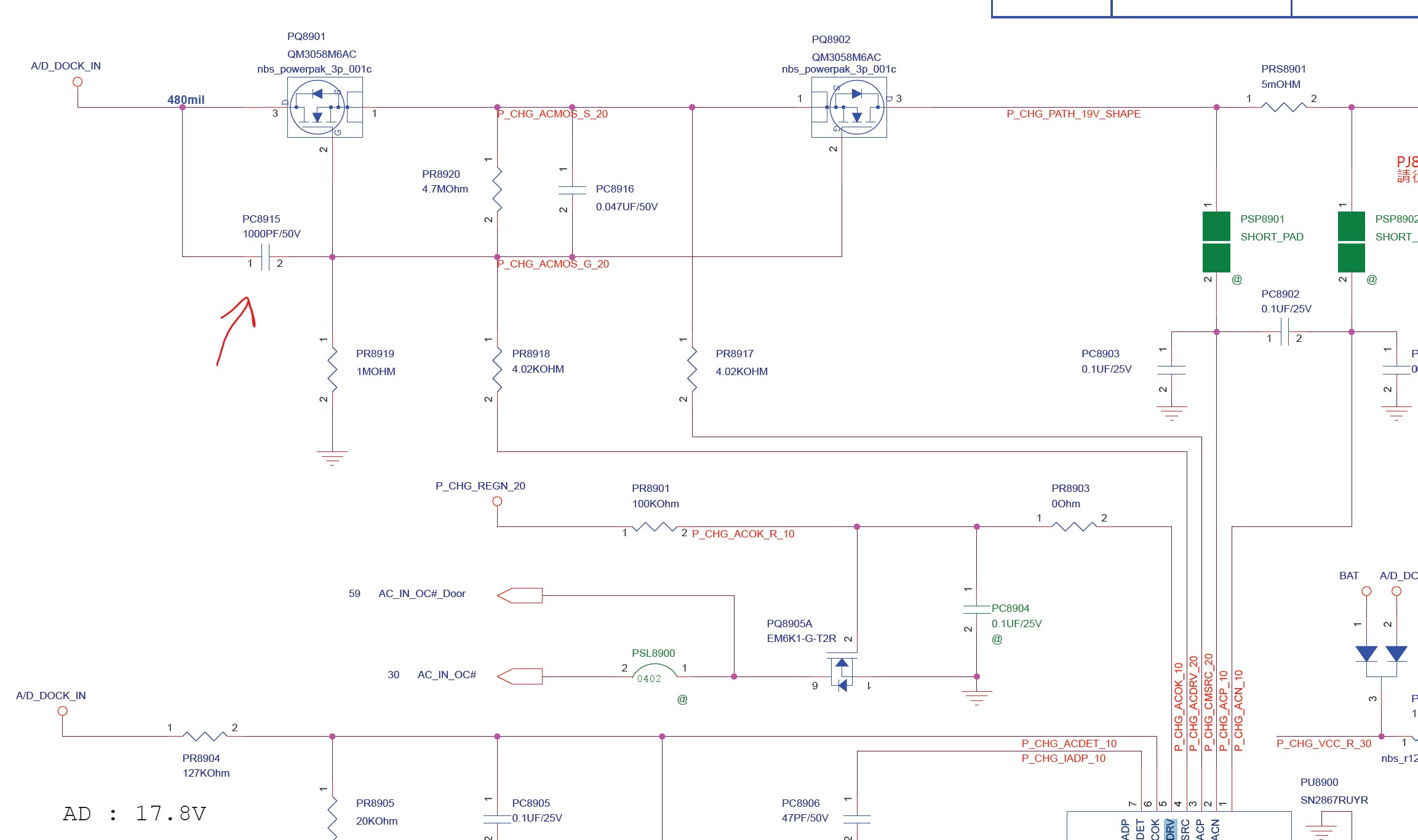

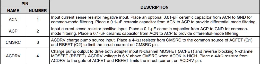

This is a very confusing charging IC, how can it be that CMSRC which is the source power of ACDRV if pulled from the source of the first FET. hard to understand.
So, resistance on the current sense res is 1.8 ohm.

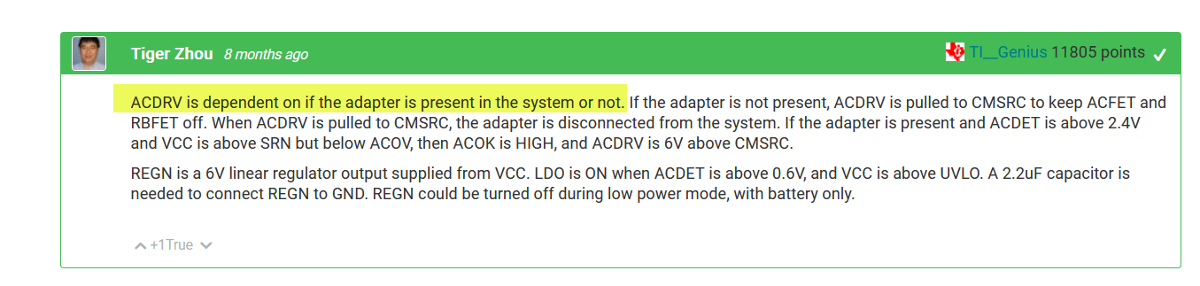

I have trued the reflow, VCC is 19v ACOK is 2.6v REGN 6v, CMSRC and ACDRV is about 0.4v
I am confused
voltage at output of first fet is zero
I found this schematics of UX550GD
I really don't know how to continue
