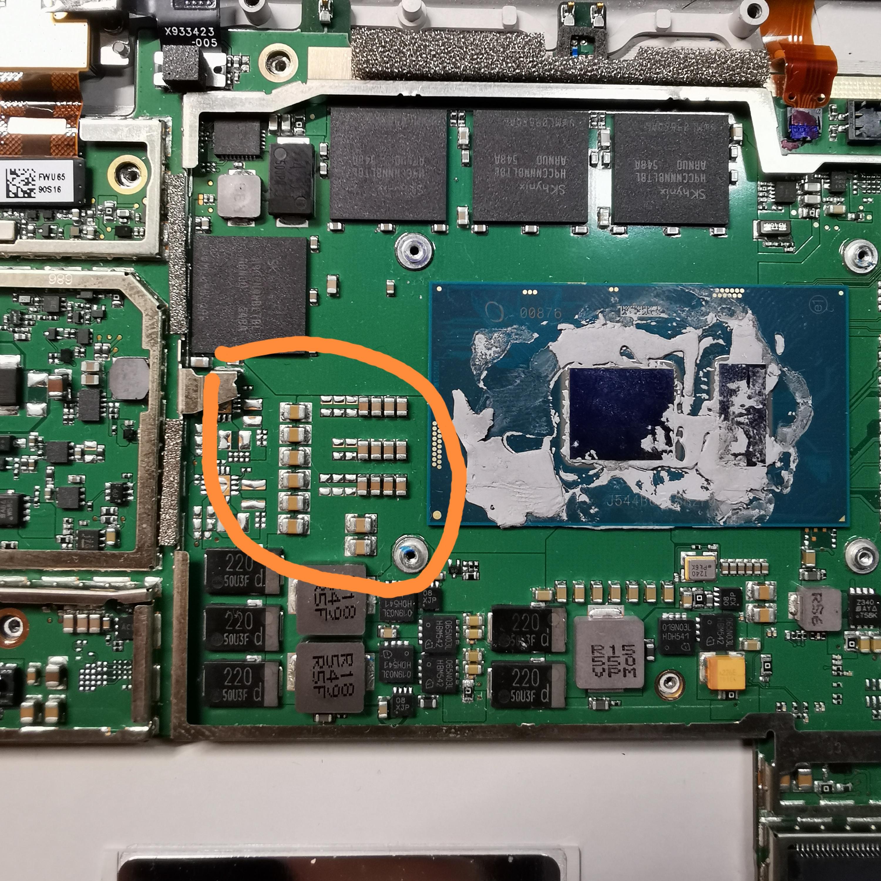

    Hello , i have this board from Surface Pro 4 , the area that i mentionet in the picture , all those capacitors are shorted to ground. That can be an CPU faulty ?
    Thank you

    It is normal to have low resistance with ground in the processor supply path. If the computer is short-circuited by touching the heatsink copper while the computer is running, the processor may have failed, of course.
