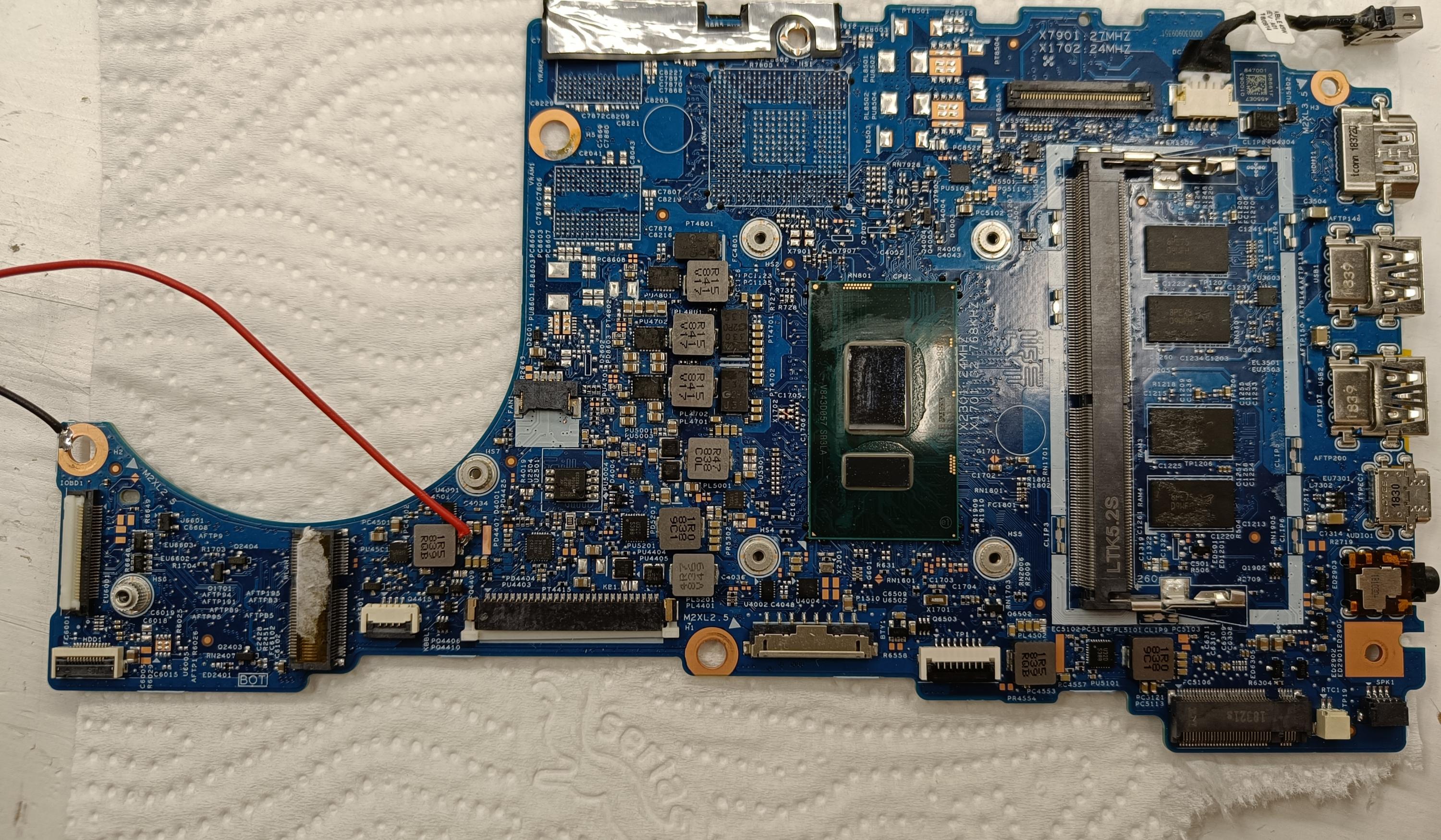

            PINS: 16, 17, 37, 67, 124, 125
            3,3V
            PIN: 111
            2,9V
            PINS with 0V: with power/no power resistance
            100 51/10k
            103 52/320k
            106 7/8
            107 20/92k
            111 2,9/very high

              Resistance and also diode mode meter readings are always with no power to the logic board.
              Can you review and update your posted values with no power to the logic board?

                PINS with 0V: no power resistance
                100 10k
                103 320k
                106 8
                107 92k
                111 2,9/very high
                121 10k
                Here

                  Pin 106 is 8 ohms or 8k ohms to ground resistance?
                  If 8 ohms, that is too low and there is a shorted part on that line.
                  Double check now in diode mode.
                  Meter in diode mode. No power to the logic board.
                  Red meter probe to ground.
                  Black meter probe to pin #106.
                  What is the measurement?

                    0,009V something wrong here...

                        Am I reading this right?
                        Signal from RTCRST_ON pin106 tells to switch mosfet Q1701 on. So is there something wrong in mosfet or near?

                          Correct. Pin 106 is driving the GATE pin of the mosfet (2N7002) @ Q1701.
                          Either this pin or something on this pin is shorting.
                          Start with removing the pull-down resistor @ R1703.
                          With no power to the logic board, check the DIODE mode reading again on this pin.
                          Is it improved ? The reading should be higher. If not, remove the mosfet @ Q1701 and measure again.
                          If the 'hard short' still remains on pin 106 then the conclusion is that the KBC is defective.
                          Wait on other comments but believe this KBC controller will then need to be replaced.

                            After resistor remove. 0,012V
                            after mosfet same...

                                This line is based on a GPIO pin (general purpose input/output pin).
                                From the measurements, this pin appears to be defective / damaged.
                                Do wait on other comments but to me, this KBC controller is damaged and must be replaced. From my (limited) understanding, this is a 8051 based KBC IC that uses firmware that is internal to the device. For this reason, this KBC controller requires a special programming tool.
                                Some KBC ICs use an external SPI interface flash memory device to boot the firmware.
                                There are vendors on Ebay, etc. that offer pre-flashed KBC ICs.
