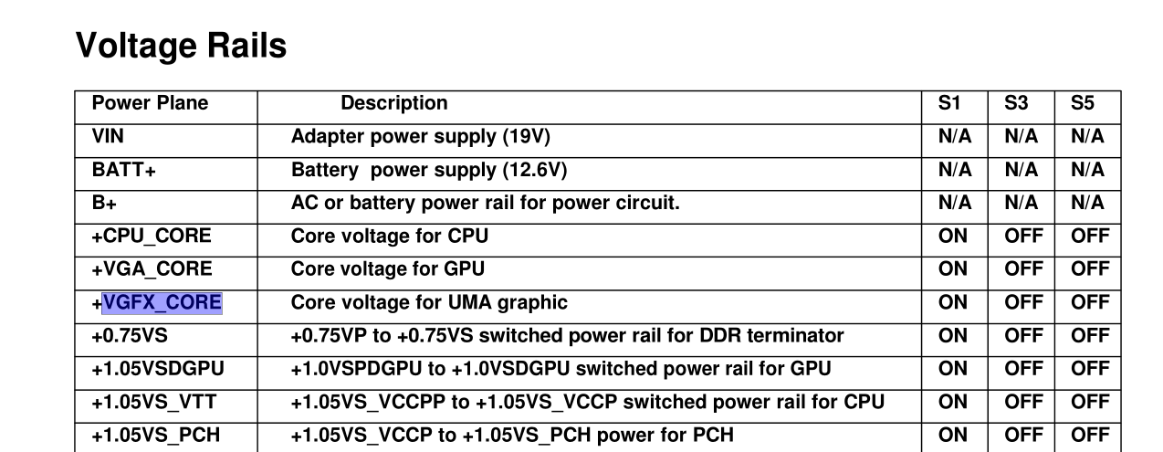

    PROBLEM NO DISPLAY.
    I CHECKED ALL VOLTEGES .
    ONLY +VGFX_CORE NOT PRESENT.
    I CHANGED DRIVER IC, MOSFET, BUT STILL SAME.
    ANYONE CAN YOU HELP TO FIX THIS PROBLEM?

    Remove all power -> meter in resistance mode.
    Check the resistance to ground of this power rail that is not being enabled (+VGFX_CORE).
    What is the exact resistance?

        9.3 Ohms

          Any news on this repair ?
          I have exactly the same problem !
          ACER Board: Q5WV1 LA-7912P
          All voltages are present except +VGFX_CORE
          Controller chip is 95836H gives no output on UGATE1G and LGATE1G that drives both mosfets for +VGFX_CORE
          No shorts detected.

            Sometimes bios flash solves it,sometimes replacing the PWM 95836 helps along with Both the mosfets. Sometimes its even the replacement of cpu that works. So no definite answers. be careful with the heat as this board's pcb doesnt take heat very well.
