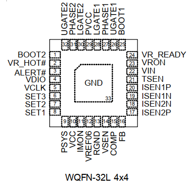

    I think im somewhere in the neighborhood of about 2 hours googling? things driving me insane
    Laptop is a HP ENVY X360 15M-ES1013DX
    Chip is located in the top right corner of the board near the LCD connecter About an inch UP and an inch to the right of the CPU/GPU
    to me it looks like it says G2=8H B5G
    Directly above the chip is Silk Screened PU4601 (not sure if this has anything to do with it)
    Silk screen on the back of the board
    GIDGET 15 X360 TGL-UMA
    203038-1N
    448. OMJO9.001N
    I believe this to be a Richtek chip. However i have gone through literally every PDF of part numbers starting with G2= and none of them line up with what i got.
    https://imgur.com/a/FdgxwQa
    https://imgur.com/a/cY8NAXk

    rt3612eggqw

      Re: Need help ID chip on HP laptop
      Originally posted by martha februarini
      rt3612eggqw
      ugh you are an amazing person, Now on the hunt on where to purcahse since digi and mouser dont have
        Originally posted by Terrelljames91
        ugh you are an amazing person, Now on the hunt on where to purchse since digi and mouser dont have
        Contact this shop:
        https://www.aliexpress.com/store/173...5942QLwOQLwOku
        and share the full p/n with their Aliexpress app tool in the chats.
        We use them often and is a reliable vendor.
