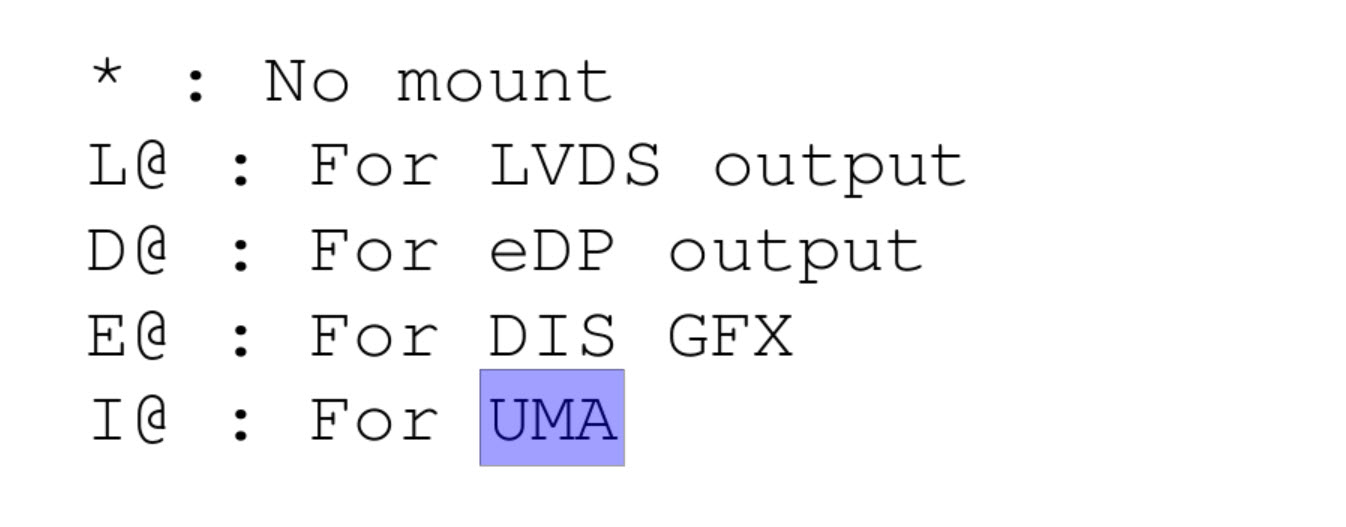

Need help in conversion of sony svf153a1yw DA0HKDMB6D0 REV D discrete to uma thank you.
by reamonGood afternoon gentlemen, please help. how to disable Discrete To Uma Conversion ...
by Chaminda4191To activate UMA mode, remove the following SMDs: PL1401, PL2401, PU2401, PU1401, PQ2401, PQ2402, PQ2403, and QV3. Then shift RC1609 to RC1610.
