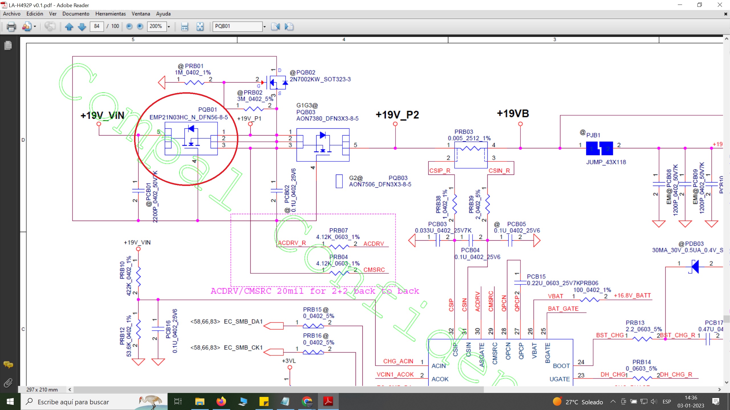

    Hello friends, I have this hp 15-dh la-h482p motherboard, the charger cut off at first, I replaced the PQ-B01 input mosfet, now the charger delivers the voltage but it still does nothing, could someone please guide me what measurement or tests to do...

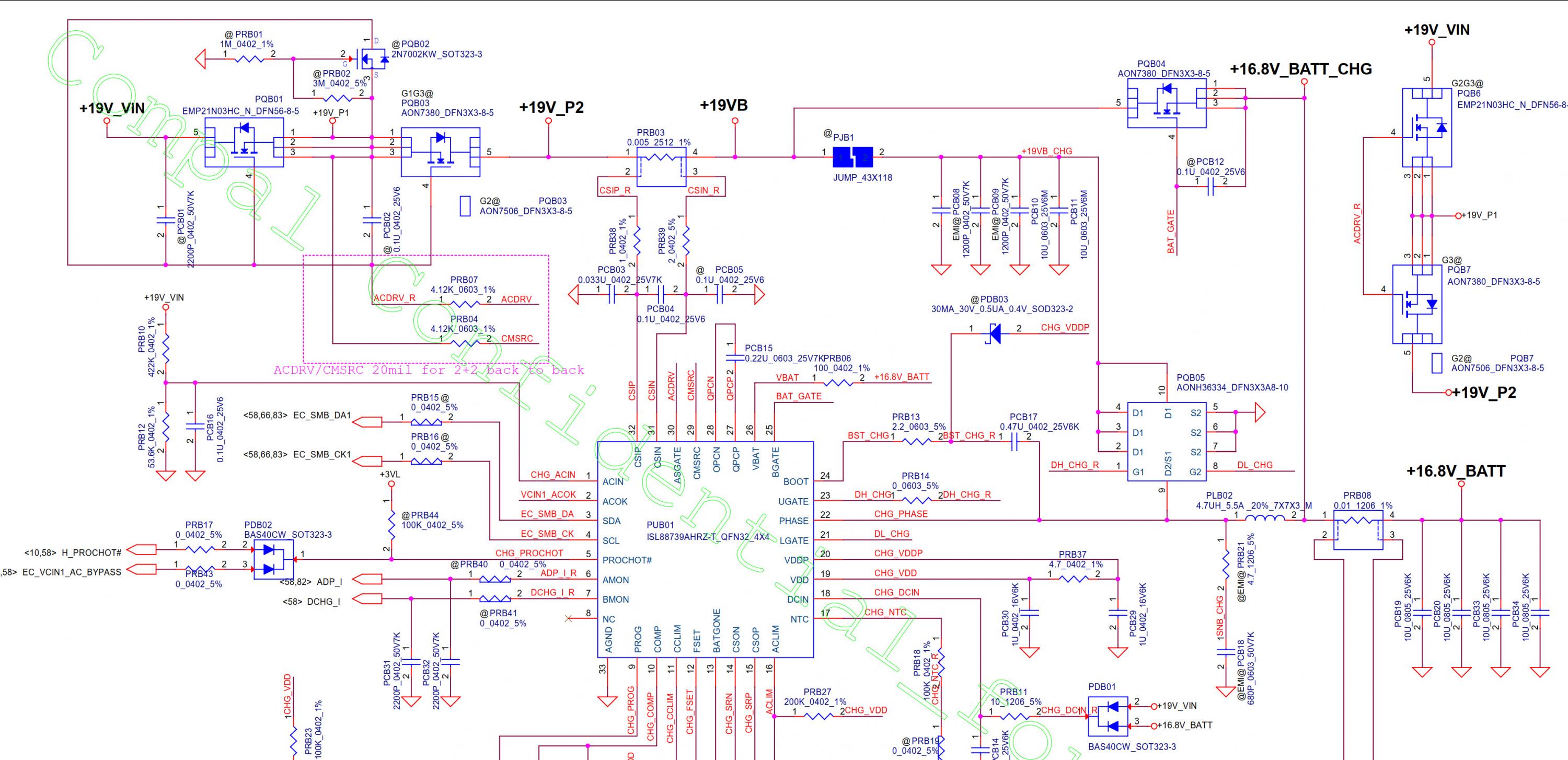

      PQB01/PQB03-Voltage on Pin1-4-8??
      Attach or link the schematic?? Which charger IC is used here?
      • mon2
        • Dec 2019
        • 14672
        Re: Omen 15-dc la-h482 no power on
        Adding to the above requested list of voltages...
        Pin #1 of the charger IC ? (voltage to ground; ACIN)
        Often the 2nd mosfet (PQB03) gets killed and causes the gate voltage to be lower. The proper voltage for the GATE pins of the 2 x DCin mosfets should be ~25 volts.
        As per above request, with the adapter connected, what is the voltage to ground for pin #4 of the 2 x DCin mosfets ?
        Someone posted the schematic today, here:
        https://www.badcaps.net/forum/showth...light=LA-H492p

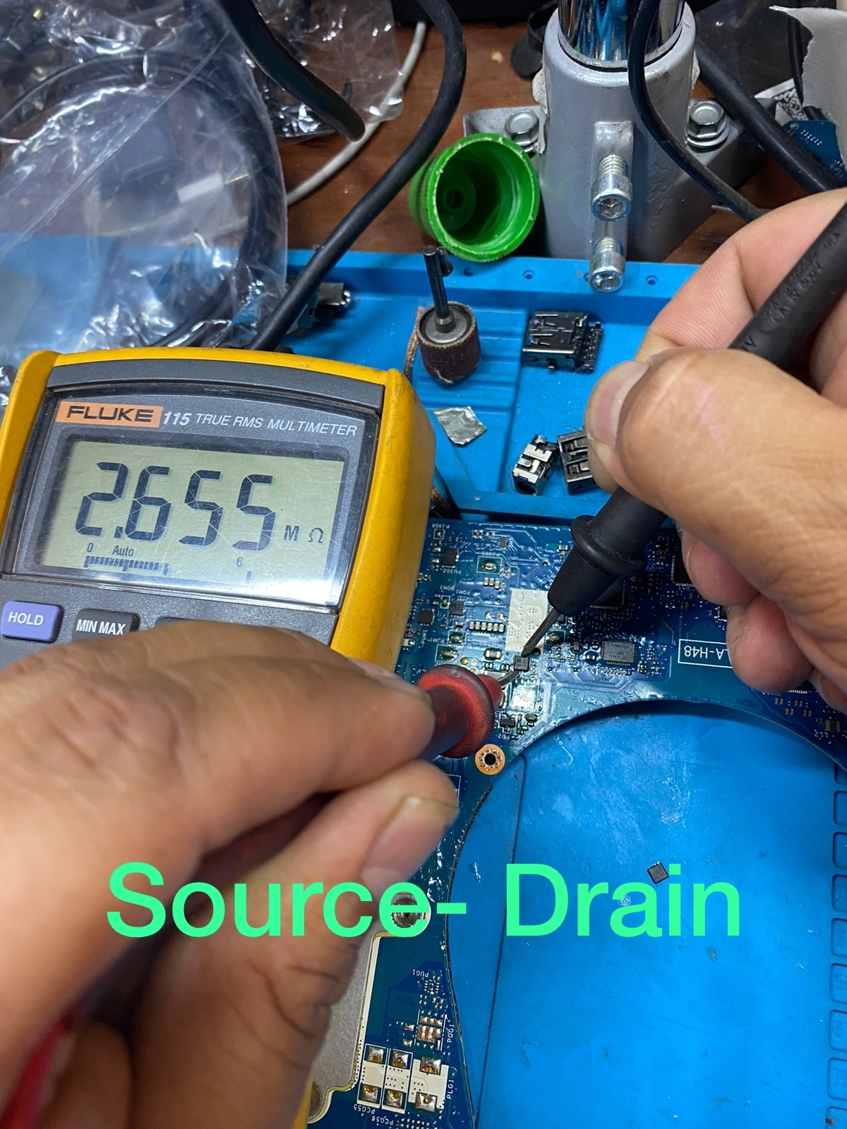

          Hello friends, thanks for your help, today I wanted to do the measurements and again PQB01 burned, I couldn't measure what can I do in this case? change it again? and see if I can measure?
          • mon2
            • Dec 2019
            • 14672
            Yes, get a replacement but do not install it.
            Measure the resistance across the mosfet pins of the 2nd mosfet.
            Source & drain
            Source & gate
            Gate & drain
            Post each measurement. No power during these tests.

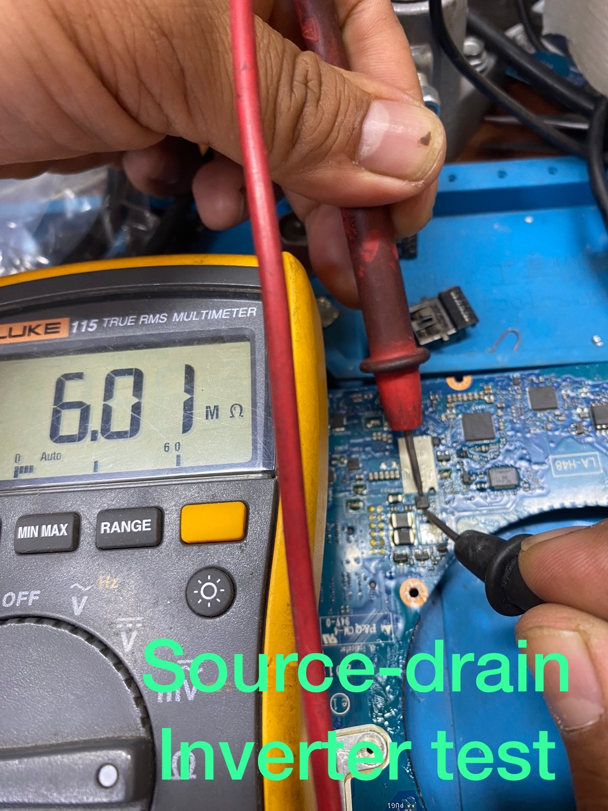

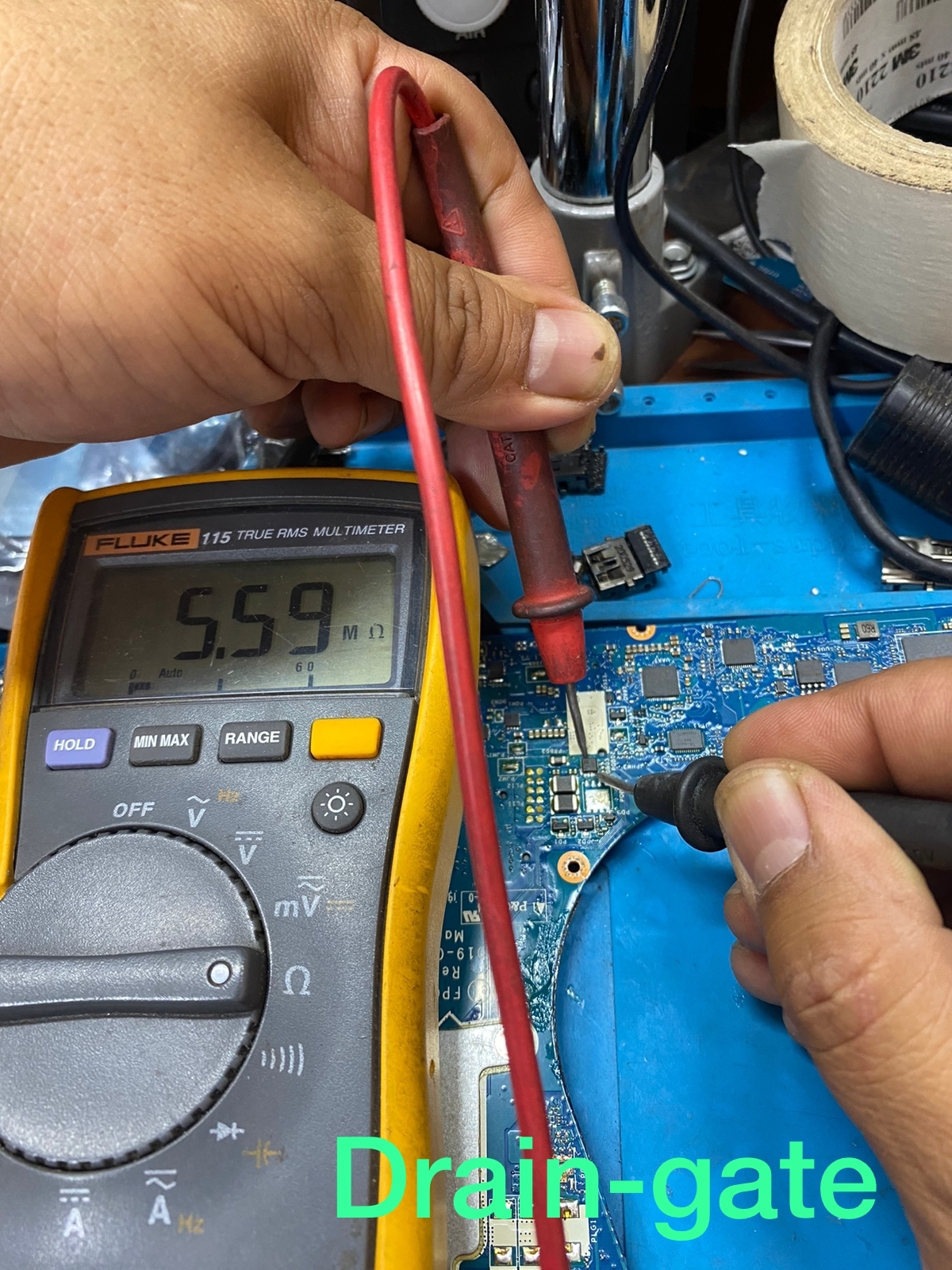

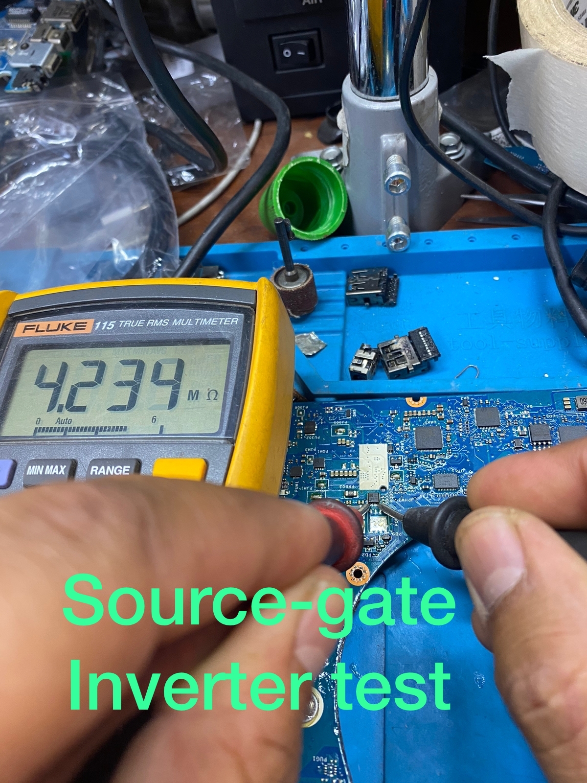

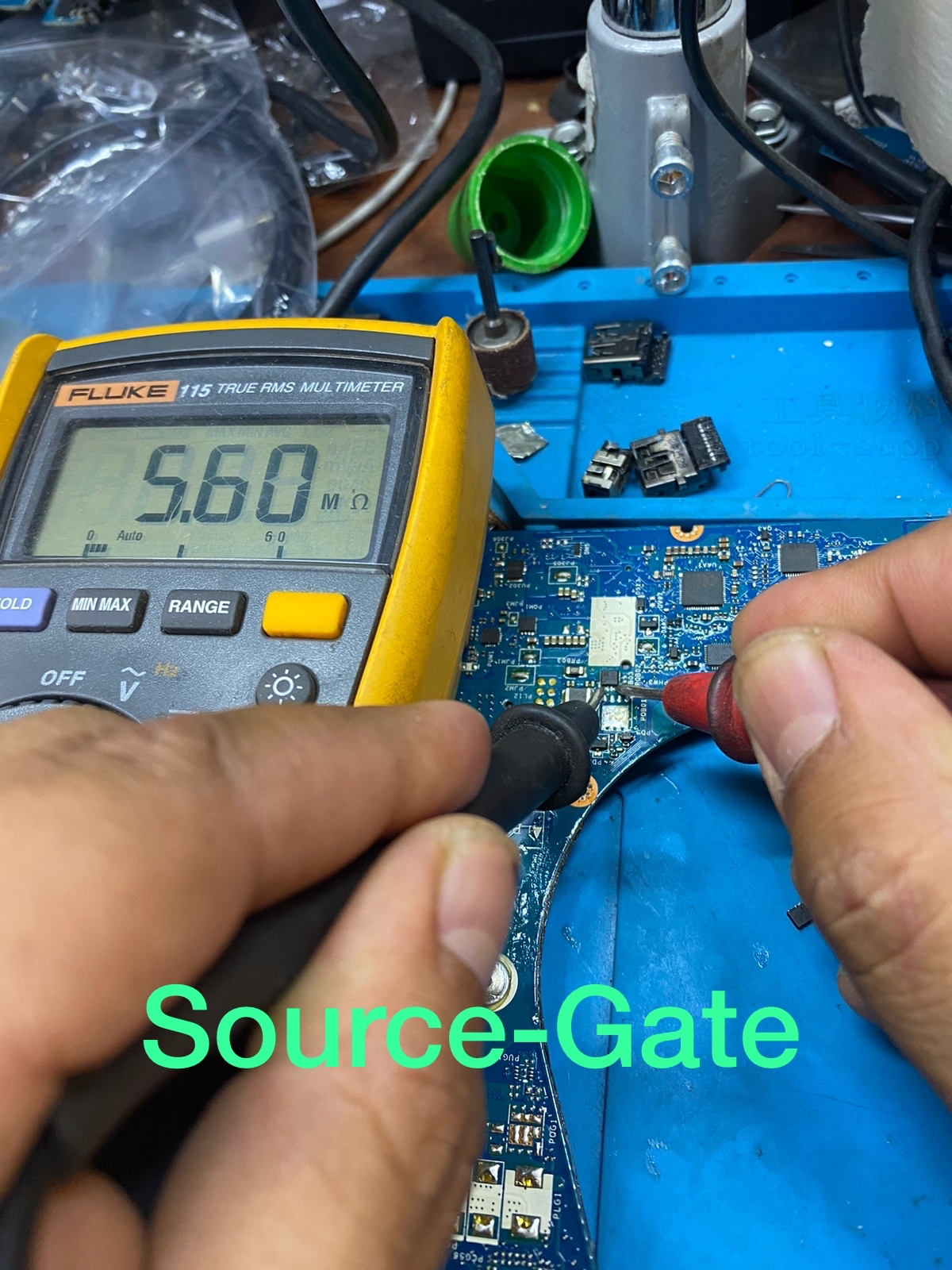

              Ok, friend, I appreciate your time and your wisdom, I have attached images of the measurements.
              • mon2
                • Dec 2019
                • 14672
                These are good mosfet readings.
                With the first mosfet installed, what are voltages on each DCin mosfet?
                The gate voltage (ACDRV) should be ~25v to enable.
