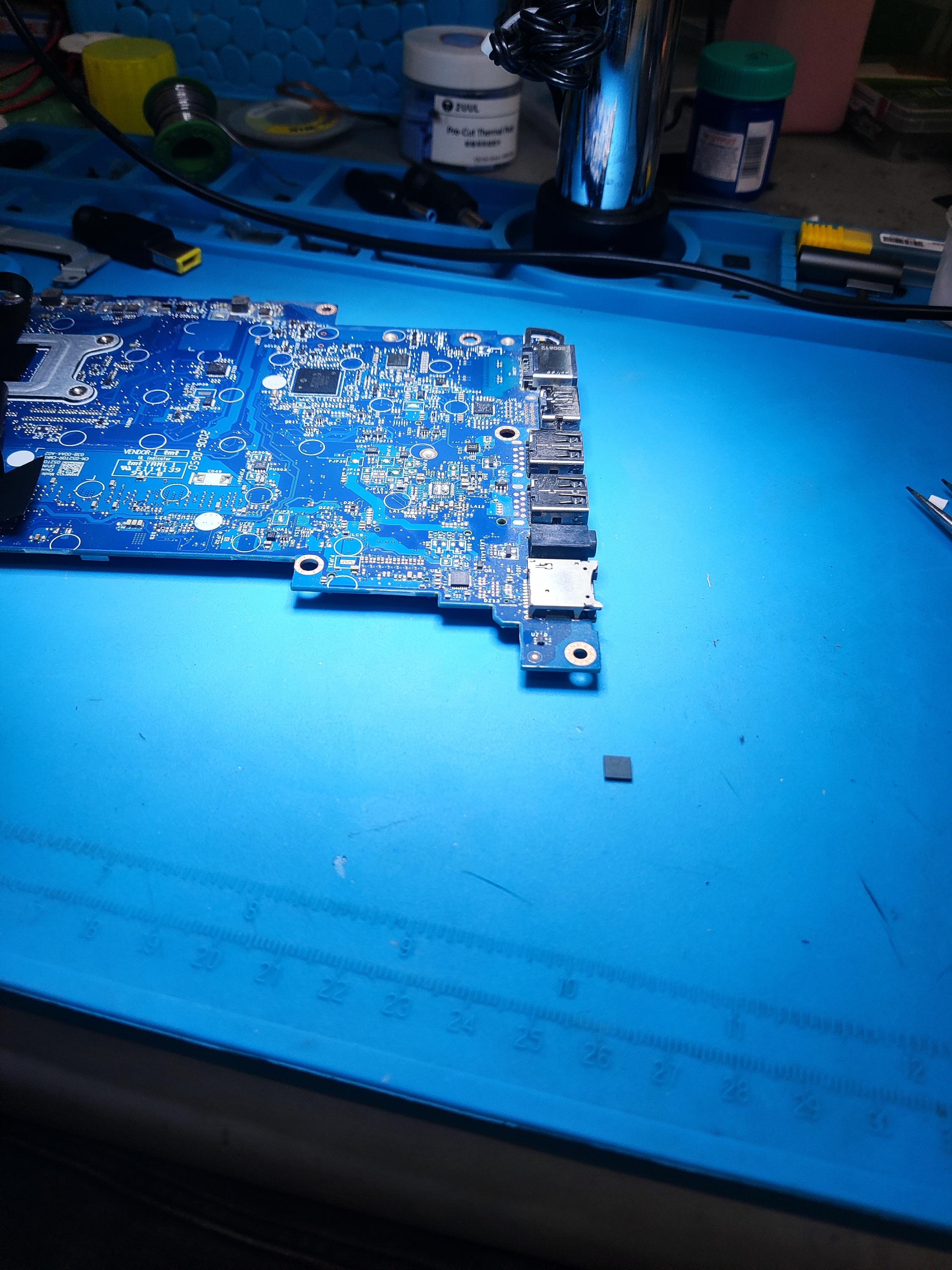

    Customer says they were playing music on internal speakers and it suddenly stopped. Windows says no audio device detected.
    Here is what I have done so far: I have inspected the motherboard for burnt parts or liquid damage, I have checked for shorts to ground on all supply pins, I have changed the audio IC, I have reflashed the bios with a 100% working dump, I have enabled the audio device in bios.

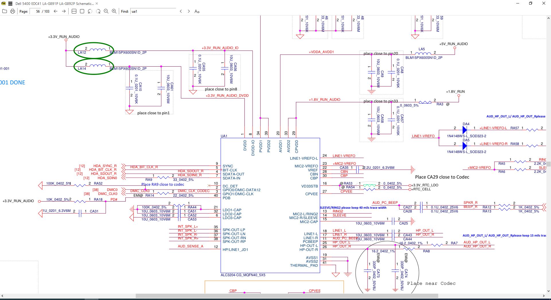

    Here is a list of the voltages found on all the pins
    1.DVDD 3.3V
    2.DMIC-DATA12 2.5V
    3.DMIC-CLK 3.3V
    4.SDATA-OUT 0V
    5.BIT-CLK 1.8V
    6.LDO3-CAP 1.2V
    7.SDATA-OUT 0V
    8.DVDD-IO 3.3V
    9.SYNC 0V
    10.DC_DET 0.16V
    11.PCBEEP 2.1V
    12.HP/LINE1_JD1 3.3V
    13.MIC2-L/RING2 0V
    14.MIC2-R/SLEEVE 0V
    15.MIC2-CAP 0V
    16.VD33STB 3.3V
    17.LINE1-R 0V
    18.LINE1-L 0.10V
    19.AVSS1 GND
    20.AVDD1 5V
    21.LDO1-CAP 4.4V
    22.VREF 2.1V
    23.MIC2-VREFO 0V
    24.LINE1-VREFO-L 0V
    25.HP-OUT-L 0V
    26.HP-OUT-R 0V
    27.CPVEE 0V
    28.CBN 0V
    29.CPVDD 1.8V
    30.CBP 1.8V
    31.AVSS2 GND
    32.LDO2-CAP 1.3V
    33.AVDD2 1.8V
    34.PVDD1 5V
    35.SPK-OUT-LP 0V
    36.SPK-OUT-LN 0V
    37.SPK-OUT-RN 0V
    38.SPK-OUT-RP 0V
    39.PVDD2 5V
    40.GPIO1/DMIC-CLK 3.3V
    What could be the reason why there is no audio? TIA

    Pin #4 will be the audio data stream from the audio source. It is at 0v.

      Re: Dell Latitude 5400 LA-G891P no audio
      You forgot to mention audio codec number??
      • mon2
        • Dec 2019
        • 14470
        It is under the schematic symbol.
        ALC3204

          SDATA-IN/OUT,SYNC-none is working. Too me it seems lack of communication between audio codec and PCH. Audio jack can be the issue as well-so worth trying de-soldering the audio jack.

            Thanks everyone for your assistance, I have noticed that the screen is also flickering and the display getting distorted even after LCD and LVDS cable change . I am now suspecting that the reason there is no communication between the audio codec and PCH is because the SOC could be going bad.
            I didnt know about SDATA and SYNC signals, I have learnt something.
