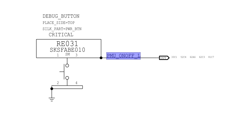

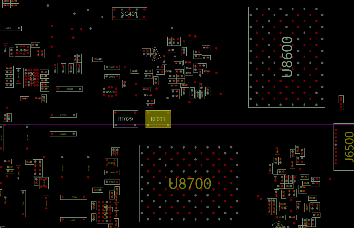

        Review the use of the pushbutton @ RE031 - see attached.

          That's what I was thinking... jus was not sure. I am back in the workshop tomorrow so will try then.just for informational purposes... Reading the schematic is like reading a map for me. It's the abrievations.. I get letters and numbers mixed up so things don't make sense... but I do get there... eventually...lol

            Thank you Mon2, your advise was spot on. I can clarify the power button has failed.
            I used RE030 as it was on the bottom side of the board so it could be tested in situ. I found that RE030 and RE031 are connected using FexBV .
            Once again, thanks for your help and assistance.
