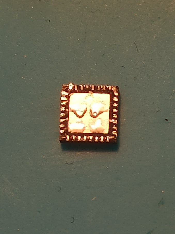

    Hello.
    Have this Dell 7420 LA-K371P that have burned UPD4 right in marking so i cannot figure what is it
    anybody know this ic? laptop have USB-c charging

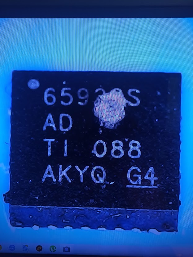

      Re: Dell 7420 LA-K371P burned UPD4
      found schematic. in it is TPS65992S. Do u think it is it? looks like 4th digit is different
        There is some variant, yours TPS65992SAD
