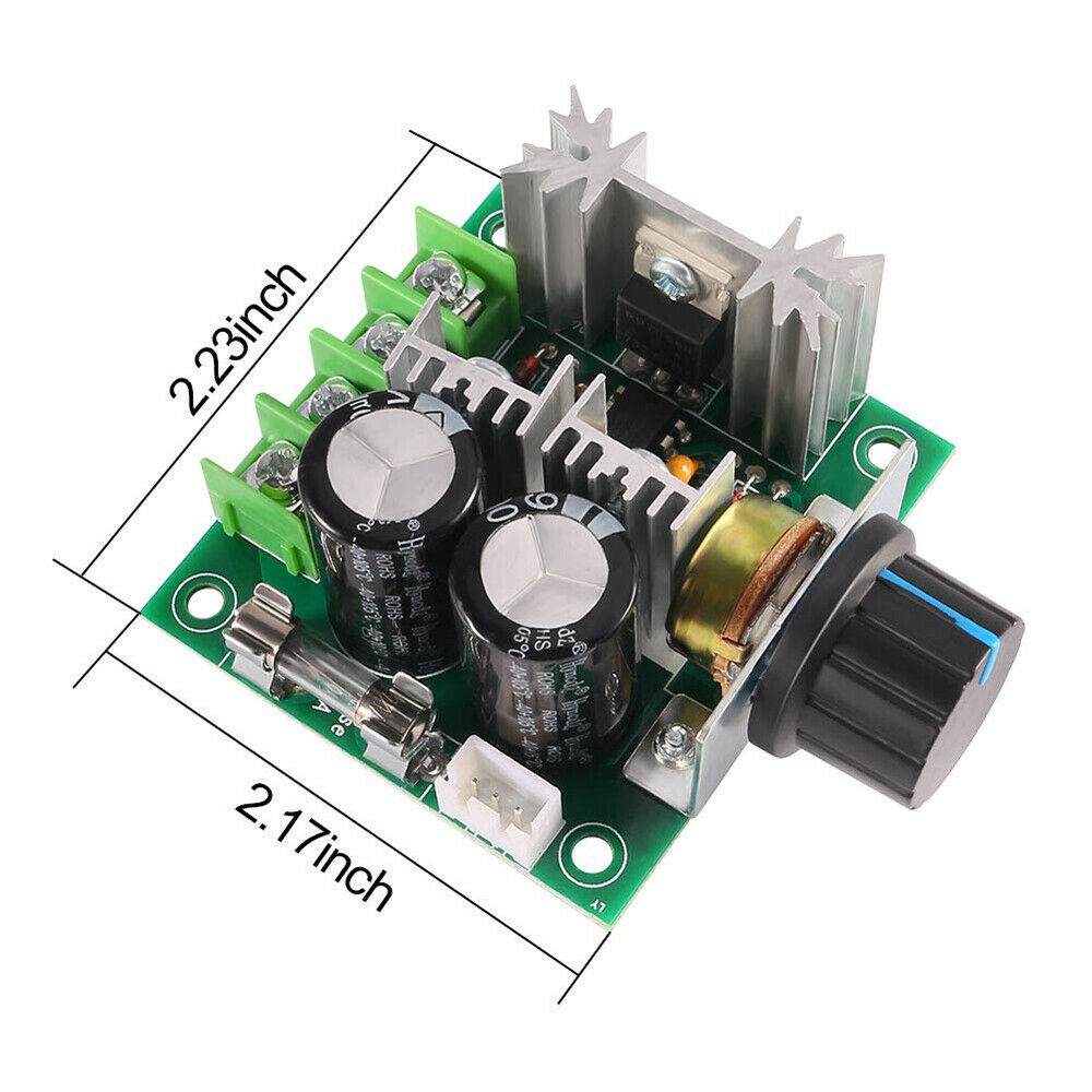

    if it's for the blower then fuck it, fit a chinese pwm motor speed controller and replace the switch with a pot.
    i have seen and fixed this problem half a dozen times now on ford vans - they are notorious for burning up resistors on the blower.

      I would second this idea as long as it only for the ac fan blower motor
      You would have better fan motor speed control but I would modify the speed controller for a minimum speed so you do not have the fan speed to low because if the refrigerant control device is a cap tube restricting device you will have to do this because you will freeze up the evaporator coil if it is a TXV valve or a expansion control valve this is not so important but you still will have to have a minimum amount of air flow
      Now if you had a temperature controller that included a PWM controller function that would be the best of both worlds because you base the fan minimum speed on temperature

        What sort of PWM controller were you thinking of? Most of them are pretty ugly i.e. this one has three heatsinks when all you need is one. It looks like Darlington instead of a mosfet lol and 5V 7805 for the 555. Then you need a box, then you gotta move the pot etc or make it compatible with the old 0-1-2-3 speed switch. For a classic car it would be a bit of work, but worth it.
        Getting cabin temp is actually hard to to do, where do you put the thermistor? I've seen it usually top back of the front seats, or rear-view mirror.

          the controller i'v seen is cased in a perforated case, but it could look similar to that inside i suppose.
