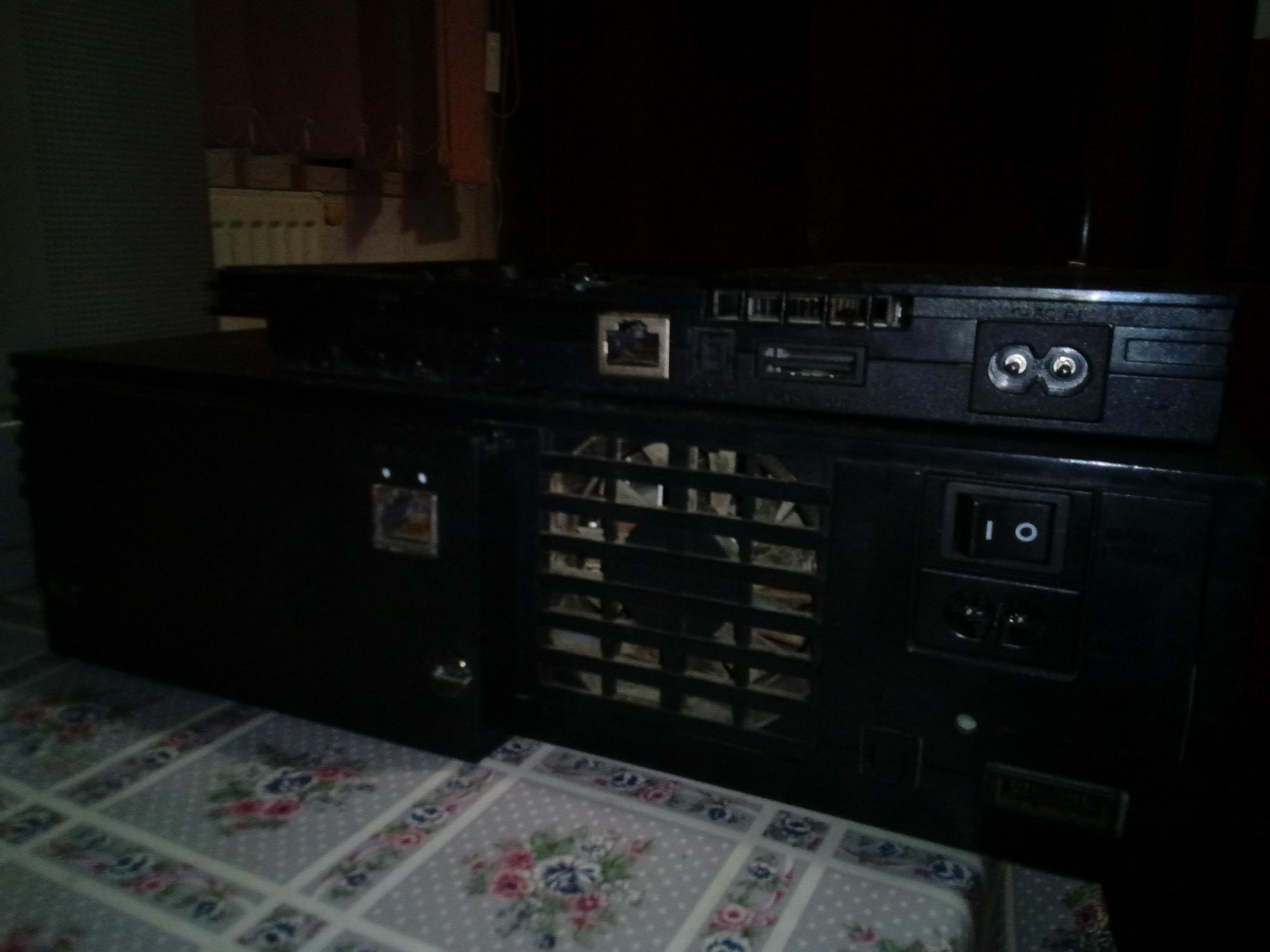

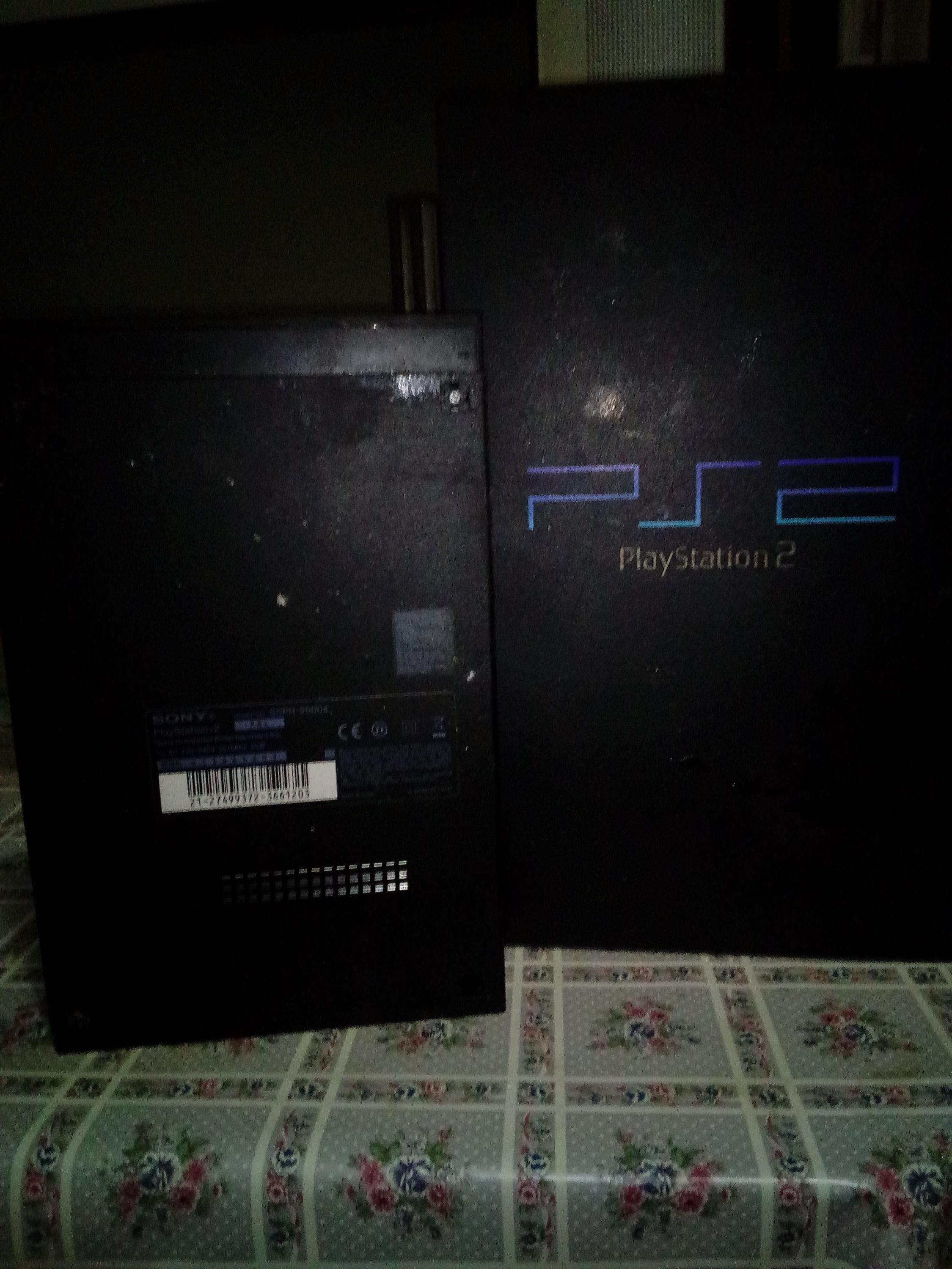

So, I've now got two PS2s and an original GTA:SA disc;
  • Th3_uN1Qu3
    Believe in
    • Jul 2010
    • 6031
    • Romania
    So, I've now got two PS2s and an original GTA:SA disc;
    I was never a PS guy, I had borrowed the original PS for a while but otherwise went from a NES clone and the original Gameboy to PC and Sega Dreamcast (yes, I'm an oddball, lol).
    Visited my grandpa today and I just found these two lying on the street. There's an original fat and a slim - the size difference between the two is ridiculous. The fat is missing the drive bezel and the slim is missing the drive cover, otherwise both units power up, the drives spin and appear to load up the GTA San Andreas disc I found in the fat. I don't know anything else yet since I don't have a video cable or a controller.
    To be continued.
    A working TV? How boring!
  • Th3_uN1Qu3
    Believe in
    • Jul 2010
    • 6031
    • Romania
    Re: So, I've now got two PS2s and an original GTA:SA disc;
    Pics or it didn't happen:
    A working TV? How boring!
      • 31015
      Re: So, I've now got two PS2s and an original GTA:SA disc;
      nice!
      now if you get a memory card that is compatable with the original ones, you can use a factory service trick to load games from the front usb port!!!!
      (stick the iso's on a memory stick)
      look up "openPS2-loader"
      • Th3_uN1Qu3
        Believe in
        • Jul 2010
        • 6031
        • Romania
        Re: So, I've now got two PS2s and an original GTA:SA disc;
        Thanks, I knew they made it boot off USB and it looks like I can find a modded memory card for a tenner. I'll go to the swap meet tomorrow see if I can source an AV cable... The local superstore still carries controllers so that's already covered.
        A working TV? How boring!
          • 31015
          Re: So, I've now got two PS2s and an original GTA:SA disc;
          if i remember right, the same rgb cable works between the psx, ps2 and ps3
          i remember using my psx scart cable on a ps2 and i think it worked on the ps3.
            SHUTTLE XPC slim DX30 XPC slim J3355 Specification for Upgrade or Repair
            This specification for the SHUTTLE XPC slim DX30 can be useful for upgrading or repairing a desktop PC that is not working. As a community we are working through our specifications to add valuable data like the XPC slim DX30 boardview and XPC slim DX30 schematic. Our users have donated over 1 million documents which are being added to the site. This page will be updated soon with additional information. Alternatively you can request additional help from our users directly on the relevant badcaps forum. Please note that we offer no warranties that any specification, datasheet, or download for SHUTTLE...
            09-12-2024, 03:30 PM
            SHUTTLE XPC slim Office DL1000XA XPC slim J4005 Specification for Upgrade or Repair
            This specification for the SHUTTLE XPC slim Office DL1000XA can be useful for upgrading or repairing a desktop PC that is not working. As a community we are working through our specifications to add valuable data like the XPC slim Office DL1000XA boardview and XPC slim Office DL1000XA schematic. Our users have donated over 1 million documents which are being added to the site. This page will be updated soon with additional information. Alternatively you can request additional help from our users directly on the relevant badcaps forum. Please note that we offer no warranties that any specification,...
            09-12-2024, 03:28 PM
            HP Slim Desktop S01-aF0011ns Slim Desktop J4005 Specification for Upgrade or Repair
            This specification for the HP Slim Desktop S01-aF0011ns can be useful for upgrading or repairing a desktop PC that is not working. As a community we are working through our specifications to add valuable data like the Slim Desktop S01-aF0011ns boardview and Slim Desktop S01-aF0011ns schematic. Our users have donated over 1 million documents which are being added to the site. This page will be updated soon with additional information. Alternatively you can request additional help from our users directly on the relevant badcaps forum. Please note that we offer no warranties that any specification,...
            09-12-2024, 03:28 PM
            SHUTTLE XPC slim Office DL1000EP XPC slim J4005 Specification for Upgrade or Repair
            This specification for the SHUTTLE XPC slim Office DL1000EP can be useful for upgrading or repairing a desktop PC that is not working. As a community we are working through our specifications to add valuable data like the XPC slim Office DL1000EP boardview and XPC slim Office DL1000EP schematic. Our users have donated over 1 million documents which are being added to the site. This page will be updated soon with additional information. Alternatively you can request additional help from our users directly on the relevant badcaps forum. Please note that we offer no warranties that any specification,...
            09-12-2024, 03:28 PM
            SHUTTLE XPC slim DH110 XPC slim i3-6100 Specification for Upgrade or Repair
            This specification for the SHUTTLE XPC slim DH110 can be useful for upgrading or repairing a desktop PC that is not working. As a community we are working through our specifications to add valuable data like the XPC slim DH110 boardview and XPC slim DH110 schematic. Our users have donated over 1 million documents which are being added to the site. This page will be updated soon with additional information. Alternatively you can request additional help from our users directly on the relevant badcaps forum. Please note that we offer no warranties that any specification, datasheet, or download for...
            09-12-2024, 03:28 PM
