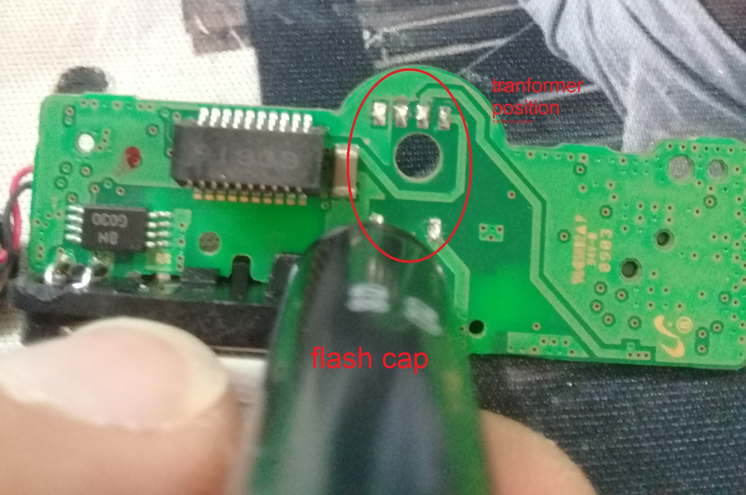

    Hello friends
    I am trying to fix my old camera "samsung s860" after it took a dump in water, the PCB also took a shock

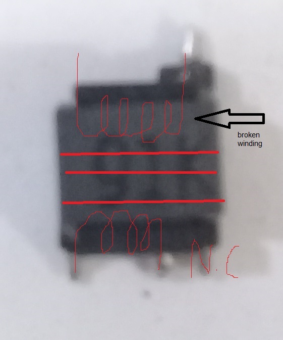

    i successfully clean it and turn it back on but the shock cause a small transformer (i think) next to the flash capacitor to pop out of the board which broke one of the winding.

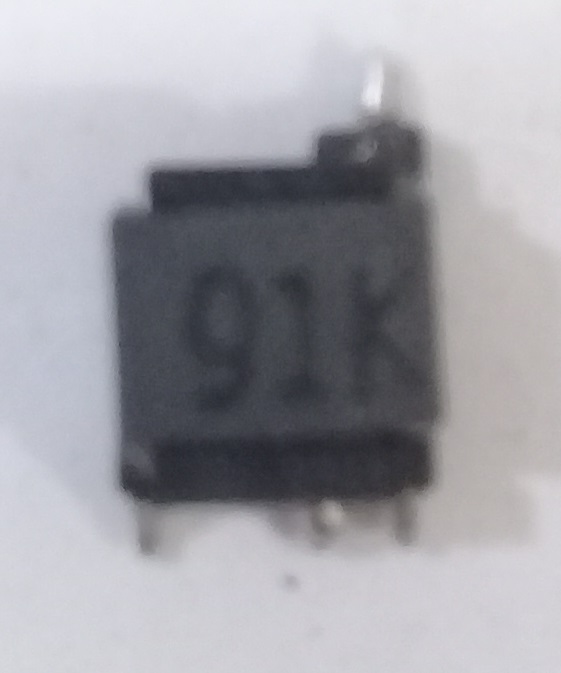

    my problem is i couldn't find a replacement on the net whatever i searched for,the only code written is "91K" and some unread code in the bottomn of the component.
    I need a replacement for this component for the flash to work.

    see if you can get the broken wire out ot at least it shows up in order to solder a wire to it.

      Re: replacement for a transformer found in an old camera
      Camera photoflash transformers are custom parts, I've never seen them for sale. They are very tiny. Another Samsung camera might use the same part.
        I already tried that :-)
              The photoflash HV transformer is Samsung W05-243 transformer p/n AD26-00033A. There is also the trigger transformer KP-133.
              The IC can use:
              TDK LDT565630T-002
              Tokyo Coil Engineering T-16-024A
              Asatech ST-532517A
              Not sure if one of these matches the original.
