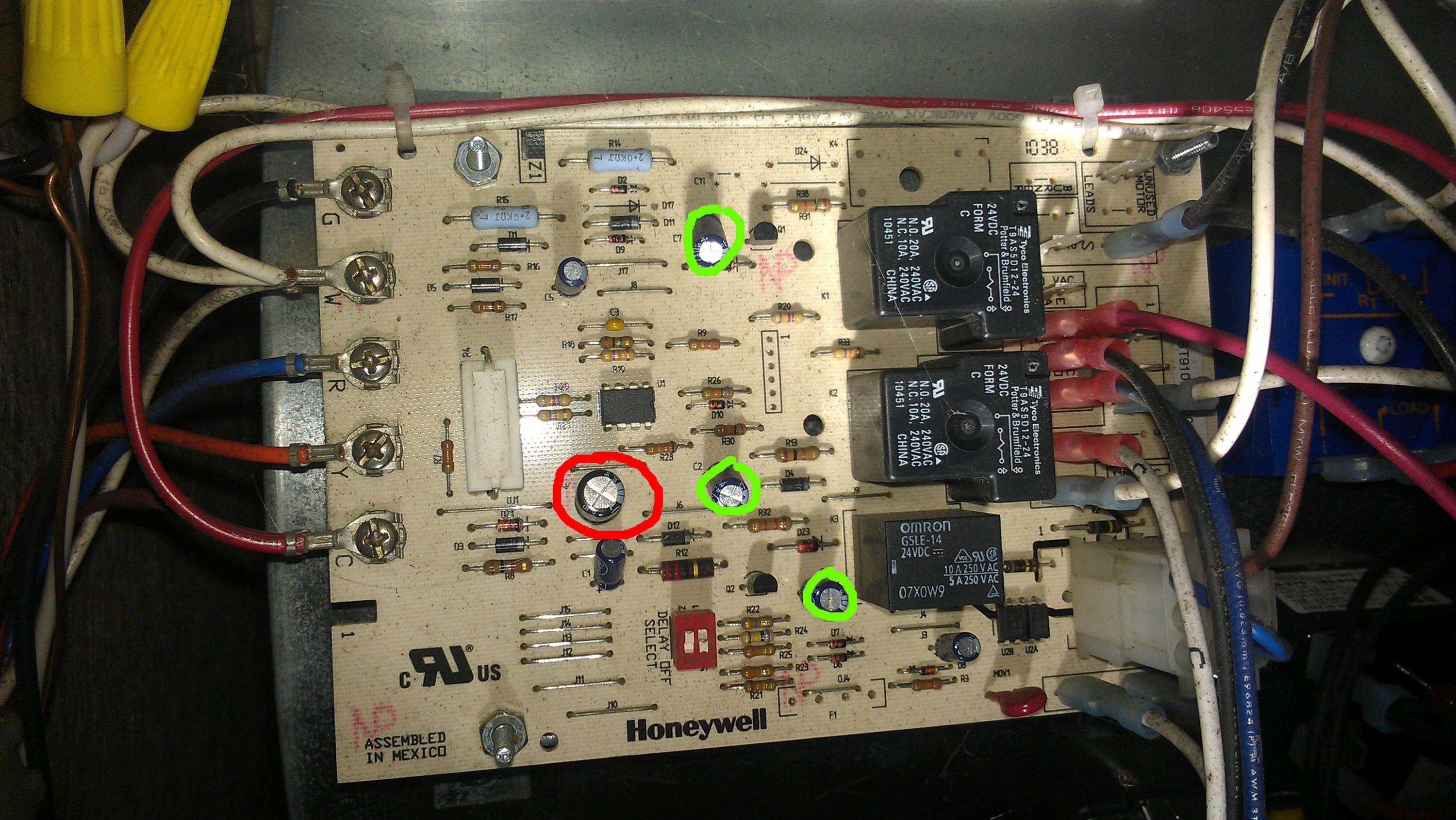

    It works for years, then it was having problem with burner turn on and off then on again, fan will not turn on even temperature was reaching to cut off temperature.
    Replacing all Big relays 2 of T9AS5D12-24 and one of G5LE-14 OMRON
    Replacing C6 nichicion 25V 100uf (Red one)
    Replacing those green are lelon 63V47uf, C1 is 25V47uf
    I think C6 is over worked and under capacitance, should be larger but I don't know for sure.

    The first thing I would do is replace all of the caps on the board
    Second thing I would do is look at all of the solder joints these older boards have had a problem with the solder joints if the joint a white in color or are very dull or dark looking or cracked or missing solder resoldered them
    Really look very closely at the terminal joints for bad solder joints if look even a little bit questionable resoldered it use a magnifying glass to look at all of these joints
    What is the part number on “ U1 “ and if this is a LM 555 timer chip I would also recommend that you replace it as well
    What is the part number on the two IC chips that have 4 pins each and they
    are right next to each other ( “ U2A “ and “ U2B “ ) if these are optic sensors I would change them if they are

      You need to be careful about changing capacitance when it comes to timing circuits this can cause real problems
      Now if it is on the main power supply rail you can put more capacitance up to a point
      What makes you think that this might be the case
      I would only use 35 volt caps on this as a minimum not 25 volts NO
        Use either 63 or 100 volts ones for these unless you know for sure what real running voltage is use a meter on it find out but you might be able to use 50 volts ones instead
        one note on all 47uf caps use 50 volts not 25 volt ones
        Now if they are on the 24 volt power supply rail then yes you can put 50 volts ones in
        I would use the following series “ PK” , “ LXZ “ , or “ FC “
        And for all the other ones I would use the following series “ KY “ , “ KZE “ , “ KYB “ , “ FR “, “FC “ , “ PW “ or any type that has Low ESR valve ( Yes I know that this is not a switching power supply however I would want to make sure that the power supply power is clean )

              U1 is LM2904N. Q1 Q2 are MPS8099. U1A and U2B are optoisolators, Lite-on 814A.
              OMRON G5LE-14 is bad. T9AS5D12-24 are still good, but I already replaced them with new parts.
              Heating Fan and its running cap, Burner Blower Fan and its running cap are all good. This furnace uses oil, so fuel pressure is not issue.
              C6 is positive lead traced LM2904 pin5 and 750Kohm resistor R24, only C6 is rated 25V and 105C, I tested this board with 24VAC to board's X and C connectors at the bottom right corner, and it works before I put it back into furnace; It is just my suspicious that it is under capacitance.

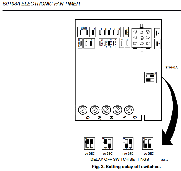

                https://cdn.badcaps-static.com/pdfs/...f57090bce4.pdf
                Look at page 3 of this manual
                You might be able to jump together “G” to “Y” or put 24 volts to “G” and “Y” but look on the board and see if you can do either one but you will not be able to do either one with the thermostat hook up

                  Relay K3 has a high failure rate part on these boards.
                  It's unfortunate furnace control boards have nothing to prevent arcing on relay contacts, and so they don't last long. $0.15 in RC snubber parts would make them last.
                  Leave C6 at 100uF. The fan-off time delay already set (DIP switch settings) to run for as short as possible 60sec. ? after call-for-heat ends. The fan-on delay is fixed at 30 sec. on this board.
                  ST9103A installation manual

                    The furnace works now.
                    I tested G and Y terminals as FAN on switch, K3 worked.
                    I have set the DIP switch at default 150s.

                          For my original post; that board had K3 relay failed. This relay failed so often, it was not even used to drive fan directly, it actually only used for another relay off board, White Rodgers RBM type 184 (lower right corner of picture, the black block with white label).
